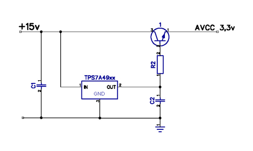

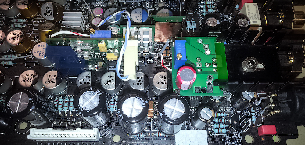

Recently I came back to my HA1, and I finally proceeded to one of my old ideas: replacing the standard (lower) quality regulators for DAC power rails, with a better approach…I used my own regulators based on ADM7151 and LDLN015 top quality components on marked right now (best low noise figures).
Especially for analogue power rails of the DAC chip, I used my PSU design, which it include very large decoupling/filtering capacities,
The results are quite spectacular, is the only I can say.
This modification it demonstrate by itself, the enough low quality of the regulators, Oppo used in their original design of this product.
As I had to take a closer look at the AVCC regulator Oppo have designed, I discovered an even poor conception for the power supply for this very important power rail of the ESS9018 chip. Here you can see how it looks like the original Oppo design of this stage.
In my opinion, there is very strange that Oppo designers decided to use the positive rail of the symmetrical +/- PSU, designated to the analogue signal post DAC processing (+15v), to obtain the AVCC voltage. The same (wrong) concept is to be found in the Oppo`s players too (similar stage). I really cannot figure out what advantage it may have such idea… As I can see, it is only a wrong approach…
The even stranger concept is to use a quite high voltage level PSU to obtain a very low-level (regulated) voltage (+3,3v). There are here 12v, which it only goes on heat dissipation for the serial transistor of this regulator. This is really bead, especially for a quite hot closed environment; the components it have to work in this Class A HA1 device. The heat dissipation on this transistor is just huge and unnecessary.
The another negative aspect of this design is to load even more one of the symmetrical differential PSU rails of the analogue processing stage, increasing its noise and ripple, as the heat dissipation on its serial device. Why they should use a 15v rail to obtain 3,3v it is just a mystery, over that simple fact that is a wrong approach. There is also available a 7-8v DC rail, which is more appropriate to regulate it for 3,3v… This power rail it is used exclusively for the rest of the three power rails of the DAC chip, 3,3v and 1,2v, and it is an appreciable heat dissipation too, when the voltage differences are also here enough high… Well, a not very fortunate choice of the designers, is my opinion…
I have dismissed the original AVCC regulator, and powered all the DAC chip rails from 8v DC, through a pre regulator, which it lower the raw (but very well improved filtering) 8v DC to a regulated 5v. Then the regulated 5v I used to regulated further to the AVCC and VddL/R levels through my own DAC PSU, as through my regulators, to the necessary levels for the rest of the DAC power lines. As I said above, the results are spectacular. However, my biggest surprise it was to measure after many hours use a 32 deg. C (21 deg. C room temperature), for the overall enclosure temperature. The overall heat dissipation it was reduced dramatically only by dismissing this (wrong concept) Oppo`s AVCC regulator…
The Class A area it still have a higher temperature (as normal also), but now is this lowered too, and it is concentrated more for own area, while the general inside temperature it decreased dramatically. The Class A heat sinks area (the upper ventilation window) it measure for my device 45 deg. C, while the enclosure it measure 32 deg. C. Please note that I improved the enclosure`s inside ventilation using an inaudible fan to exhaust the heat in the Class A amp area, as the fresh air access from the back panel side.
