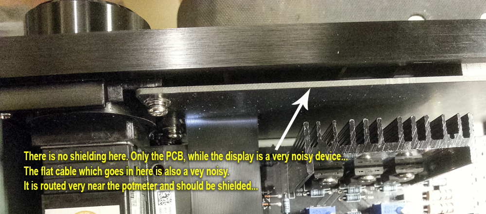

As I have pointed previously, I see the need of some more shielding first of all. There is not easy to reach to the main board, which it host the DAC system. To mod something here, one have to disassemble completely the whole device... Not very comfortable...

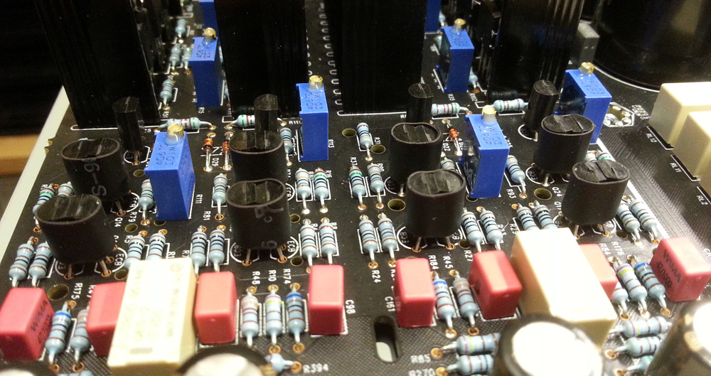

I can see that the components (transistors) involved in Class A amplifier, which have to be thermally compensated, where placed very near each other, as it should be, but are not even more close each other, as it have to be also. Actually these components have to be so near as one and single component (if not a double transistor can be found, especially for this function...).

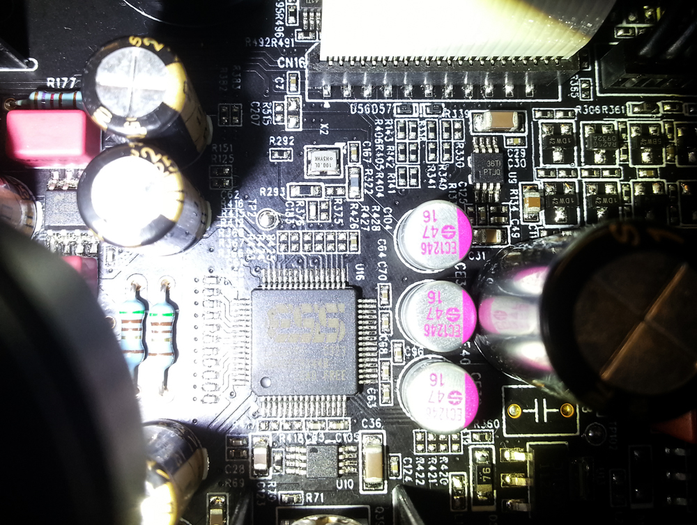

Some words about the main components/opamps used. The I/V & final stages use L4562 for I/V (as we were used with in previous Oppo products). While the final it use a very high quality differential amplifier L49724. Very good figures for this component. Quite satisfied with it so far, but L4562...😕
The power system for clock and DAC AVCC use TPS7A49. Quite good, but not best...
Headphone it seems to use OPA228 chips, while the preamp input stage it use a very good differential opamp, OPA1632.

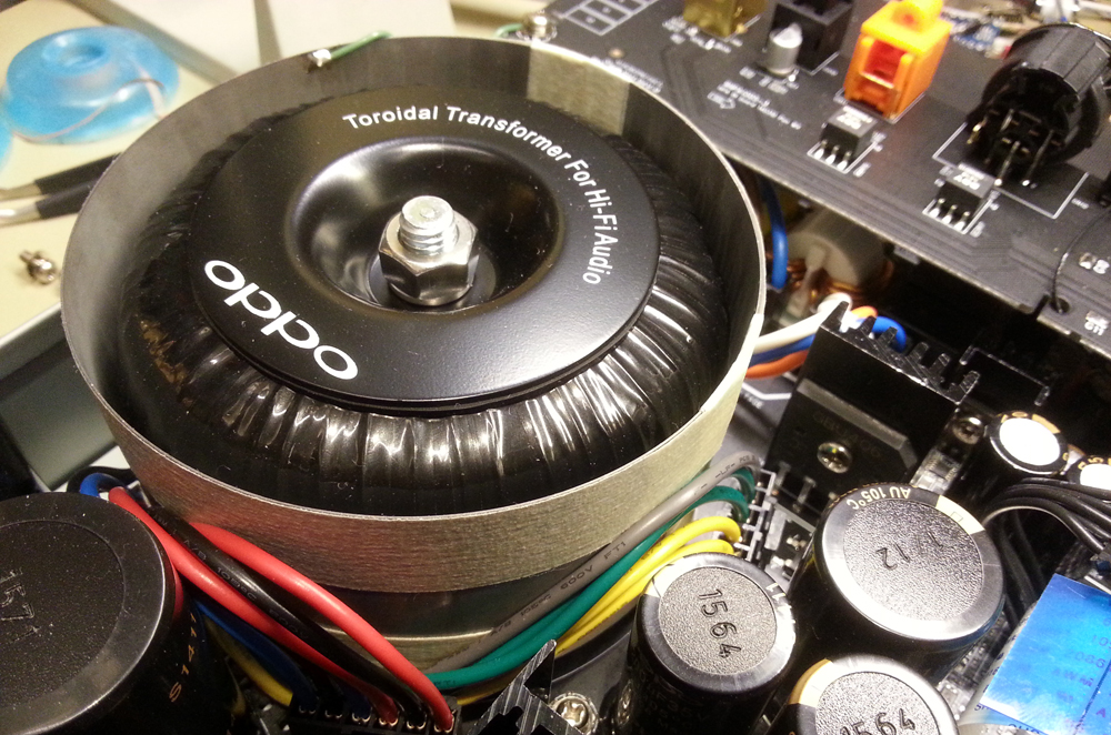

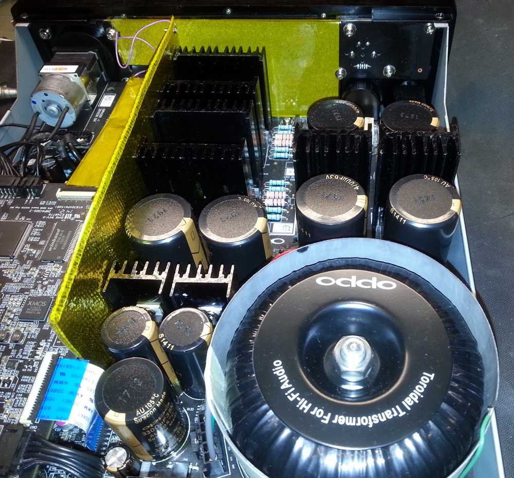

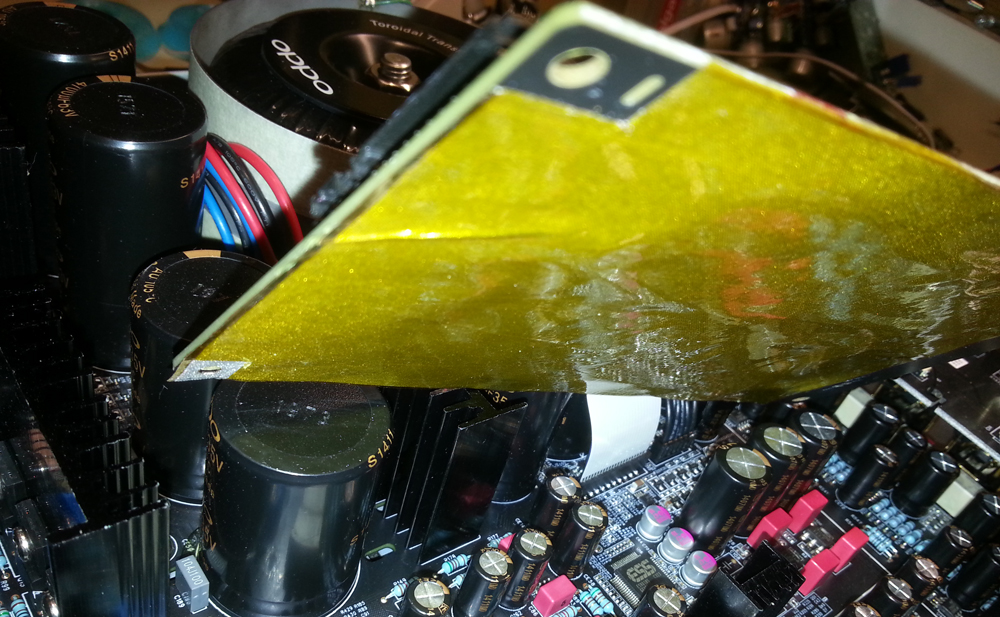

Well, well, some first/initial mods are in place for this Oppo device too...

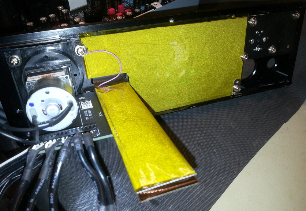

There are some pictures here, and there is a mod mainly about shielding some part of the device.
I used some special EMI shielding material, but other material may be appropriate for this task. As my material is electrical conductive, I cover it with heat resistant isolating foil.
The shielding of the toroid is a dedicated material one, but at least some steel foil is also good.

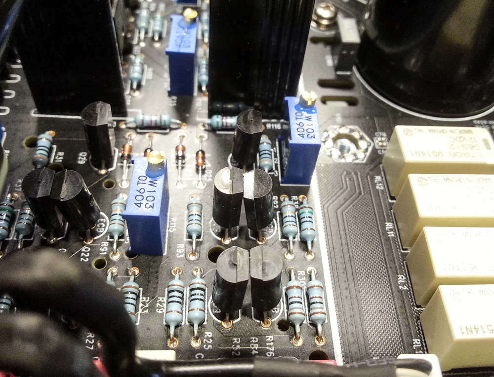

There is also an improvement for the complementary transistors involved in Class A amplifier stage. In the ideal situation, these transistors it have to be together under the the same temperature variation. The best way is to have it both on the same silicium slice (for a price...). Or as it is. but close as possible to each other. I think this pictured here, is the way to do it to get these components in close thermal contact.

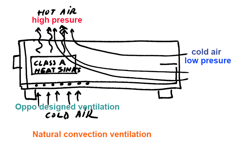

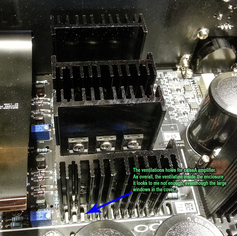

Some words about the ventilation system in Oppo design.
In my opinion, this design is a quite low efficient one, when to remove the high thermal energy which a Class A amplifier develop.

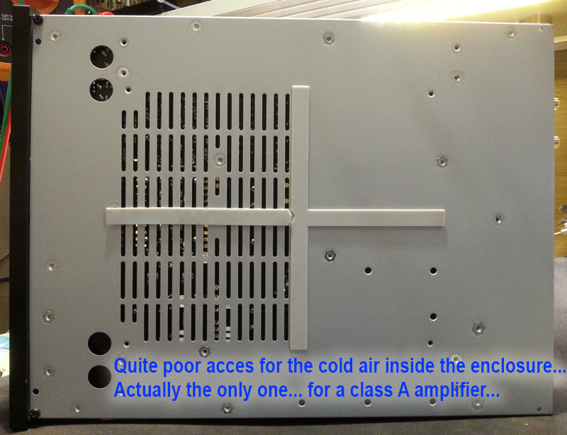

As you can see in original design, there are some holes in a enough small area on the lower side of the enclosure. The holes in the upper base PCB are even less as number and dimensions. The result: poor ventilation and heating up the entire enclosure and its content.
A better solution suggested here to Oppo designers (for the HA-2...) is to let somehow open the back of the enclosure. This enclosure is hopefully very similar to a tube, when the end of it is open. There is a known physical phenomenon which consist in increasing the pressure into a tube (when pressure differences occur at tube`s ends) as the length of the tube increase. The quite high temperature differences create here pressure differences inside this tube (the enclosure). Heaving the back end open or designed for air access, there is a natural created and a very efficient ventilation, when the hot air push up and such the cold air mainly from the best access opening. The quite long tube create an enough pressure to produce an efficient air flow, when the back of the box is open or is air access able. I made a sketch to illustrate the idea. For sure a physician it may describe better what is all about...
The holes in the lower side of the enclosure are usefully to initiate the air flow, when the temperature differences are low, but when the temperature increase, the pressure increase and the cold air will flow inn in high quantity from the back side of the tube/enclosure. The ventilation become then very efficient and natural.
I just removed the back panel of the box, and then the enclosure shown at once different temperature zones. The back side still quite cold, while the upper window, become even more hot. So it have to be when the hot air is efficient evacuated.
The negative side of this mod is no any mechanical support for the connections of the amplifier on its back end. But if this device is integrated in a very stable system, then the back panel can be removed to create a better ventilation inside the enclosure.
A separation between the hot areas and the cold ones inside the box it can improve even more the air flow, and lower the temperature for some important inside components.
So, what it may be the solution to have a mechanical stable system, and a better ventilation? It should be designed a special grill for the back end of the enclosure, instead of the existent back panel. That grill it should sustain well enough the connections back, and it will provide air access for an more efficient ventilation.

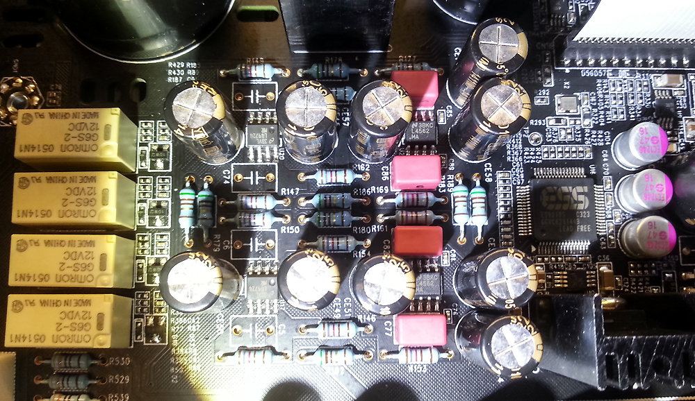

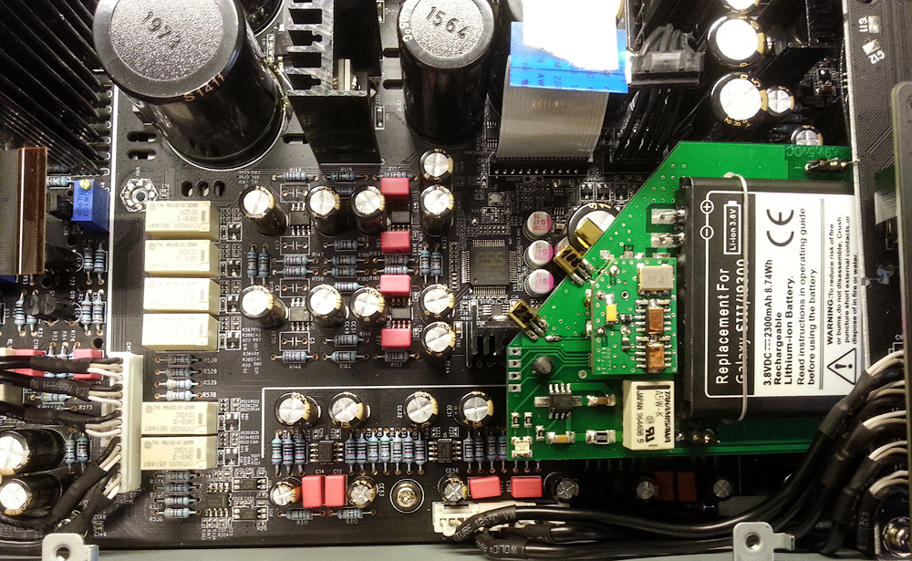

I found out some more about the preamp output stage. I can confirm that it have nothing to do with the Class A for headphone. There are two different output stages. They have in common the same signal in each`s inputs.
The preamp outputs (balanced/unbalanced) are AC coupled. There are 100µ AC isolating caps on both differential and unbalanced outputs. There is used for balanced OPA1632, and for unbalanced L4562.
I have removed the AC coupling for unbalanced out. Direct coupling. Improved the decoupling caps on L4562 power rails, to 3000µ. The offset measured at the direct coupled unbalanced output is 0,8 - 1mV.
This mod opened more the sound out of the device.
Enough unclear the Oppo`s reasons to chose the AC coupling...

Can you confirm how the headphone input is coupled with the DAC output --- is it similarly AC coupled with coupling cap, or servo circuit using opamp --- or DC coupled?
Thanks for sharing your great work and ideas.
Yes, I can... Unfortunately...
The headphone amplifier is AC coupled. !00µ in between its differential pre-amplifier stage (L49724), and the power headphone class A stage.
All these AC separation caps should be at least non polarised type. A chepear solution is to use a pair of polarised caps. No any such approach in Oppo`s products...😕
As it still unknown yet what kind of circuits are used for class A stage, one could not just bypass these caps. Until one find out details (not so probable...), these caps should be there in place. But improvements can however be.
The AC coupling are placed in HA-1 on its (preamp) outputs (balanced/unbalanced), and at input for headphone amp. As I could see so far...

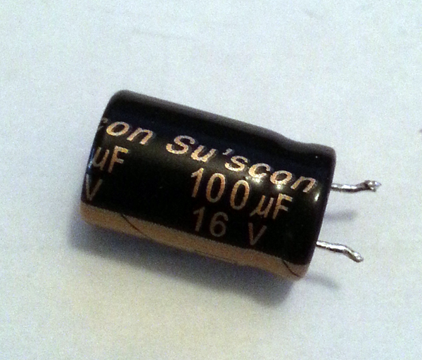

what is the value and make/model of the electrolytic used? Is it at least a black gate or an oppo proprietary type? Maybe bypass at a minimum with a film type? What do you you think? Do you think servo circuits are just too expensive? Somehow they were able to get tremendous bass response regardless.

Thanks jcx, I would like to know what part is used for DC blocking to the headamp -- and ideas to improve on this specifically.
This is the cap type Oppo use as DC blocking in HA-1.
To improve the parameters/sound, one should increase the value of the cap, but not opposite... The higher its value, the better the results. But when is to big the capacity, it can occur some side effects for the stage after this cap. So, a reasonable compromise may leads to a good result. Best results: without (but we do not know exactly how Oppo designed the class A amplifier, and the implications of DC coupling in this place).
At least this cap should be bipolar, as all the DC blocking caps, rated for a higher working tension. This it may be another improvement here. Paralleled with a good quality, small film cap, another one...

You know is quite a pain to mount/unmounted this device, to test so after any small modification. I will do some preliminary mods, then I will test the sound, and try to have some conclusions.
I`m in the working phase for moment...
The HA-1 have some qualities as it is. This is obvious enough. It can provide a sound scene the other Oppo product couldn`t.
Even though, I am not quite satisfied with what i got/get, especially after listening to my modded BDP105.
I found the sound of HA-1 not as open as it should. Do not full out the room (I did not used the headphones yet). The sound it not have the volume I know it should have. This is my opinion.
In HA-1 Oppo use better opamps than in the players. It use also better regulators. But it use the same kind of caps (values), in a similar design as in players... The AC isolation is a way to do it and it may not be just as negative, but one could use large capacities caps for this AC/DC separation. Is just as simple... and it improve the signal quality, and it may not be so expensive...
I saw the headphone traces going on the PCB from one corner of it to another... Very long traces on the board... I`m not very happy with this...
But the worst of all with the design of this device is its physical/mechanical part (ventilation), or the managing with the important heat developed inside the box. This aspect is quite bad.
I just wonder how it was the environment when Oppo did its measurements...
I had the device in function for a while, without its nice enclosure in place. So, just opened in the air. The Class A stage spread it its heat out in the free air. I was very surprised to find out the the DAC area it was just very hot after one-two hours in use in a 26 dg C room temperature (in a hot Norwegian summer time...). I just wonder what it may be the temperature of the DAC area when the enclosure is completely closed as Oppo designed, and the whole heat from Class A heat sinks is spread inside the enclosure... I wonder even more about how long it may last a such device in such functioning conditions...

I have observed something strange about these caps. The 100µ/16v cap used for AC/DC isolation is bigger as dimensions than a 220µ/25v used for filtering in all the device. Almost twice. The dimensions of these components it have to be just opposite. It may be 100µ a special (customized) construction one? It may be a bipolar one? As usually these bipolar caps are bigger than the polarised ones for same capacities... But if so, why they are marked with +/-?
Oppo`s secret components...😉
