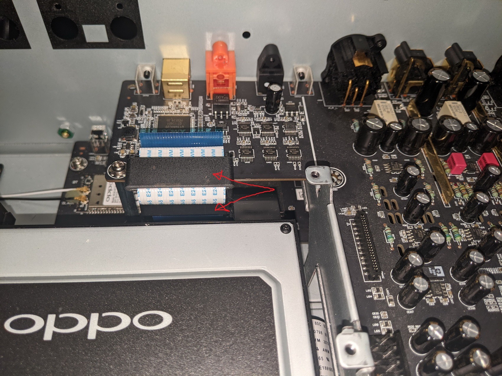

I've been digging my 205 for a week. I've tried almost everything. Nothing not like left everything as it was from the factory. In addition, I disconnected the earth cable, which is from the network cable to the case, pulled out 2 capacitors in the pulsed power supply, which are on the ground of the chassis, replaced the capacitor with 220uf 400v, put two ferrite flat coils on the flat cable between the top board and the bottom in the photo. Because of the coils, the sound has improved a lot (it seemed), and their position on the cable affects the sound.
What do more and less experienced people think - are these coils better or worse for sound? (I'm puzzled)
And in the plans to change the diodes for bipolar power to fast but not shots, to RHRP860.

Hi Moon1,
Please repost this in English as that is the accepted language here.
This is what I got from translation:
Is it accurate?Hello friends! I'm new, I just read the forum today. I dug my 205th week. I have tried almost everything. Did not like anything left everything as it was from the factory. Additionally, I disconnected the ground cable, which was from the network cable to the case, pulled out 2 capacitors in the switching power supply, which were on the ground of the case, replaced the capacitor with 220 microfarads 400v, put two flat ferrite coils on the cable between the top board and the bottom one in the photo. Because of the coils, the sound improved a lot (it seemed), and their position on the cable affects the sound. What do more and less experienced people think - are these coils better or worse in sound? (I'm puzzled) And I plan to change the diodes for bipolar power to fast but not firing ones, to RHRP860. I really need advice on which clock generator to buy and where is the best place?
