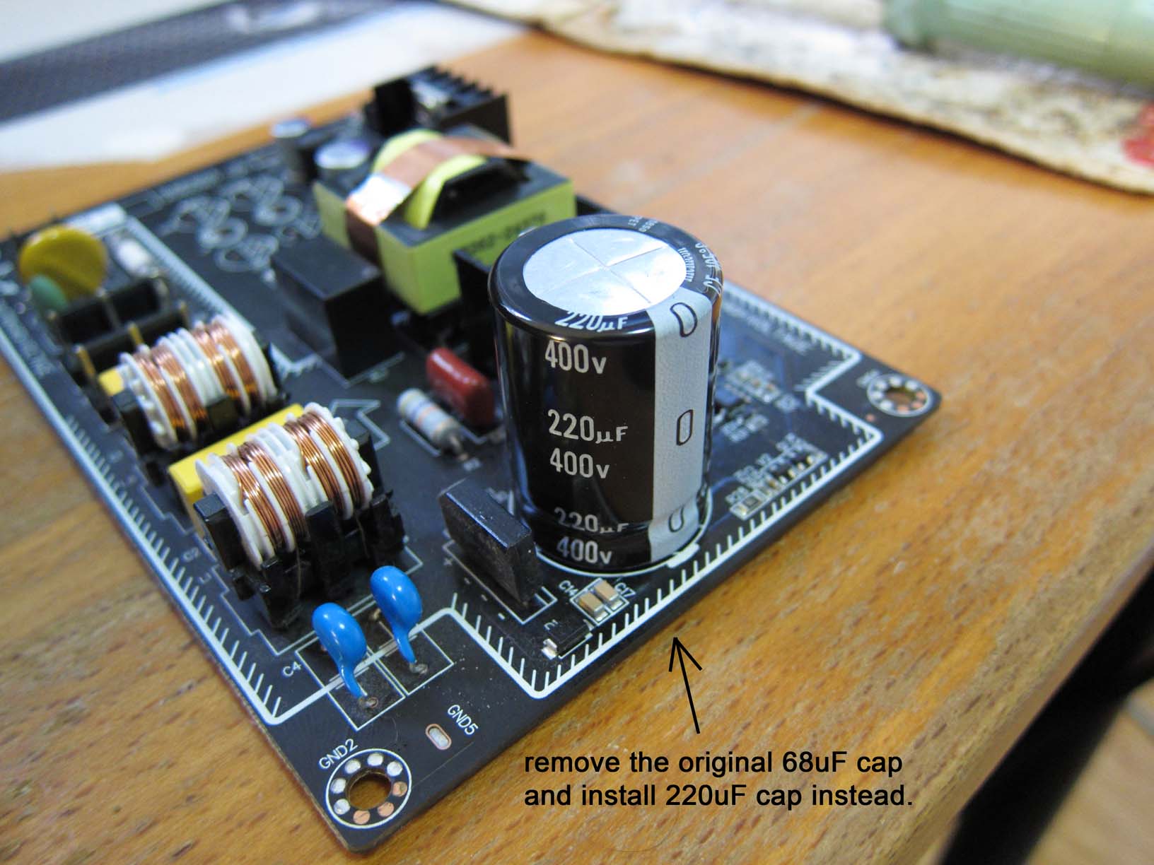

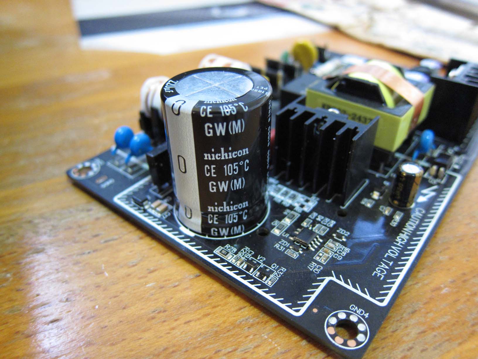

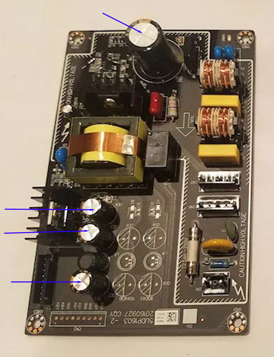

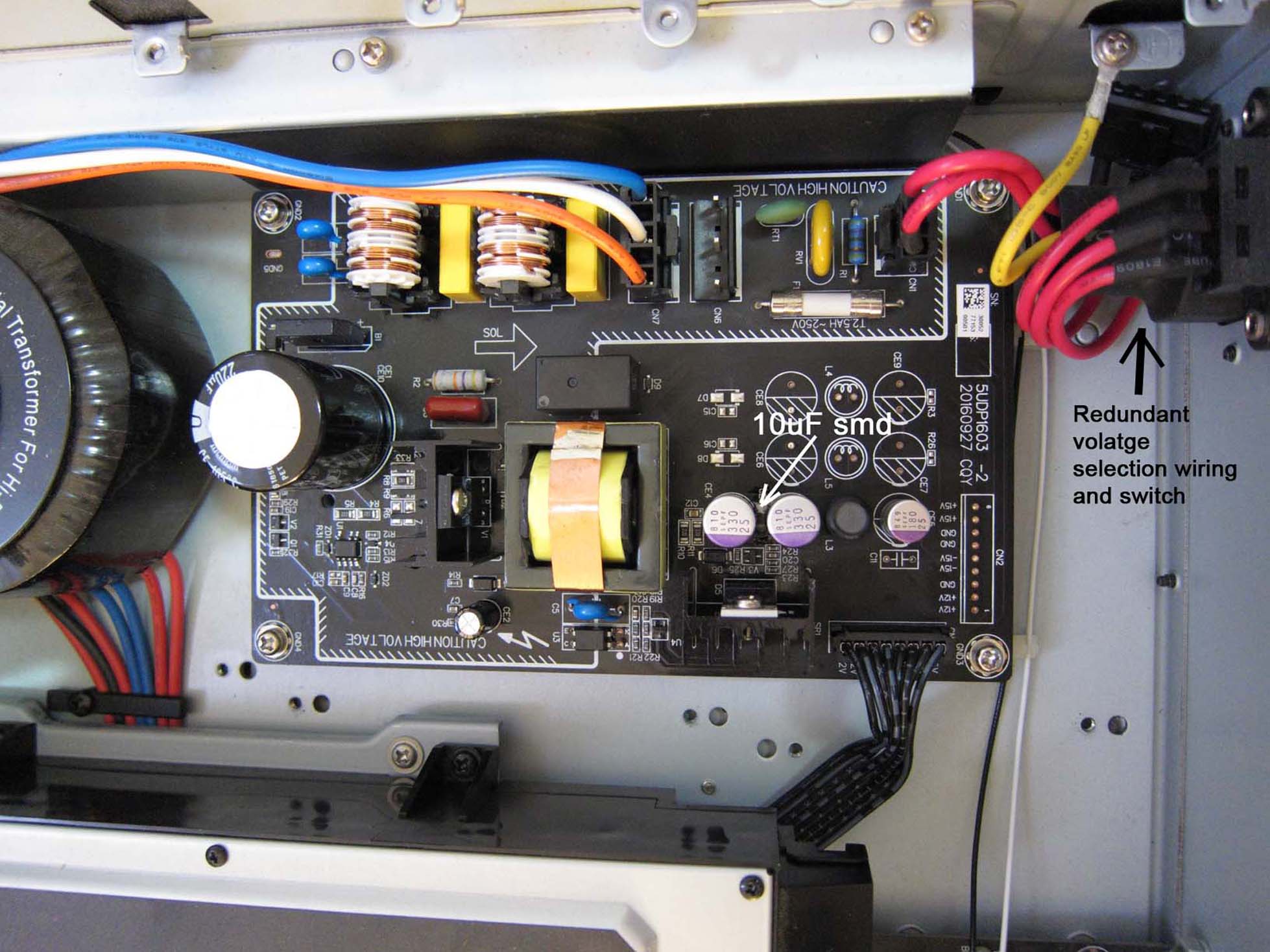

For those who know a bit about electronics, want a decent improvement with 205 player and want to save $450... read on...
The "Original 205 PS.jpg" shows which capacitors should be replaced from the top side. Other photos show where the little SMD capacitors should go, which OSCONs to use, as well as how to bypass the mains voltage selector switch and remove the associated wiring. The end result was excellent. The perceived sound improvement (more pleasing and extended top-range & great bass definition) and the picture improvement (the colour seemed better rendered and more saturated) were great; the measured noise decreased substantially (note: this mod was not just cap replacement - there are a couple of SMD caps used in addition; the 1uF and the 10uF, that made a huge difference)

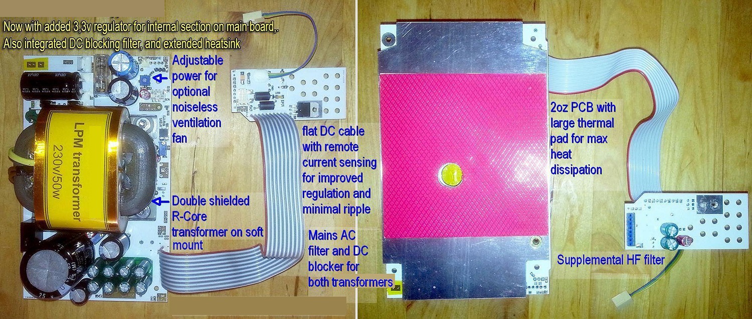

Indeed a partial (cheaper) improvement... Which is far from the quality lift provided by a linear power supply. These caps upgrades on an SMPS it lower somehow the HF noise level, but it will never remove it. The LPS it remove completely that noise, as this is as principe the way the linear power supply is functioning.
The voltage switcher is meant to adapt the AC power input for the toroidal transformer, and it have no function for the SMPS itself.

Here bellow are more details about my LPS... Else, I have already replayed with more details, to your privat message.@Coris I am a new member to this forum based on reviews of your LPS for an OPPO 203. I am very interested in getting more information to order an LPS.
Please let me know what may you mean. Source of components or? All active, passive components and cable, connectors (Hirose) are sourced from Mouser, Farnell. The transformer is custom made according my specifications by a good Chinese manufacturer, then further, each is tested and prepared by myself (transformer is thermal protected). Whole LPS is fully manually assembled and final tested, 50% more loaded than the powered device it require. Else, for more details please PM me.I would like to get information from your source?
