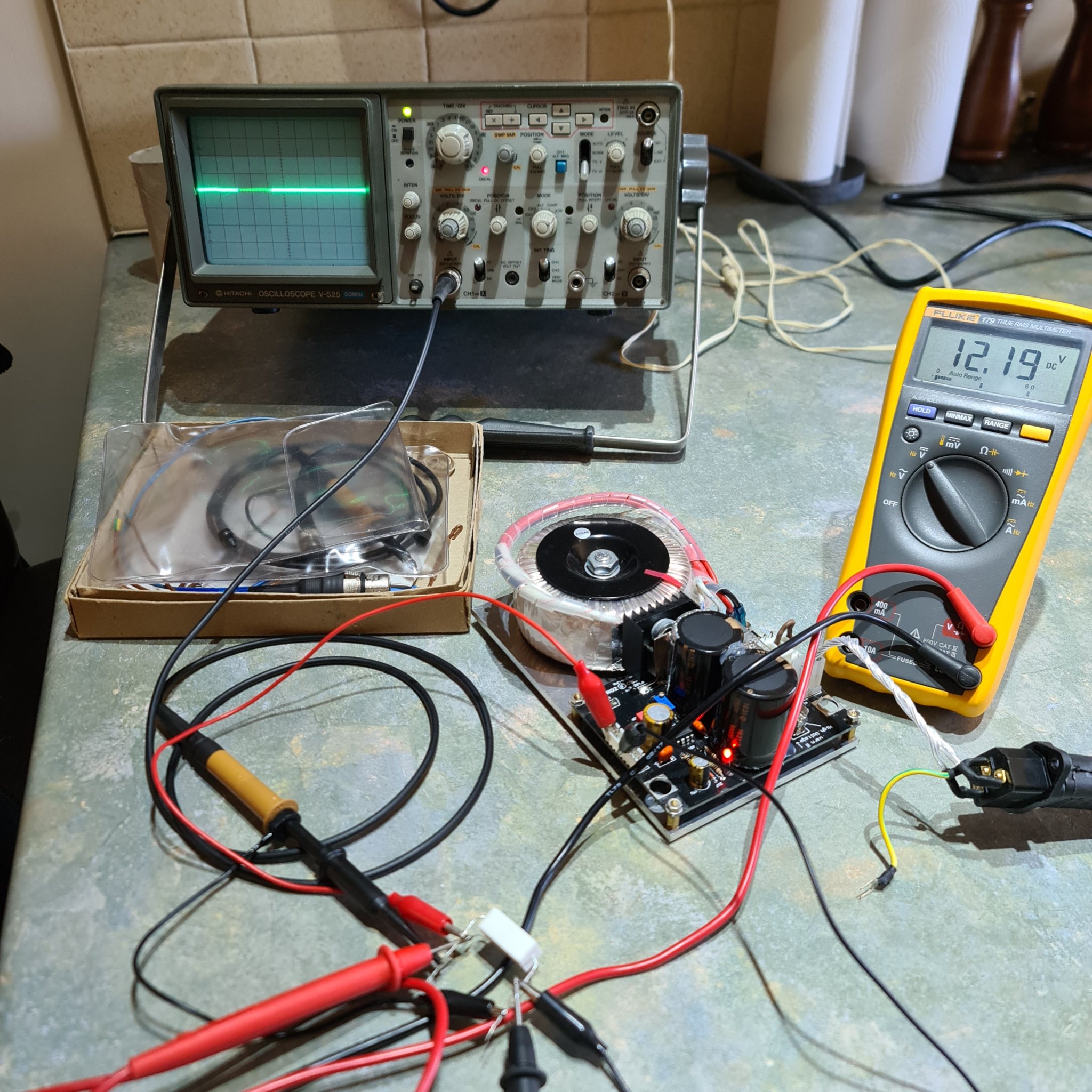

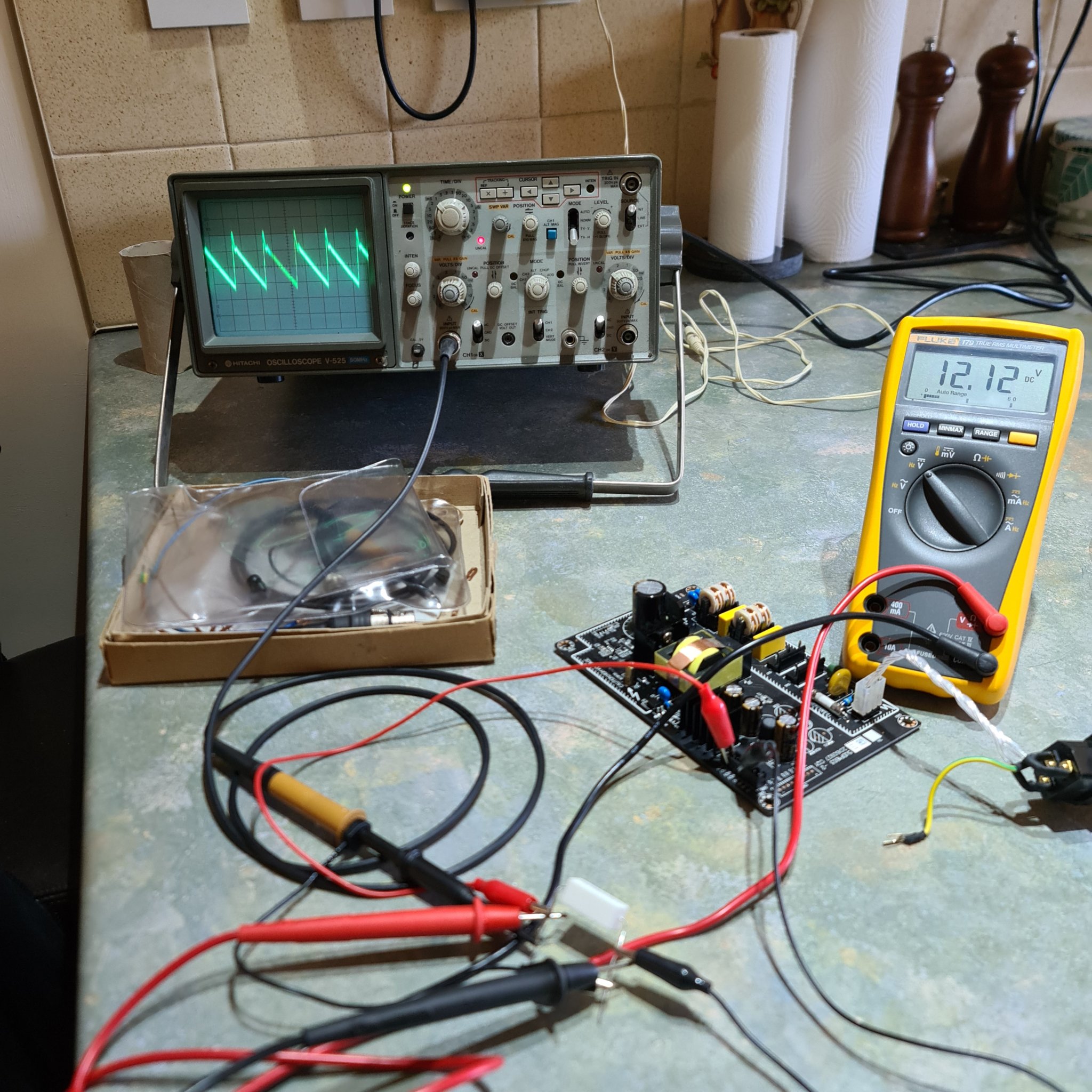

Stock SMPS v "a" LPS
Load: 1KOhm
Scope shows 5mV per division
It is normal...🙂 Well, 1kohm for testing is not just the right load. A reasonable load it should be at least for one Amp current on these power supplies outputs... Anyway, the noise difference between an SMPS and an LPS is quite big.

But have you noticed a definite change in sound in your modes between the SMPS and your LPS? Any measurable differences you've observed as in SINAD or THD+N or jitter, etc... Is the mod still available and if so, how much for US shipping?
Yes, the improvement is significative for both picture and (digital or analogue) sound. The installing of an LPS it actually lower the overall noise level into the powered system. I have as well published previously a comparative of the original SMPS and my LPS. These posts are to be found in my threads (this one too). Well, extended measurements I have not done, as the improvement it is so obvious, that (in my opinion), it not justified the amount of work and time invested in detailed measurements. It should be noted that the LPS mounting is the first and most important step in improving the device performances. Also the clock system upgrade is important and it add an even higher improvement level. Another important upgrade for 103/203 models, it is the cooling of the chassis, which it was not designed so to ensure a lower working temperature for the components inside. Reducing the thermal caused noise, for some key components, it is also important for the video signal higher quality. Particular upgrades for the analogue audio section of 203, it improve even more the quality of the analogue audio outputs.
