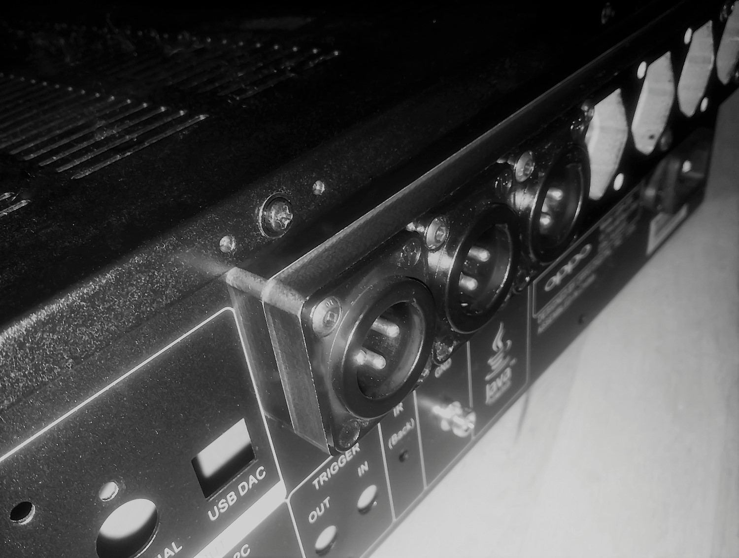

There is no schematic about such upgrade. My approach is mounting my own designed, fully balanced output modules, based on OPA1632 for the all 8 channel on board. I take the differential analog signal directly form the DAC chip outputs, dismissing the whole original post DAC circuitry. Another solution may be taking the balanced signal after the I/V converters on each channel, using parts of the original circuits. However, upgrading this section is not an easy task at all, and it is quite expensive...
A (mechanical) challenge in implementing this upgrade, it is the mounting of the XLR connectors on the rear panel of 205. My solution is shown in the picture hereby.

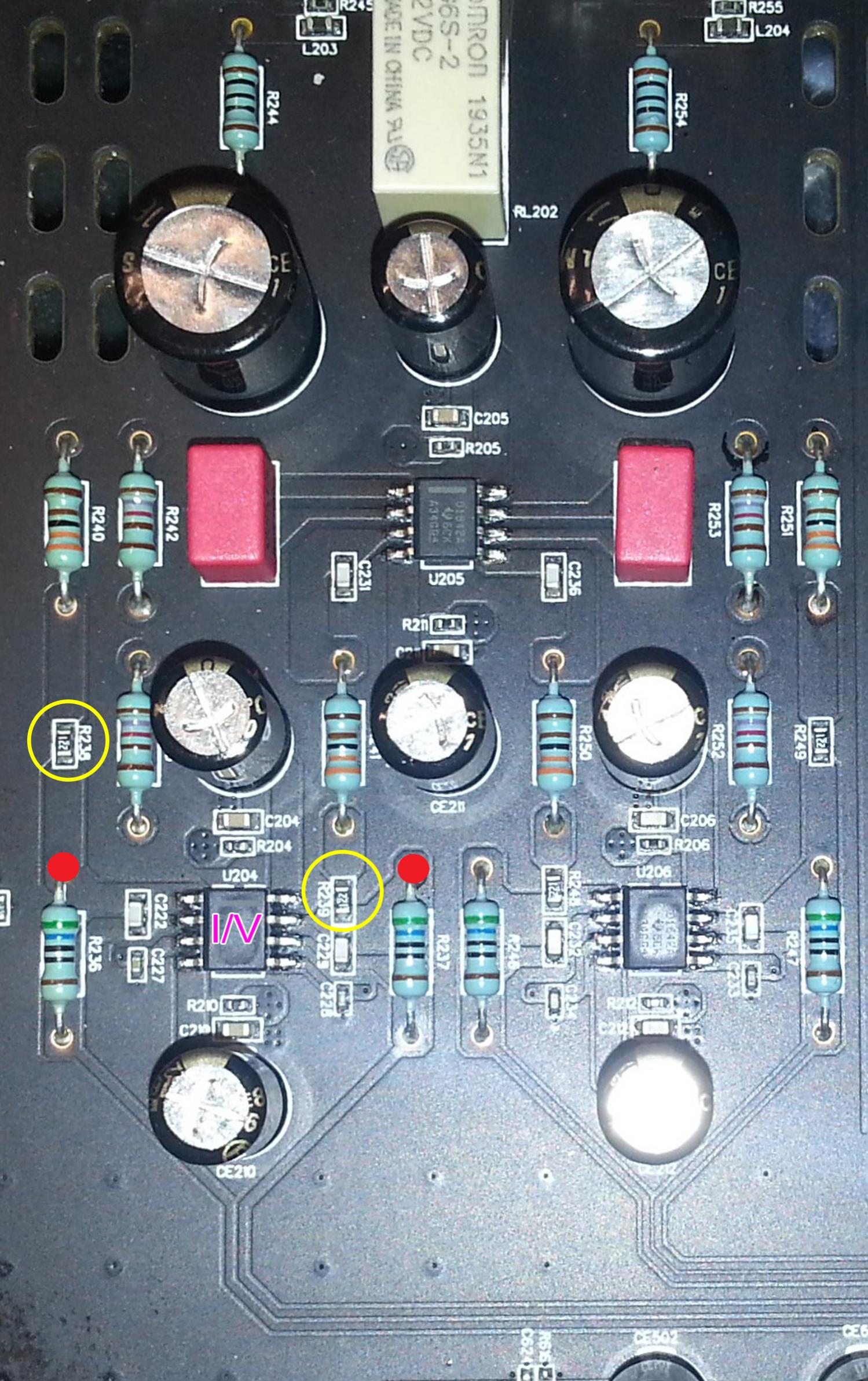

Thnx Coris! Doy you know the points on the pcb to get the balanced signal after the I/V converters? From this point i want to use my balanced buffer pcb to xlr output....
You're the best! So why not just use the red points to directly connect to xlr? (after breaking the circuit at the yellow points) Or am i missing something?
I will experiment! What is a good position to obtain signal ground? Also in relation to the ground pin of the XLR.. Did you remove the RCA connectors?

Yes, I have removed the original RCAs. There is not enough place for XLR connectors if the RCAs still be in place. A good ground for XLR on MCh is just the ground pin of the former RCA.
Concerning the original I/V circuit (isolated as described above), one should know that this is referenced to a virtual ground, which is not zero volt, but somewhere at 1,2v DC. The audio signal outputted by this I/V circuit it will be axed on this virtual ground above one volt DC. So, therefore the I/V outputs it cannot be directly connected to the XLR connectors. As usually and best is an DC offset of almost 0v for the audio signal on an output, meant for further amplification... A buffer after I/V should fix this about high DC offset. Else, AC coupling caps should be used to block the DC voltage..

OK now it makes sense i measured quite a bit of DC after the IV... So i will also ditch the oppo IV section. I dont have the pinout of the 9038 chip so which of the dac out lines is neg and which is pos? I noticed you took these points directly from the bare pcb traces..
Output pins configuration is as follow: DAC1 - pin2; DAC1B - pin3; DAC3B - pin4; DAC3 - pin 5. This configuration is symmetrical (mirrored) for all 8 output pairs pins, on both sides of the chip (all its four corners). Numeration of the "DACx/DACxB" is not important.
