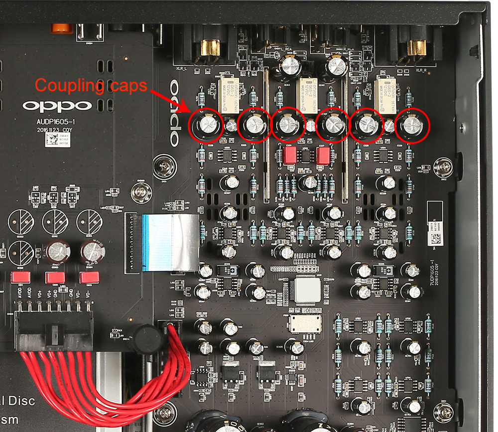

Yes, it are AC coupling caps in the output stage of 205. 100µF polarised.
No, it not need the coupling caps, if your further connected devices it may accept DC coupling. The DC offset it vary from device to device. So you have to ensure it is into 10mV (lowest is best).

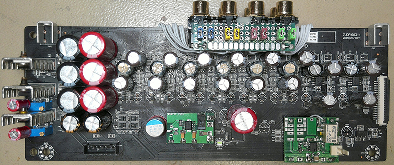

DAC board 203 (RCA analogue outputs)
Some considerations about the analog audio board in 203.
The DAC board in 203 it was meant as a cheap analogue solution for monitoring audio multi-channels. This board it use a cheap DAC chip with voltage output.
The mute circuits are electronic. Because the DAC voltage output, and its virtual ground approach, the DC offset on DAC outputs is 2,5v - 2,9v. The AC coupling for post DAC circuit is a must in this case (Oppo used polarised caps of a relative low capacity). Because the electronic muting solution, there is necessary another AC coupling stage in between the post DAC opamp and the mute circuit. Too many AC coupling stages in signal path, in my opinion... And the transistor mute circuit I do not like it at all.
What about the post DAC circuit itself? Well, here is about a very good design in my opinion. Simple (only one double opamp - NE5532), not the best parameters opamp, making the conversion balanced (DAC output) to unbalanced (RCA) signal output. What is excellent with this post DAC amp stage is its DC offset. In between 0 and 2mV on all channels (better than for 205 and another Oppo models). This excellent DC offset which it allow a full DC coupling for all outputs is also unused, and spoiled by the existence of a electronic mute circuit, which it force the second AC coupling in between...
There is a way to do it right? Well, there is...
My first modification approach was improving the power system on board (the cutting production costs is obvious in this area). Also the power system around the DAC chip is improvable as well. Then doing it right about the post DAC power system and circuits itself. I cut it out the electronic mute stage, and replace it with relays. Well, this is good for audio signals, but not so good for the device power system, as despite my precautions, it still take 100mA from device main DC power. I used the USB power system for these relays, and a 555 circuit to realise the mute at power on sequence. Mute at power on is a must, as the DC offset variation is very big at start up.
Well, some other corrections of the original design for this board, and BINGO! Exceptional analogue audio out, with just amazing dynamics, channel separation, depth and large sound scene for stereo. Not tested yet for multi-channel configuration, but I am sure the result is the same excellent. Another improvement option is adding my fully balanced post DAC module, for stereo XLR outputs. In this case I take the signals directly from AK4458 Front L/R ouputs. XLR connectors are also added on rear panel. The quality for stereo is even higher in such case...
I can only say that this modified board it can deliver the similar quality on the all audio outputs, as an 205 (SabrePro DAC chip inside). Very surprising for a cheap, and medium to low quality meant analogue output. The AK4458 is a very capable DAC chip indeed, when implemented right, and feed it with quality power... Also my LPS it provide the main DC power to the digital system, and audio board as well.

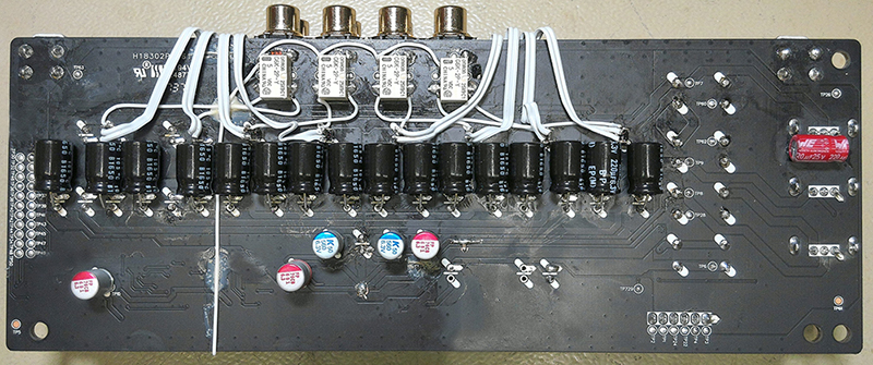

It is pictured hereby my modified audio board of 203 (both sides). The AC coupling is present on board (and improved) on all outputs, but I added a switching option (AC/DC coupling) for a more convenient choosing of the preferred approach by the user, to fit best the further connected gear. Best quality is off course on DC coupling.

Referring to the above post.
I have in the end, replaced the original NE5532 opamps with OPA1612 (only for stereo channels so far). Even better analogue sound out of an 203...
The transistor mute circuits it have not a perceptible impact over the quality of outputted audio signal, but for taking benefit (DC coupling) of the excellent DC offset of the buffer stage, one should replace it with mute relays. I think it is a little bit stupid using AC coupling on an output with an DC offset not exceeding 1mV...
