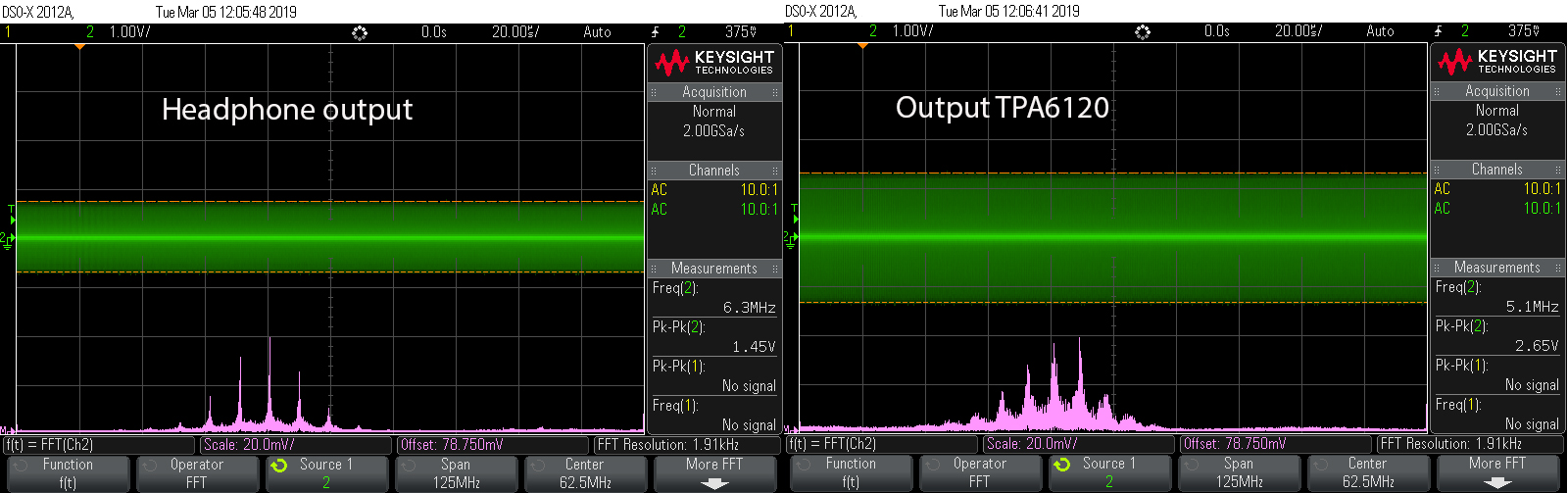

Just for your information. This is how it looks like on scope, the original headphone stage on 205 (no audio signal)...

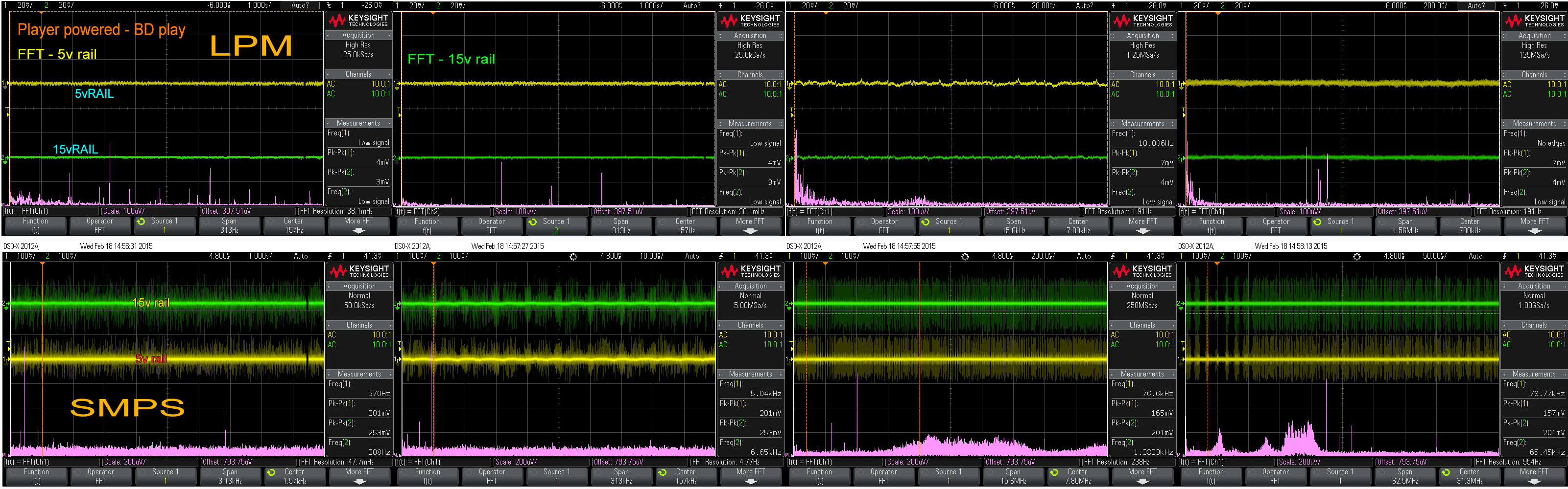

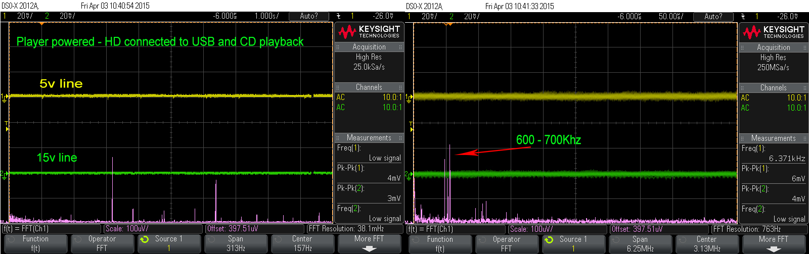

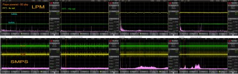

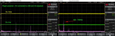

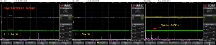

Here are some older graphs, comparing my LPS with original SMPS. The LPS it was improved since...
Please note that the LPS connected to the boards, it become more noisy. This is normal, and is caused by the very noisy digital stages, which it have impact over an "silent" LPS. However, the overall amount of noise in the system is much lower when the digital system is powered by a LPS.
To obtain a higher resolution for the graphs, it is better download it first.

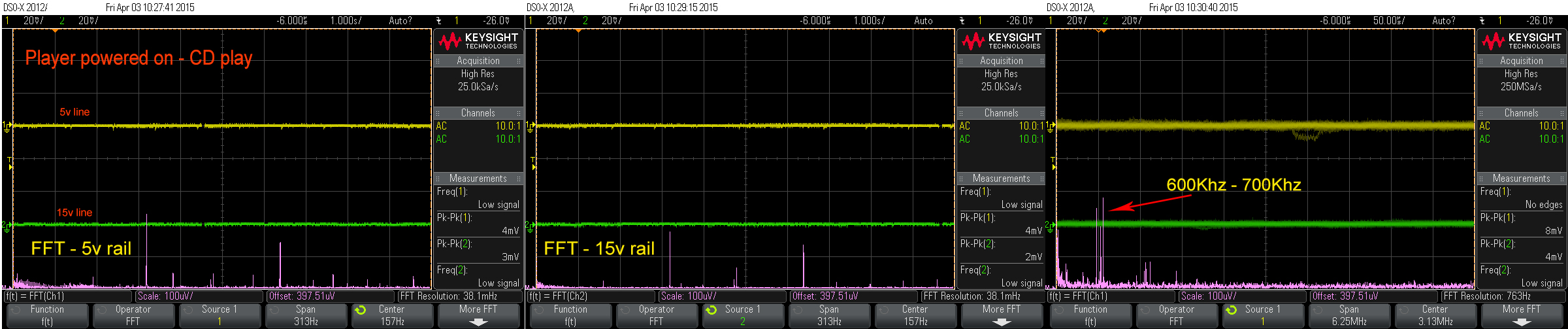

What exactly are we looking at here? It's not good to present data to the public without context.
The graphs in the above post, are taken at the original headphone output of an 205, and at the TPA6120 outputs. TPA 6120 is used as the main chip for headphone stage on 105/205 (balanced to low impedance unbalanced converter).
As I mentioned before, and repeated in post 642, the headphone section of 205 it oscillate in Mhz range. These oscillations are not possible to impact the headphones connected to that output, and cannot be heard as well. In my opinion, it is not fortunate at all heving a such (enough large spectre) Mhz oscillator inside a audio/video device.
TPA6120 is well known as unstable if the PCB design is not carefully done. The design of the headphone section in 205, in conjunction with the attachement of a low impedance buffer after TPA6120, it make the whole circuit unstable, oscillating as pictured in my above post.
Oppo took some measures to minimise the level of the oscillations at the headphone connector, and this is to be seen in my graphs as well. The level of the oscillations is lower right on output.
However, the right measure here it should be remaking the PCB or circuit design so to not have these oscillations at all... Anyway, now the 205 it is not produced anymore, so nothing to be corrected by Oppo...
Thank you, Coris. So are these are open circuit oscillations or are they under some typical headphone load (32ohm - 600ohm)?
Well, I measured it without a headphone connected. The most frequent situation is the use of the player without a headphone connected. So, while one use the device for its line outputs, the Mhz range oscillations are present. I think this is the main problem.
However, I will measure again with a load connected (when I will get the next stock 205).
I use the same TPA6120 in my output module, and I am not heaving such oscillations, no matter with/without load... I appreciate TPA6120 as a very good device.

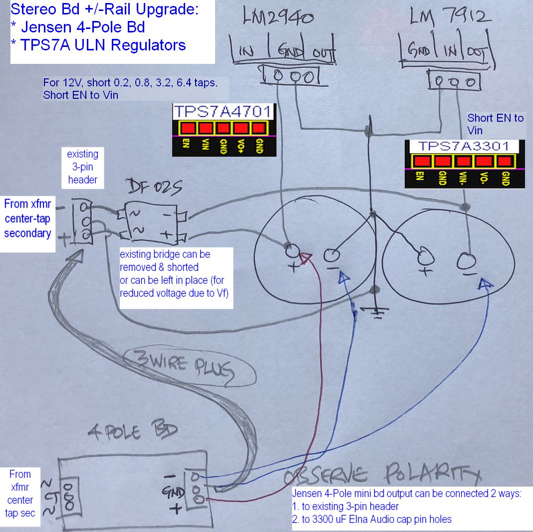

Last night I changed the two regulators on the audio board to the newclassD uwb II regulator and I lost the audio for all outputs..Coaxial, hdmi and RCA.
Wonder what I have done wrong that causes it.
Hi Mok
Based on you PM, I think you have the regulators reversed. +ve reg LM2940 is near center of unit and -ve reg LM7912 is near the edge.
Here is schematic of physical layout, showing TPS7A regulator pinouts as well.
Ignore the bottom part which refer to a "4 pole bd"
Denis

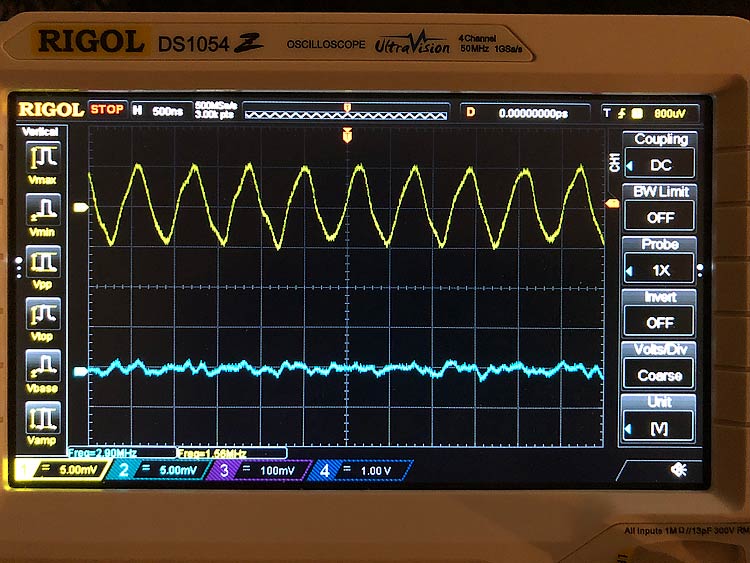

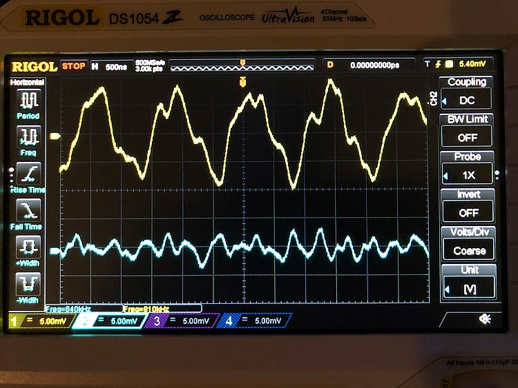

I just discovered this forum last night, and read most of the articles in this thread. It seems that the objective for many of the mods is to reduce HF noise sources. My UDP-205 is unmodified, and I am wondering if the noise that I observe on the analog outputs is typical. See the attached scope pics.
The first one shows the dedicated analog stereo outputs (RCA sockets, unbalanced), with USB DAC input selected, but no input signal. Left stereo channel (yellow) has 10mv p-p with fundamental frequency about 1.5MHz. Right channel is considerably quieter. The RCA sockets for FL and the other multi-channel outputs look similar to the right channel (blue) in this scope pic. Why is the dedicated left channel output so noisy, and others much cleaner?
If I select Blu-ray as input, the noise on the dedicated stereo outputs is worse. Left channel has 20 mV p-p at 810kHz. See the second pic.

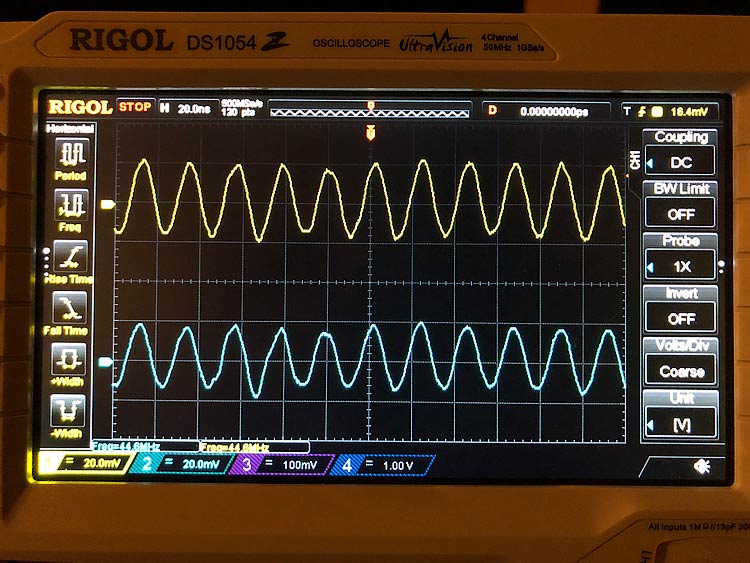

With USB DAC input selected, the headphone jack has 30mV p-p at 45MHz in both channels. See the third pic.
Is this normal for the UDP-205? I reported my results to Oppo's service center, with copies of the pics. They want me to send the unit in for repair. Perhaps there is something that they can fix (faulty shielding or decoupling caps, etc.). But if they find that the unit is working normally, within their specs, then sending it in is a waste of time.

just a few observations...
1. Any reason why you are not loading the RCA outputs / headphone output when taking the readings?
2. If you feed a digital 0 to a digital source, the noise should drop dramatically.

Thanks for the reply.
I did test the outputs with and without loads. The stereo RCA outputs are normally cabled directly to the inputs of an Aragon 4004 Mk II power amp. I looked at the headphone outputs with three different loads: 120 ohm resistors, connected to the power amp, and connected only to the scope. The loadings don't substantially change the HF garbage that I reported in the previous post.
There was a problem with the jack-to-RCA adaptor that I used for testing the headphone port. After fixing that, I measured an even larger oscillation in both headphone channels: 150mV p-p at 45 MHz, and amplitude modulated at about 600kHz.
I am not disappointed by this UDP-205. The sound quality is pretty damn fine, and I am listening through very revealing full-range electrostatic speakers (Acoustat 3). If I had to name a flaw, I might wish for a slight improvement in the depth of the stereo imaging. I don't know if a fix for the HF garbage would improve that, or any other aspect of SQ.
