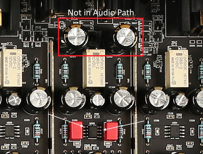

DC Coupling
The DC offset on stereo output (as multi-channels as well) it may be under 10mV. As usual, it actually vary in between +/-5mV.
Hey Coris
For DC coupling, I should just short the output coupling ELNA 100uF, right?
Looks like there is a R100 (on either side of the output relay) in series with the coupling caps. It's safe to reduce this to say 10R, right?
Denis
Great, less than 10mv and I can bypass the caps !
With this info, I opened my unit and measured directly on the OpAmp outputs (pins 1 & 7).
I had -1.1mv & +.9mv (just looking at stereo unbalanced).
I sorted out the 2 caps and still measured the same on the unbalanced RCA jacks after re-assembling the unit.
The guy who posts here and runs the Oppo Mod site should take note that the two larger 1000uF, 10v caps have nothing to do with the audio path.
Those caps are in parallel with the (-) connected to Analog Gnd and the (+) connected to chassis.
On the OppoMod site he shows replacing these 2 caps with Oscon/Wima caps.
I just may be lucky that the DC offset of the LM4562 is very good on my unit ?
I have not had a chance to check if this made any improvement to the sound...

Hey Coris
Denis
Hi Denis
Yes, right. Just short the 100µ (AC coupling) caps. Yes, is much better reducing the 100R to 10 -20R.
Something else in this area: examine carefully the components right before the XLR/RCA connectors. You will see some diodes (signal path to ground). I am not very clear about the reasons the designers had when implementing these components. It may be a kind of ESD protection. The diodes are not just standard diodes, but a special kind of. I couldn`t note any sound differences with/without these diodes. Once (mechanically) removed, it cannot be replaced. Try it or not... A ferrite bead is also placed serial into the signal path. Best removing it.
There is also a 100k resistor (signal path to GND) just before mute relay contacts. Better removing it.
Todd
Yes, is very right about the two 1000µ caps you mentioned. I have also pointed out in my following post at that time, about the wrong information OppoMod have issued (the replacement of the mentioned caps). These caps should not be touched. Let it there as it are. It have indeed, nothing to do with the audio signals, but it are part of a power management circuit, and is very wrong replacing it, especially if (with) different values.

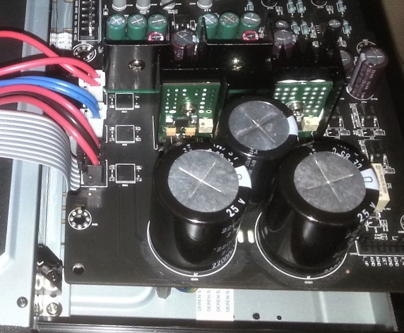

My new regulators for +/-12v rails on 105/205 (based on TPS7A)...
Please note that the bridges (all Schottky diodes) are installed as well, but on the board downside.
Hi Denis
You see in my picture in the background, another two regulators. These are pre regulators for DAC power rails. The cap to be seen in the middle (foreground) is the rectifier bridge filtering cap, for one of the two pre regulators.
When about the sound improvements, after using these much better regulators (TPS) than the 317/337 family, I can say that is not very noticeable. This is because there are lot of other improvements after these first stage regulators. I use also ultra low noise regulators in my output module. So the quality of the power system is already very good. The improvements for outputted sound may be more obvious, if only this modification is done on an original board. These +/- 12v regulators are the only (main) ones on original board (except the ones dedicated to the DAC chip). The impact of this mod is bigger in such case.
However, it is only beneficial heaving better quality components in this analogue power system of the device.
