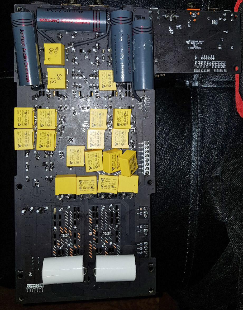

Good evening Coris,Best of all in this field is to just bypass the AC coupling caps with a wire, and use the outputs in DC coupling. As usual it should be there an few mV DC offset, which it should be tolerated by most amp/preamps. At least this is the easiest and cheapest solution. If your preamp/amp it may have coupling caps on its inputs (as most do), then is no reason having a redundant AC coupling into the signal path. A measurement of the DC offset, it should be necessary to confirm the low offset. Measure the DC level before the existing 100µ caps.
If AC coupling should be chosen, then any bigger capacity non polarised caps it should be better than the original ones (bypassed with film caps, of course).
Accordingly by the book and calculation, these AC coupling caps for the frequency range of a audio signal, an 10µ value, or so it should be enough. In fact, as bigger the coupling cap value, as better the sound quality in the low end of the spectre. This is hearable. Not all the time the results of (by the book) calculations it fit with the human perception...
Tuttavia, nel tuo caso, se si può avere un accoppiamento DC nella vostra catena, quindi è la soluzione migliore (senza tappi). [/CITAZIONE]
However, in your case, if you can have a DC coupling in your chain, then is the best solution (without any caps).

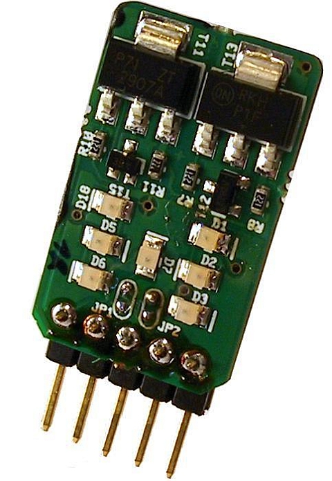

I think a more straightforward solution for 205 is the ones by Sparkos Labs:
Discrete Voltage Regulators - SparkoS Labs Inc.
Amazing spec. on paper - I have ordered a pair - will update....

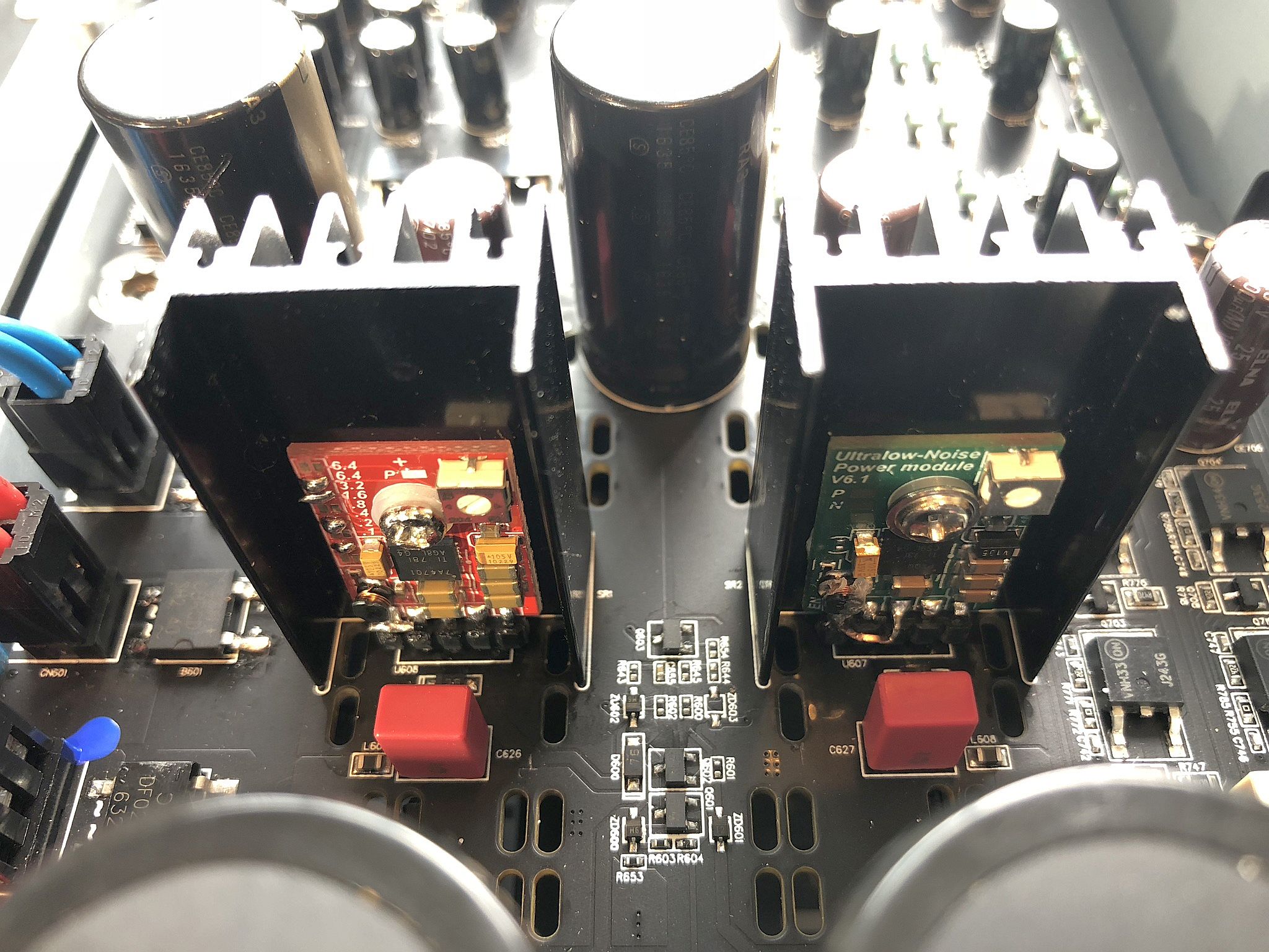

+/-12V Regulators
You are replacing LM2940/LM7912 regulators which are rated for 1A. The actual load on this rail is likely >0.5A on the +ve rail due to the relays. I would use a 1A rated regulator.
The Sparkoslab discrete regulators are nice, but expensive. Their claims of superior performance is against regular regulators, and they were probably designed quite a few years ago. There are many such discrete designs which are no longer as compelling because nowadays you can find Ultralow noise, ultra high PSRR monolithic regulators for very attractive price.
For 1A, the TPS7A4701/TPS7A3301 are amazing - with noise as low as 4uVrms and PSRR as good as 82dB. These are available finished in a TO-220 format for a direct physical replacement of the stock regulators and allow you to use the stock heatsink. If you need 0.5A or less, you would look at the LT3045 with even lower noise (0.8uVrms).

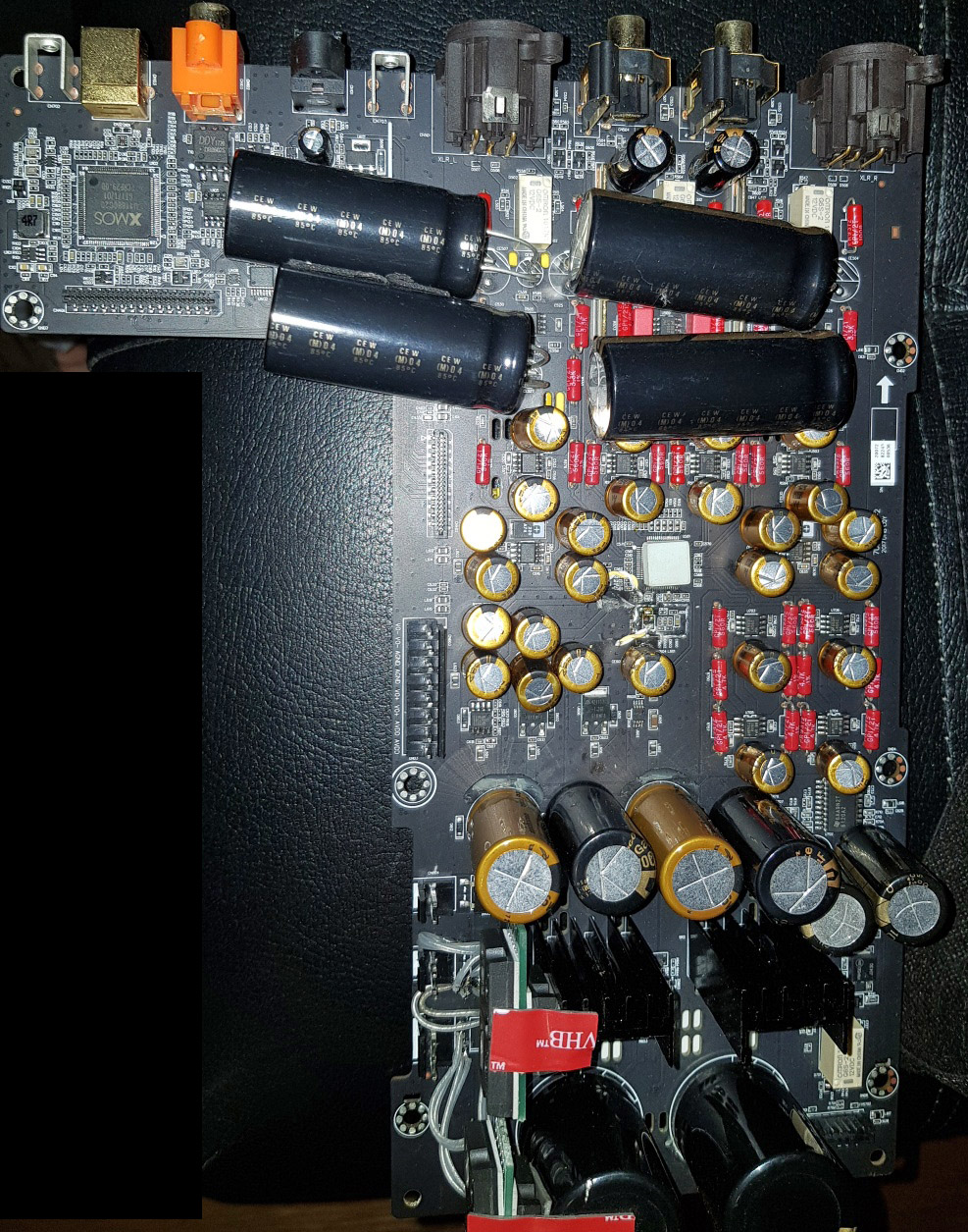

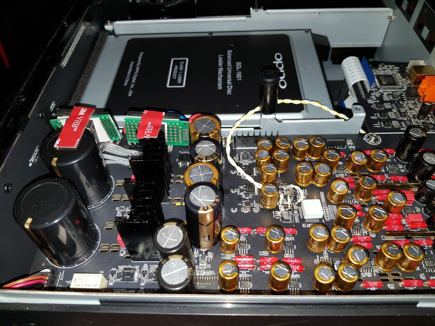

Halo,
I have finished my 205 Mods. Analog board caps+resistor are all replaced (audionote kaisei and PRP resistor) + low noise dexa + scotty. I replaced blackgate output caps 100uf to 2.7uf film and it sounds more natural, no problem whatsoever even thought it is much smaller value. Then I bypass with cheap yellow $0.2 X2 0.48uf caps with low esr (100-140Mohm)
Other mods are LPM, new main clock and 100mhz analog clock, neutrik outputs, furutech NCF outlet with neotech solid copper.
It transforms vanilla 205 (sounds crap) into something special, no comparison before and after. I think I have enough.
