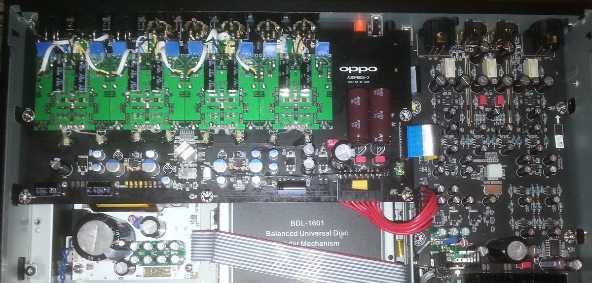

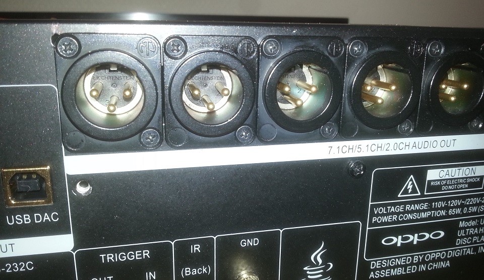

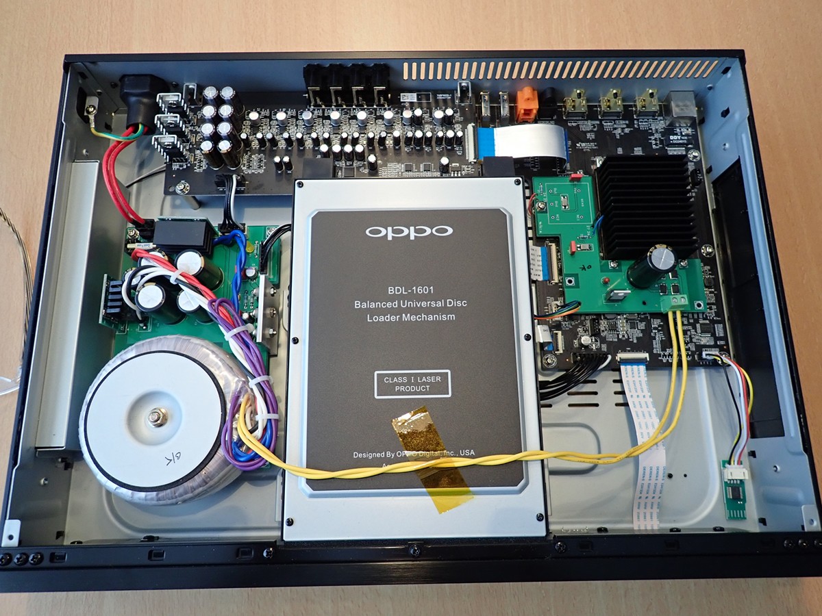

Multi-channel XLR - 205
Fully improved (all balanced outputs) multi-channel stage (205). Quite demanding project...

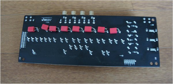

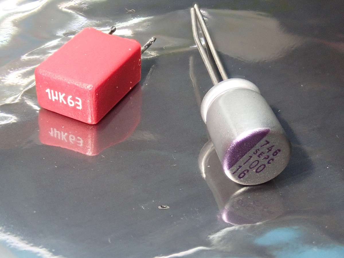

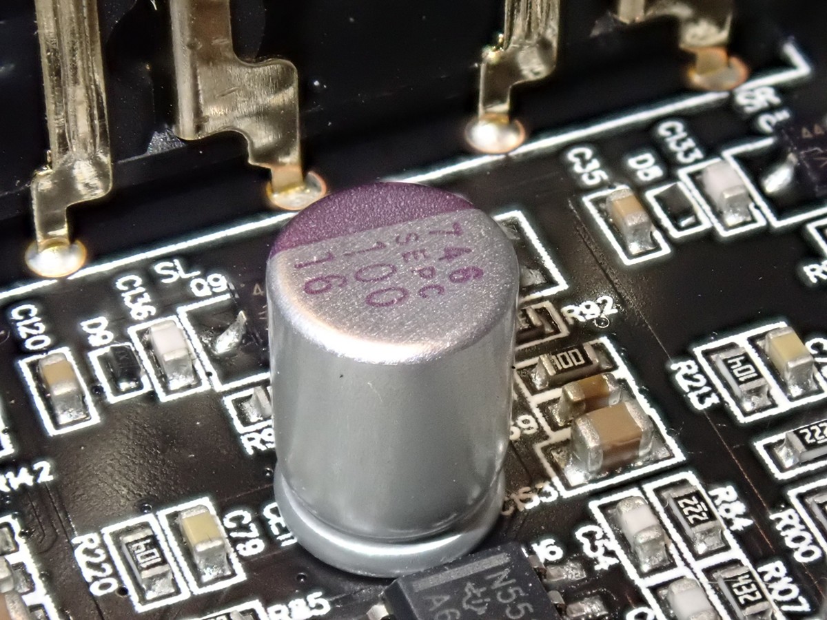

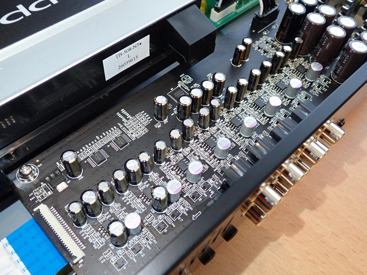

UDP-203 DAC coupling capacitor upgrade.
A simple, relatively cheap and non experimental upgrade.
Just replace the electrolytic stock coupling capacitor from the DAC board with a Panasonic OSCON and in parallel a Wima film capacitor. And do this for each of the eight channels.
Did not expect much because it is just a basic modification, but the results of the "blind men's test" were quite a positive surprise.
I wonder how this Mod sounds on a virgin UDP-203, without a LPM and upgraded clocks.
(Photo bottom DAC board with the Wima's I borrowed from Jae Hong Lee. Did not want to take the DAC board out again for photo, the connectors are not that great and I don't want to break them)

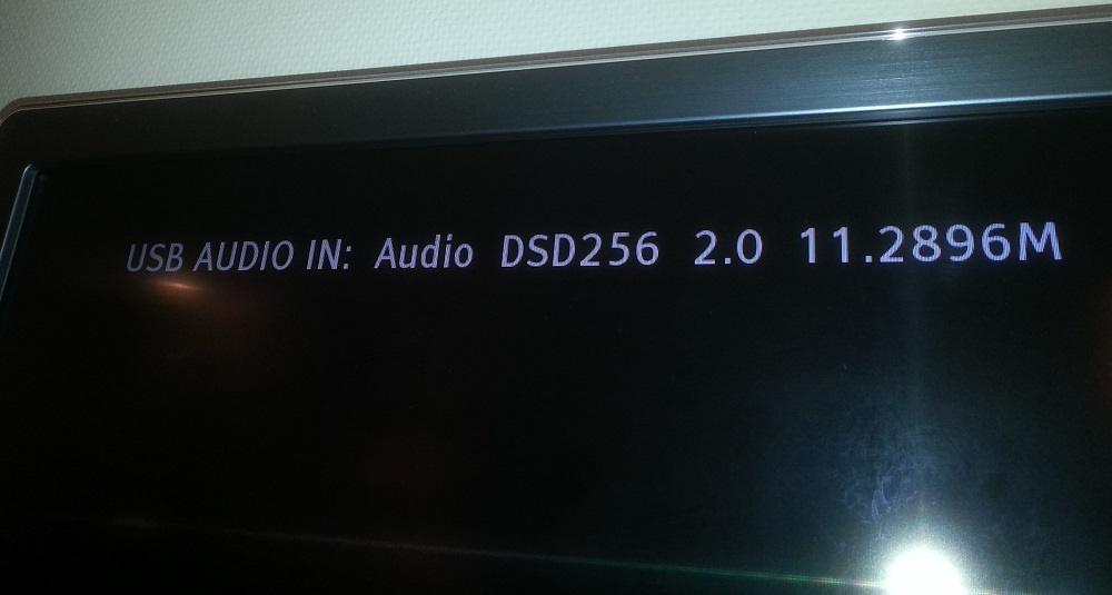

Latest firmware...
USB in on 205 it allow now DSD 256, as MQA. I use Foobar and its plugins on computer, for upsampling. Everything it can be outputted to DSD 256...
Quite impressing result (especially on a improved device) :)
