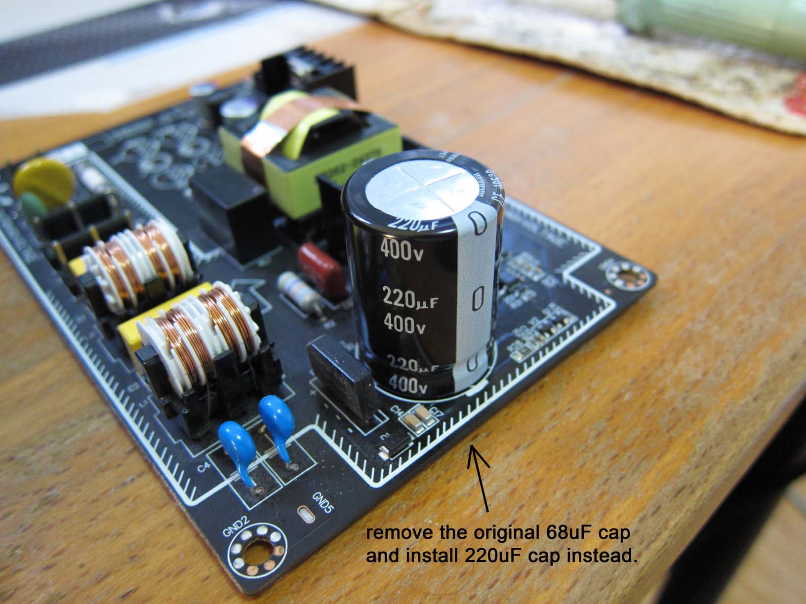

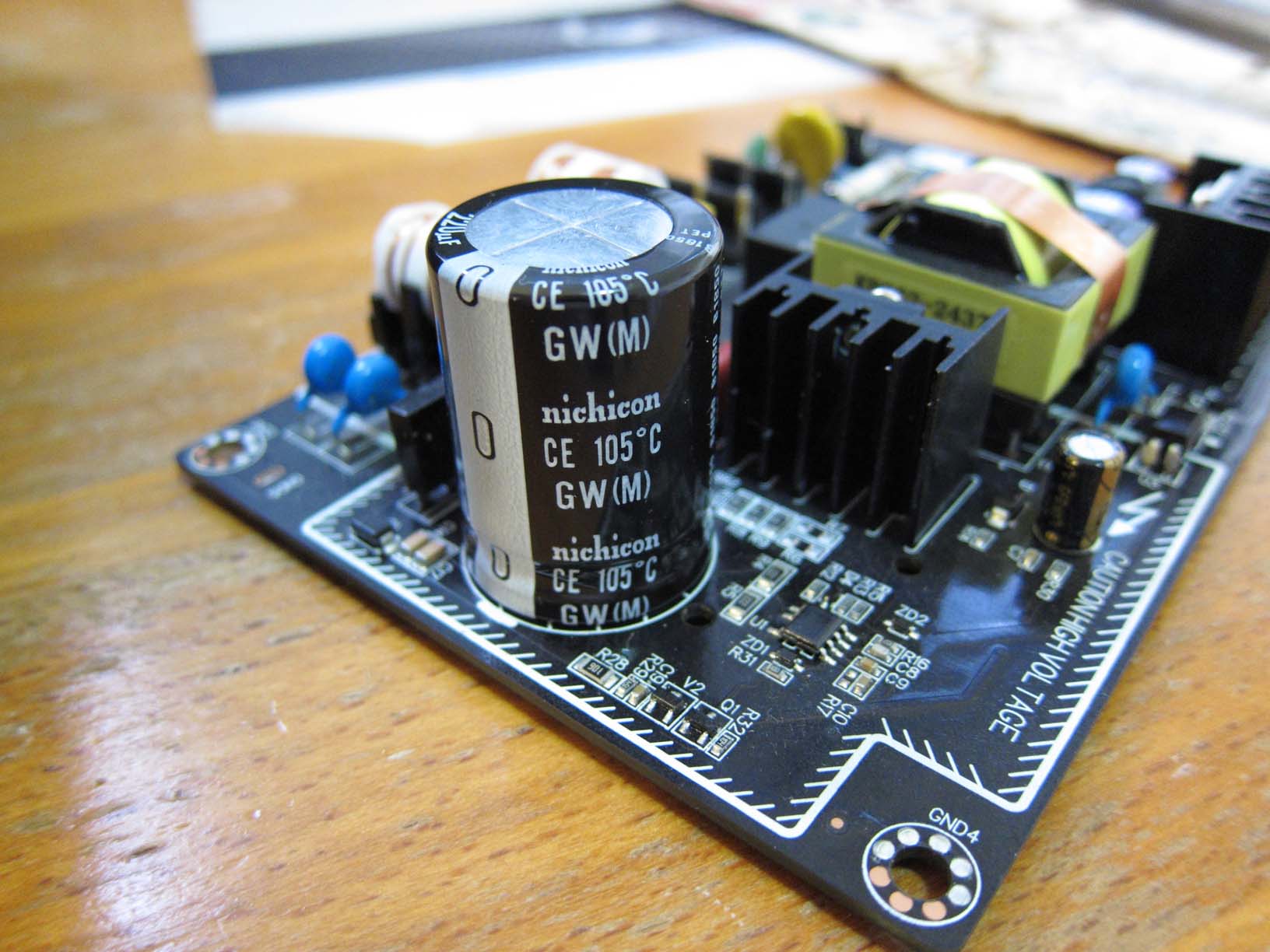

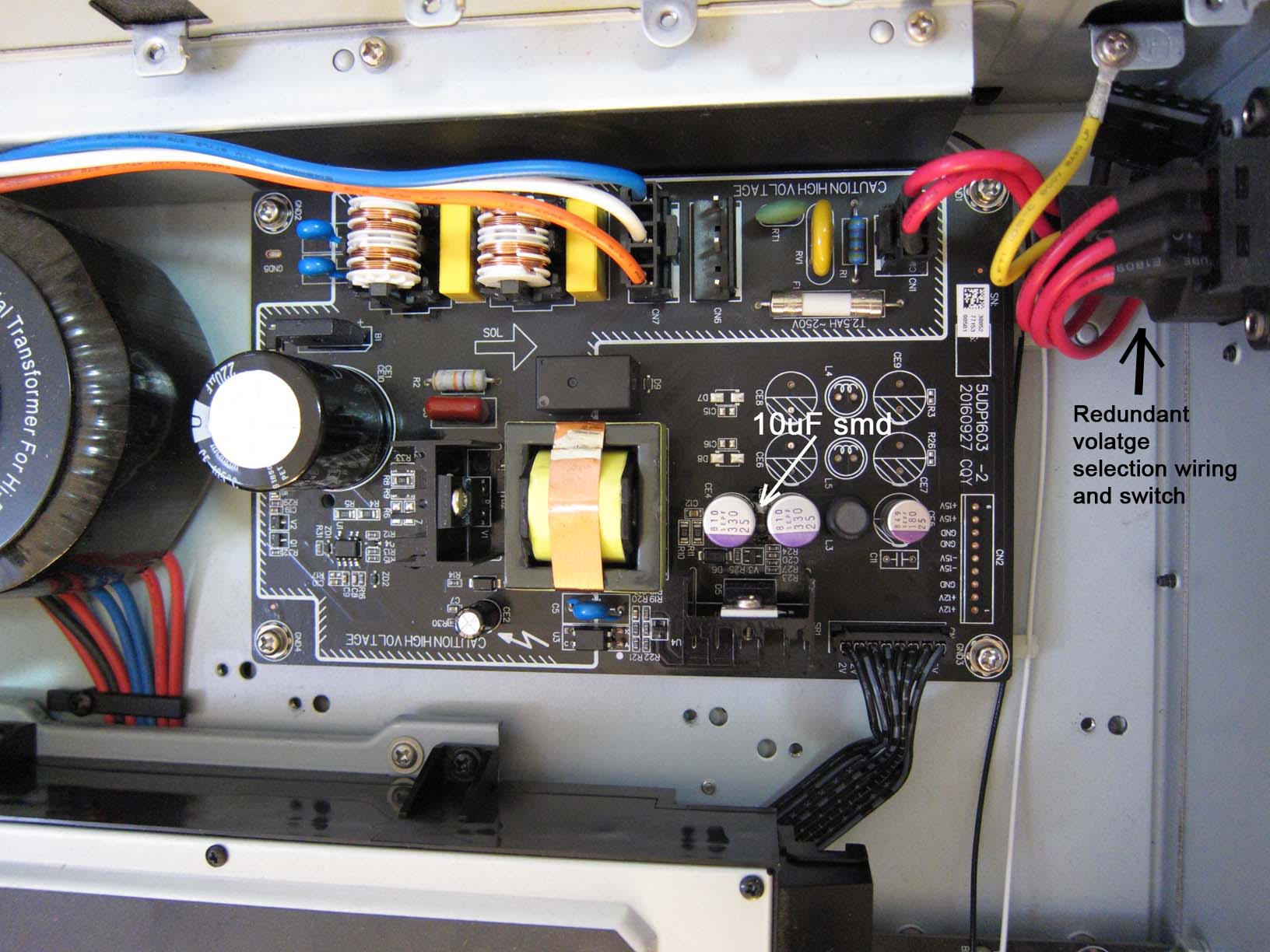

I have also experimented a lot trying the improving of the existing SMPSes for Oppo players. Increasing the capacity of the main cap in the SMPS it was also my first try. Improving the DC output filtering I have tried as well. I have tried many other solutions. Some overall improvements occurred... but best results were only when using a linear power supply.
When Oppo used a quite low capacity (68µF) for main filtering cap in their SMPS, they had a reason: minimising the power the SMPS use when in standby (no load connected). Here it is a compromise in between the lowest ripple current (power use when in standby mode), and the acceptable noise at the SMPS outputs.
As known a SMPS (active power supply), it use power from outlet for its own use, when no loaded. This low but in fact power use it come from its always running oscillator inside (and the control system), and mainly from the (always) ripple current, caused by the main filtering cap. When the capacity of this cap is higher, so it is the ripple current as well.
Let`s say the SMPS, as an always power consumer, it is not a very big issue, as such power is quite low (2-5w). Many such SMPSes all around in a house it mean in the end an important waste... The higher power SMPS is rated, the higher standby consumed power.
Ignoring this waste aspect, it still also (and always) an high HF noise level at an SMPS output, which it propagate further into the powered system, no matter the filtering measures are taken.
Improving the existing SMPS in this case it is possible, but in my opinion an LPS (passive power supply) it is the best solution for dramatically lowering the noise related issues when powering a digital system. An LPS never generate the typical HF noises an SMPs it does. Such noises are to be added to the powered digital system own generated HF noises, and the result it is enough complex and almost impossible to be filtered out. An LPS does not have a such issue. The LPS (fully free HF noises referring to a SMPS noise range), it only dramatically lower the overall noise into the powered digital system.
I am not rejecting the SMPS improvements presented here, obtained with a relative low cost investment. The final result it is also proportional with this involved low cost as well...🙂

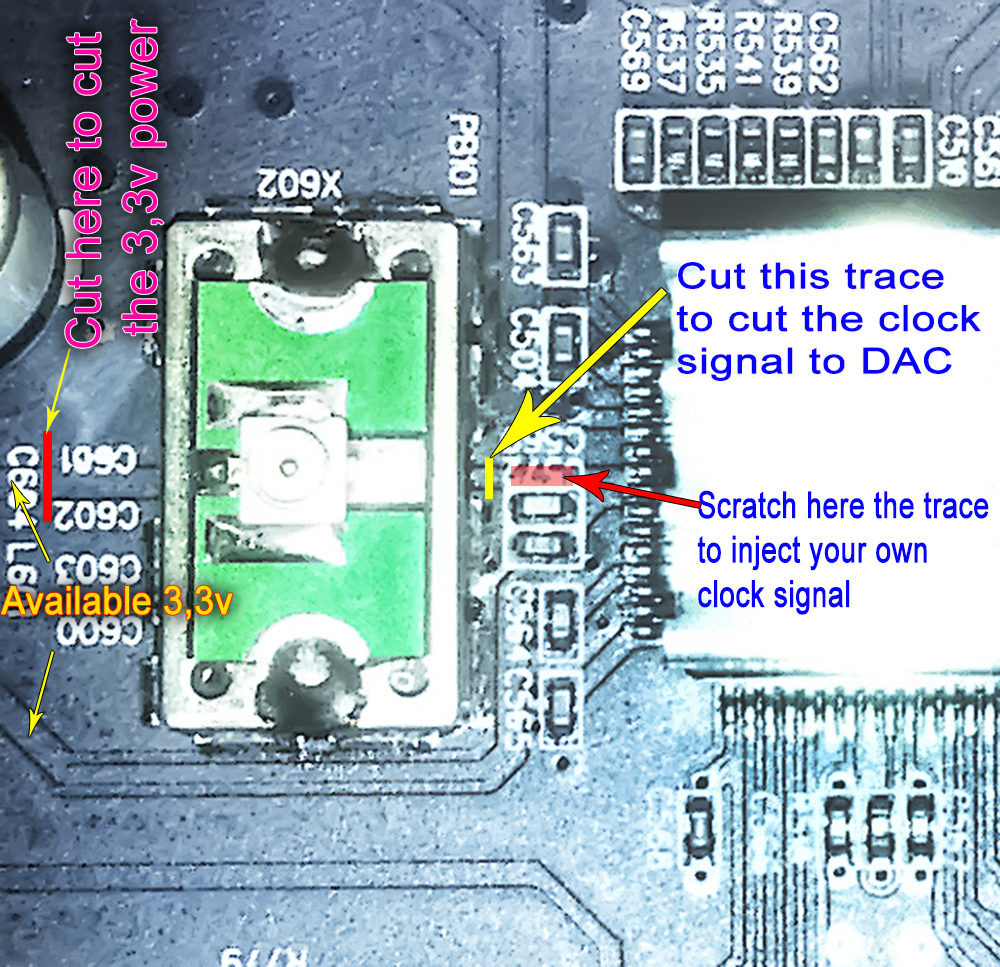

Recently I got on my bench a 205, with an added Femto clock modification (and Opomod LPS). The device was not functioning at all, not starting up.
I would like to share some of my observations, regarding this modification approach, because such so-called improvement it rises up some serios worries.
First, I would like to point out about the original DAC clock on stereo board. This 100 Mhz oscillator is covered by a shield well soldered to the board. In his installation instructions tutorial for Femto clock board, Oppomod give the impression that it is a requirement for removing the original shield of the DAC clock, to make possible soldering the buffer board connections on points inside the shielded area. More, it is shown in that tutorial that the oscillator itself should be removed, as some other components around. This way of doing is definitely and fully wrong!
The shielding of the DAC clock is very difficult to be removed with the means, and tools of mostly DIY guys, who may think to implement such Femto mod. The chance for catastrophic damages on PCB is very high. Removing this oscillator shield is highly unnecessary!
The clock device for DAC it can be very easily isolated and dismissed, by only cutting two traces: 3,3v power supply and clock signal output. Please take a look at the picture bellow.
You can very well and elegant glue somehow the Femto buffer for DAC on the existent shield, and connect directly the ground of the buffer to the shield itself. Then its 3,3v input, to the available 3,3v traces. Also, the output of the Femto buffer it can be easily soldered to the DAC clock input trace (after cutting the connection to the original oscillator).
Well, some magnifier tools may be necessary to succeed in this task, as some fine soldering irons, but is by far much easy than struggle a lot with removing of that shield.
Also pay attention when cutting the traces, to not go too deep into the PCB with your cutting device, as some other traces inside (into) the board it can be damaged so. Just scratch and cut only the copper surface of the trace.

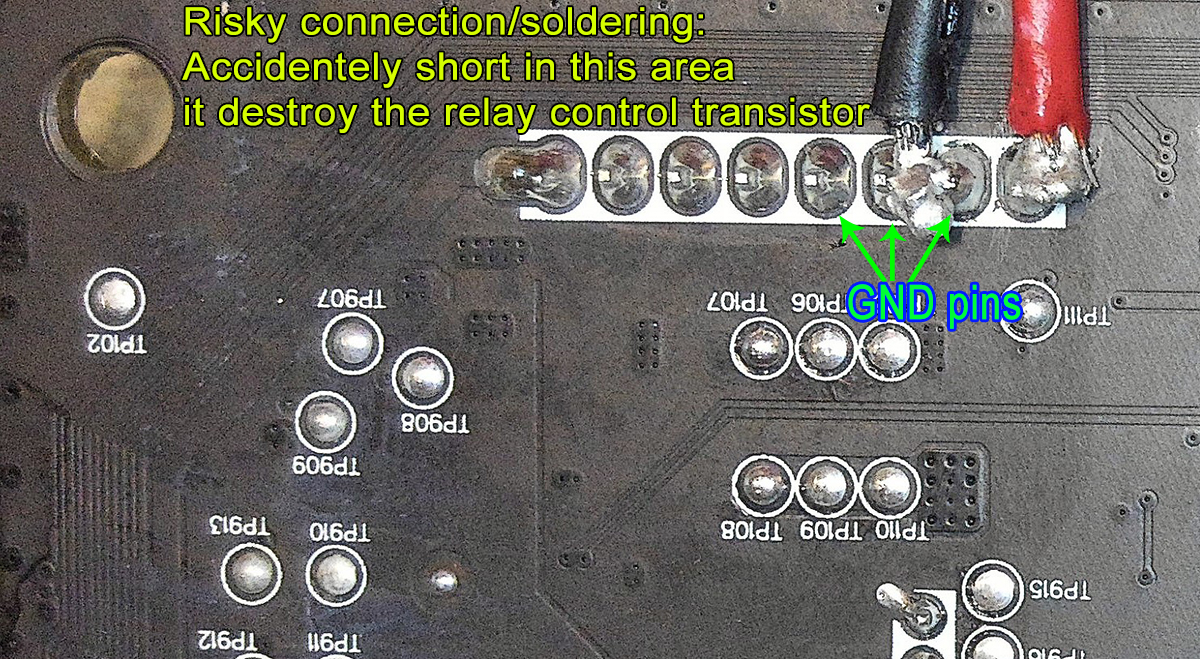

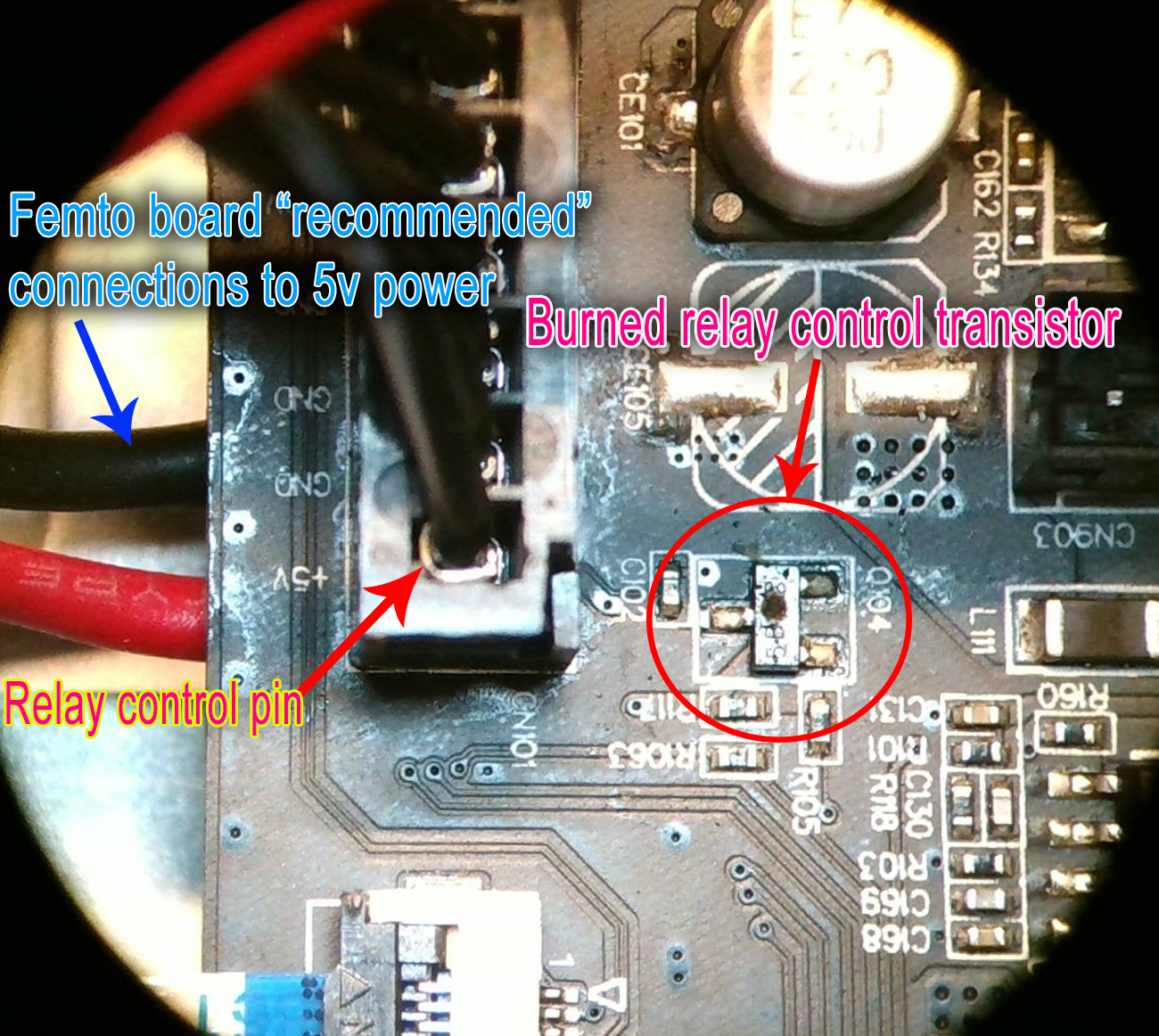

As I mentioned in above post, the 205 equipped with a Femto clock board I got, it was defective, not starting up.
The cause of the issue it was the relay control transistor which it was burned (see picture 7).
The Femto clock board it is connected as shown in picture, on the relay control pins. VERY WRONG!
This Femto board it takes 300mA on its 5v power input, and the relay control circuit it was not designed to sustain a such supplementary current. The transistor used by Oppo to control the relay it is specified for an absolute max. current of 500mA. The Femto clock board it have also an 10000µF capacitor, which it take an important inrush current at starting up, even though the resistor serial mounted to it.
The total inrush current it overloads the relay control transistor, and its life span it shorten drastically. The marked “+5v “, nearby the power connector pin, it is not meant to source 5v other than to the relay itself. This pin is not a +5v power supply! This important consumer (300mA) it also overloads the SMPS which it primary provides this power.
Another risky situation when installing this kit, it is the 5v connection in itself as it is advised in the installation tutorial (see picture 8).
This Femto clock board it should be powered from elsewhere than the main board. But in such case, power up synchronising it should be solved…

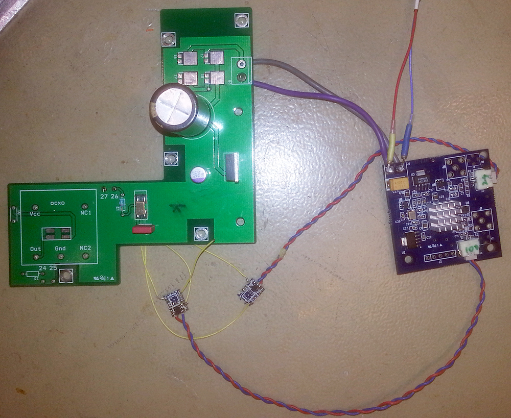

More about the ” engineering” approach in this Femto clock case…
Femto clock approach/kit (picture 1) it is based on an PLL chip which it is run it by a 40Mhz oscillator, and it provides differential outputs for different clock signals. On a second PCB in this kit, it is installed an 25Mhx oscillator, powered by a 3,3v regulator, to provide clock to the optical drive processor. The differential line transmissions coming from the Femto chip itself, are converted to unbalanced output by a buffer chip. This buffer chip mounted on a small PCB, it has to be powered by 3,3v.
Oppomod tutorial advise connecting the 3,3v buffer board (27Mhz clock) power pin, directly to the small SMPS on main board. One can only imagine what HF noise level is injected in this way, into the clock signal for main processor… Femto clock approach is meant to improve the clock system for this device…

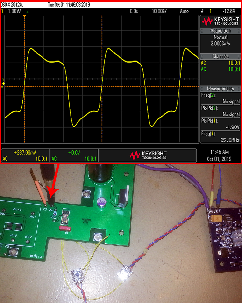

The Femto kit board which it has installed the 25Mhz oscillator it has also a very professional solution for +5v connection to the board (see picture 3). Maybe such connection it lowered drastically the production costs…

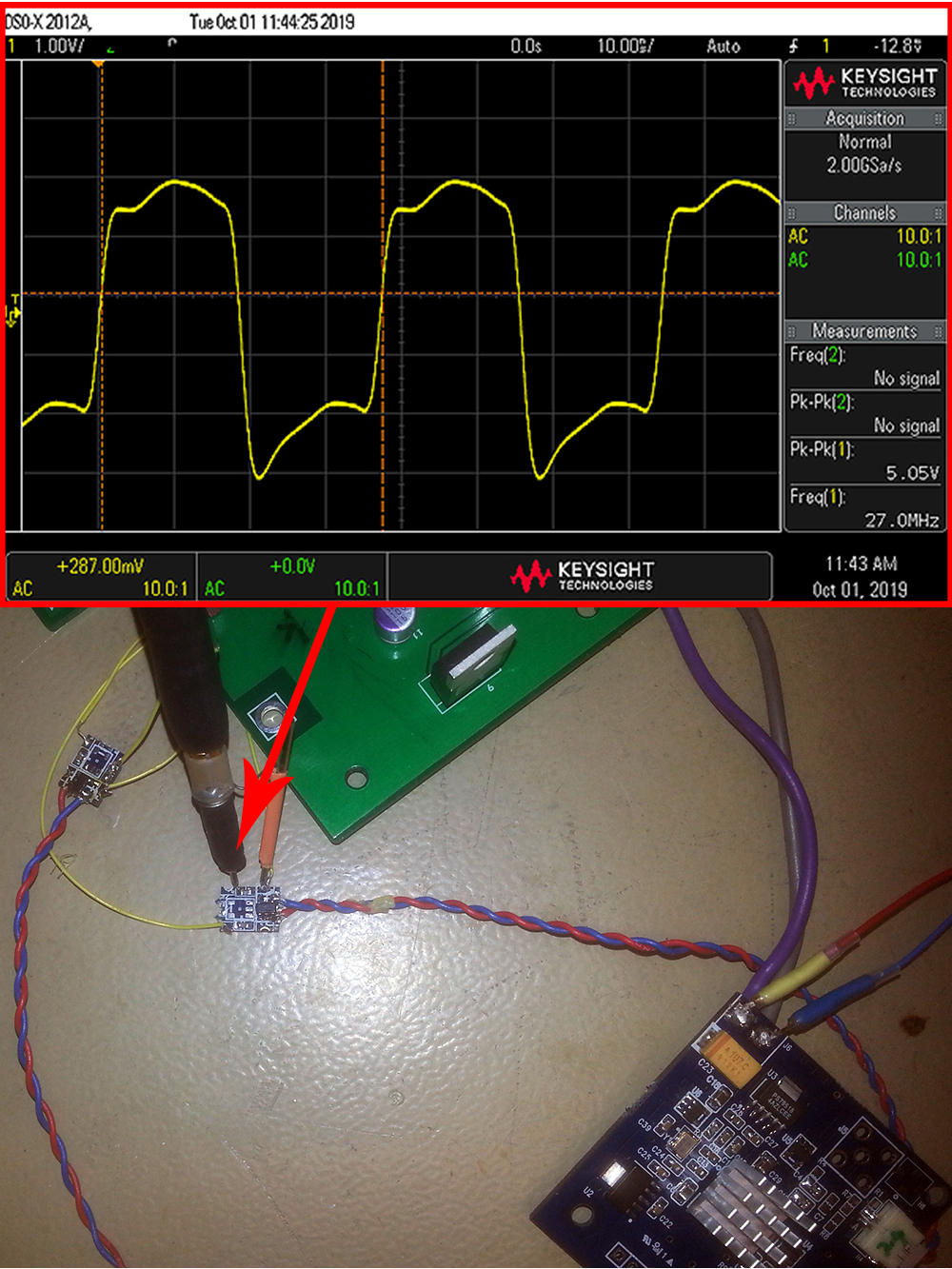

Another issue I can see about the 27Mhz clock signal output, is its TTL level. This TTL clock signal level is meant (in the conception of the Femto clock producer) to get so into the main processor clock pin input (see picture 5), which it was designed for a LVDS level…
LVDS signal level is much lower than the level provided by the buffer. I appreciate as very risky injecting a such high-level signal into the processor input which it was not designed to sustain a such high level. It may work for a while…

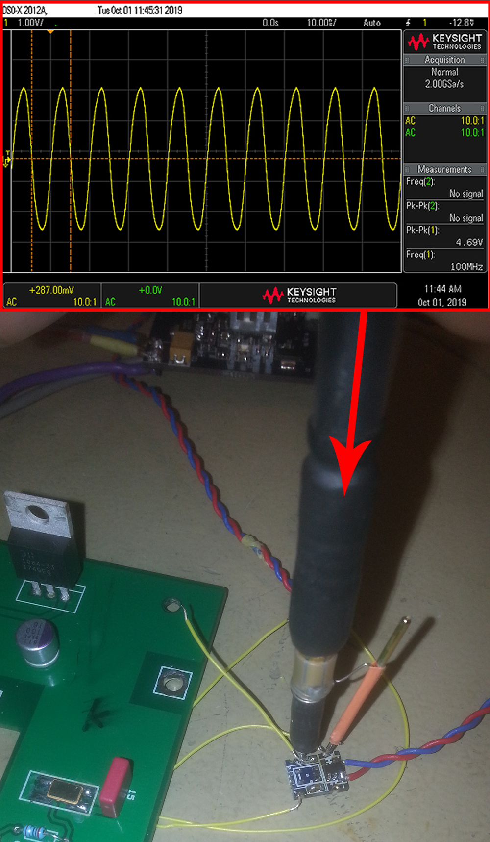

The same situation is about the DAC 100Mhz clock signal. But here, fortunately the ESS9038 it tolerates TTL signals at its clock input…
I added hereby for your appreciations, the measurements taken on all of the clock outputs of Femto kit. Jitter is not measured...
