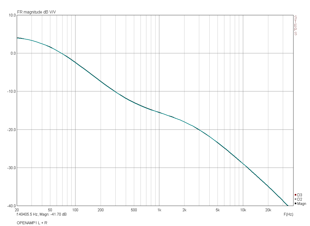

This is the MEASURED frequency response. Both channels (blue and black plots) in same graph. Y-axis is in dB, but please forgive the constant shift (card not calibrated to preamp). At 1kHz, gain is 40dB.

For those who might be interested, I have prepared an open project of the phono preamplifier for MM cartridge. It has very low noise and very low distortion. Gain is 40dB/1kHz. Output is capable to drive 50 ohm load, so one may directly connect headphones via 100 - 220 ohm pot.

To demonstrate buffer capabilities, please see attached distortion measurement of this MM preamplifier into 50 ohm load.
The preamp is really "foolproof". If assembled with recommended components without mistakes in soldering, it works at first attempt, without any adjustment. The DC output offset is below 1mV.
But, the main contributor of the noise is NOT the preamplifier, but the vinyl groove itself. I have a plenty of measurements of noises of plain vinyl surface, "empty" ("silent") grooves, grooves "without signal" from measuring records etc. The real record would worsen the noise about 30 dB compared to the measurement of the preamp connected to the cartridge with needle "in the air". Please see one of the measurements of the vinyl groove "without signal". Especially the low frequency noise of the vinyl is quite horrible.
Let's see what happens with noise level when we replace the OPA627 with OPA134, TL071 and AD744. But, how much important is this considering the vinyl groove noise? It is up to the builder, but I still recommend the OPA627. For those who would like to use something cheaper I would admit to use the OPA134, but nothing worse. All these measurements with input teminated with 50 ohm.
