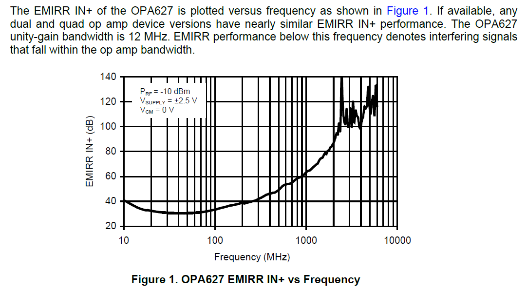

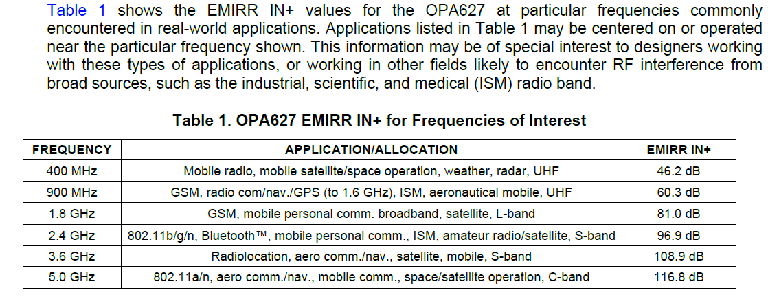

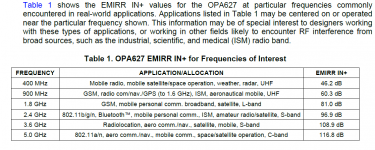

PMA knows this (because he's always going ooooon and ooooon about EMI! ;-) ) but others might not:
http://www.ti.com/lit/an/sboz016a/sboz016a.pdf

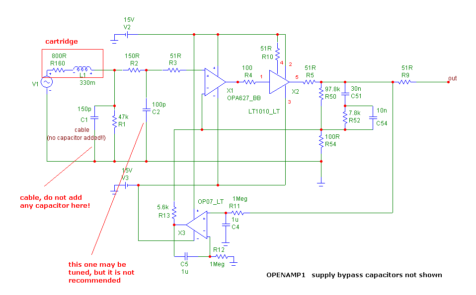

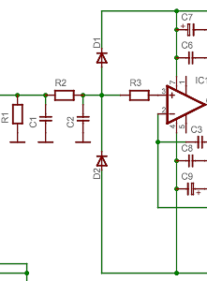

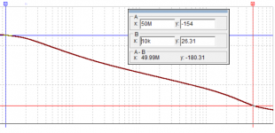

PMA could you talk more about your interesting R2(150ohm)/C2(100pF) filter (10MHz) right at the input? I wonder what that could be about ... 😎
Jeff
PS "EMI and OPA627" could be it's own thread too! Application outside of RIAA ...

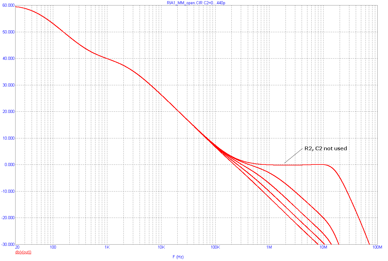

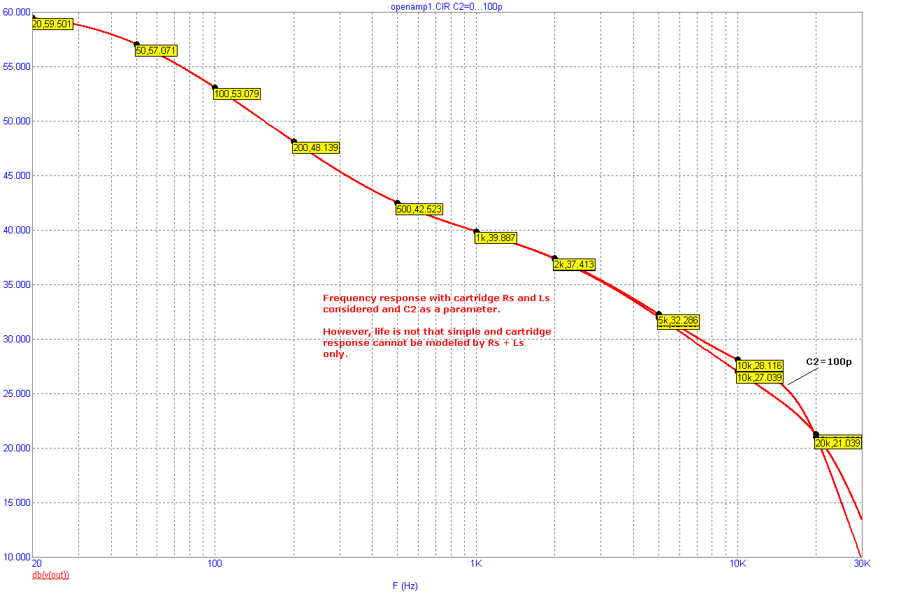

Well, yes. As now, it serves mostly as an RFI filter.
It might, theoretically, improve RIAA response for very high frequencies, if we speak about phono preamp alone, driven from pure voltage source. As you know, non-inverting network has gain no smaller than +1 (0dB), until the opamp's bandwidth will roll it off. R2 C2 could be calculated to allow the RIAA curve continue in attenuation even for very high frequencies above audio band. Please see the attached image.
But, in a real world the phono preamp amplifies signal not from the voltage source, but from MM cartridge, which has output impedance like resistance and inductance in series. Usually 500 ohm - 2000 ohm + 300 mH - 1500 mH. This inductance makes thus a roll-off even for high frequencies and the role of R2C2 described hereabove is valid only in case of voltage source signal (= zero output impedance). And we cannot increase C2 too much because we would load the cartridge by high capacitance and create high resonance peak somewhere between 15 - 20 kHz. We also cannot increase R2 too much for we would get increased noise.
I hope this helps a little, for more on theory please study literature about phono cartridges, like Vogel (The Sound of Silence). Walt Jung's publications are also excellent and may help, but I am not sure if he works with cartridge models in his considerations.

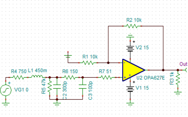

Now, I just got into vinyl a couple of months ago, so correct any newbie mistakes ...
...But, in a real world the phono preamp amplifies signal not from the voltage source, but from MM cartridge, which has output impedance like resistance and inductance in series. ...
I've looked at cart loading before for I didn't include the inductance ...
Wow PMA you weren't kidding! Totally different!
Ortophon tells me my OM5E has:
Internal impedance, DC resistance 750 Ohm
Internal inductance 450 mH
And recommends 200-600pF/47k loading (300pF/47k)
I threw those into the Tina circuit of the 627 and then added just the input of the OPENAMP1:
View attachment OPA627 PMA riaa input.zip
Had to zip it, hope it unzips ok

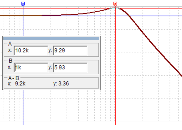

And then simmed (1 to 100k) with the RF filt (150/100pF)

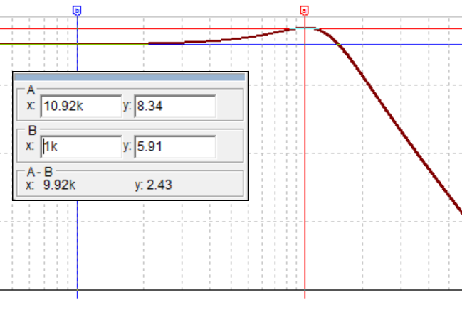

3.4dB boost at 10.2k
And then simmed with no RF filt
2.4dB boost at 10.9k
I didn't think it would matter being a 10Mhz filter but I guess it interacts with all the other input parameters:
So a 3.4dB boost at 10.2k with the RF filter but only a 2.4dB boost at 10.9k with out! Wow, wasn't expecting that ... but it is a small difference.

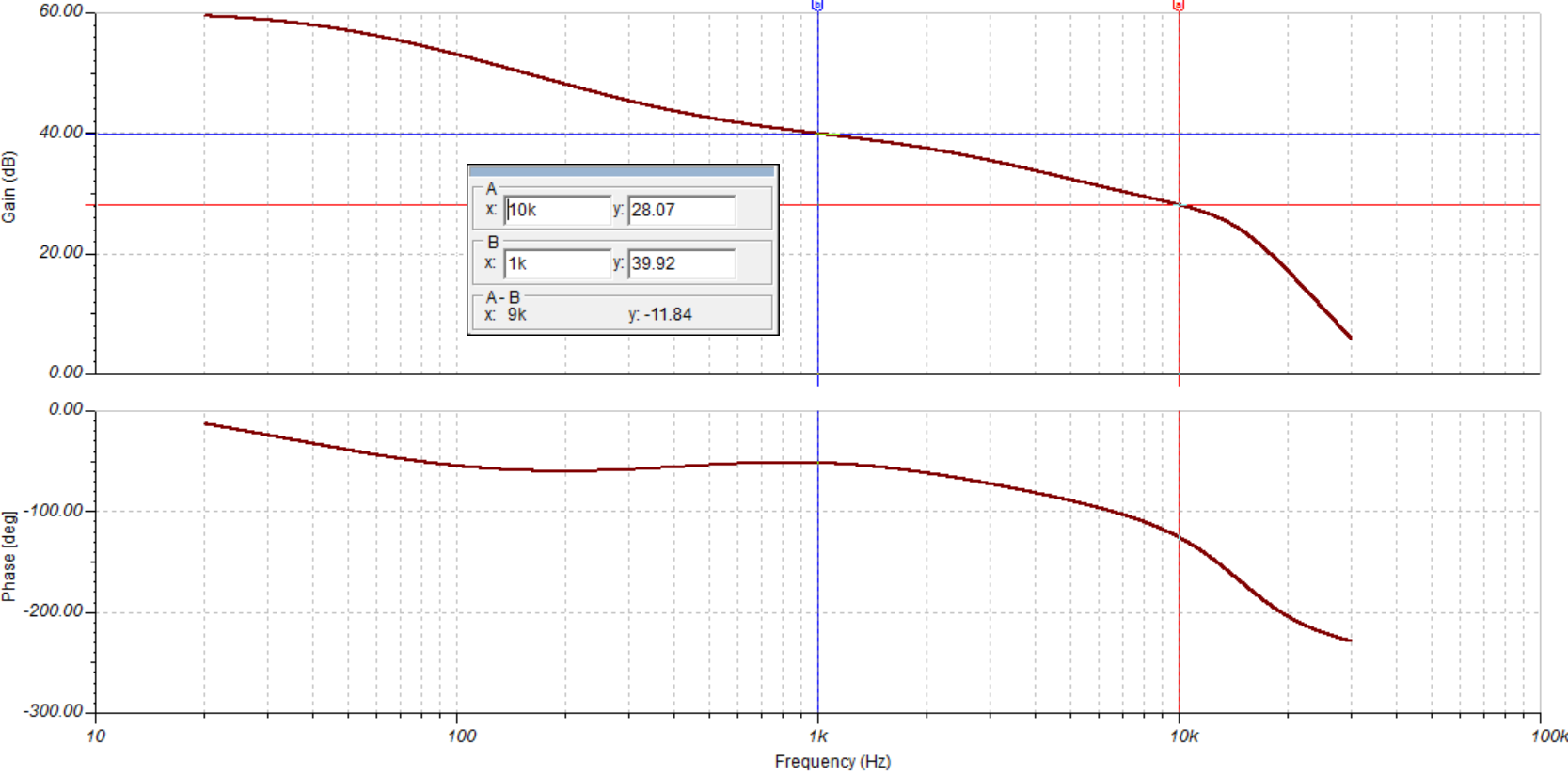

Do not add any capacitance. Please see that additional input capacitor is zero in the BOM. Keep only C2, indexed as per my schematics. Your different indexes are confusing the issue and may be misleading for other readers. Please do not modify the part values if building the preamp.
Sorry Pavel, you were right. 😱
Simming the rest of circuit isolated the RF filter from loading the cartridge.
Ok, no C1 capacitor and just assume 150pF as the value to account for cable capacitance. I've updated my circuit.

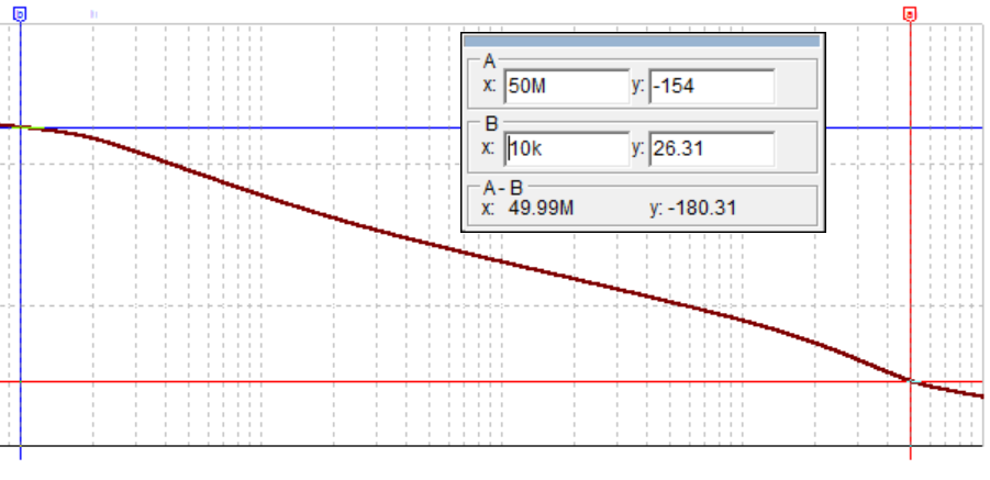

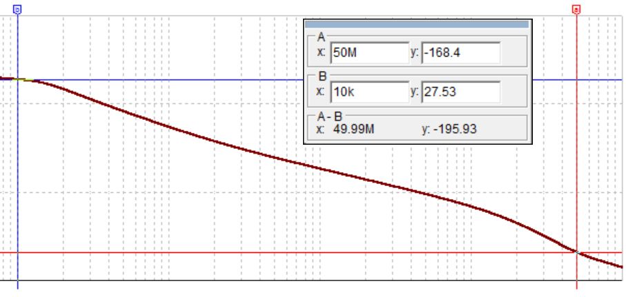

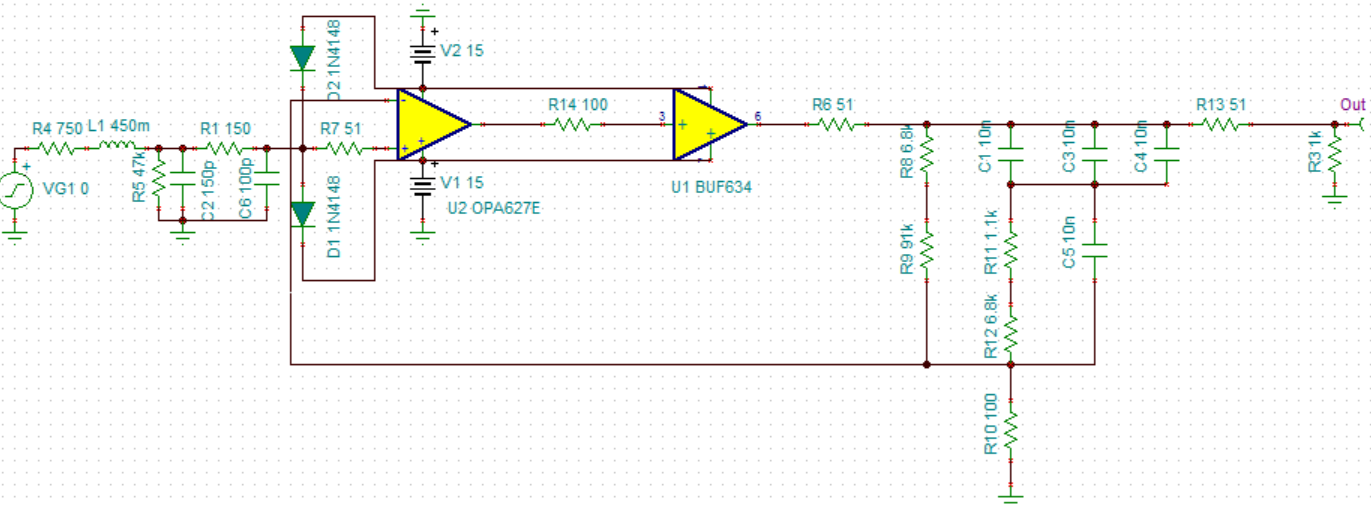

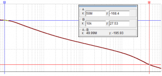

With the RF filt (R2=150ohm, C2=100pF) there's a difference at 50MHz:
With RF filt
5MHz @ -195dB
Without RF filt
5MHz @ -180dB

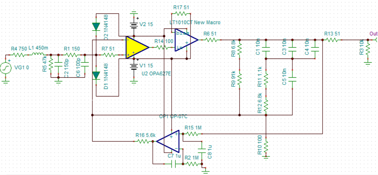

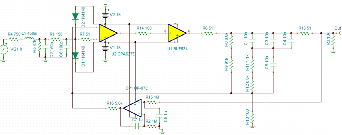

TINA didn't have LT1010 but it did have BUF634 so I used that just to see the basic frequency response. Here's the TINA circuit with the BUF634.
And the TINA file:
View attachment PMA riaa OPA627 BUF634.zip
Anyone know where to get a LT1010 TINA model? I think there's a LTspice4 model of the 1010 ... how to import ...
