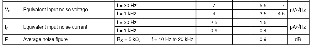

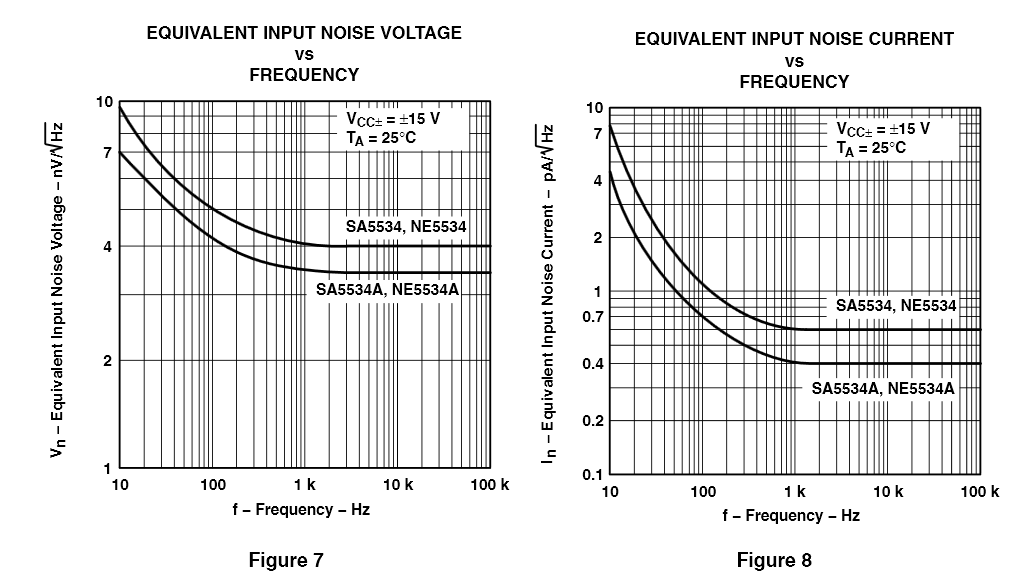

Here's the NE5534 noise.

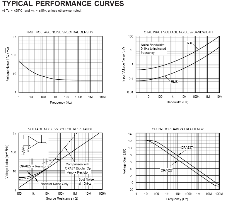

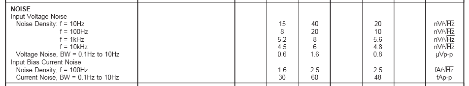

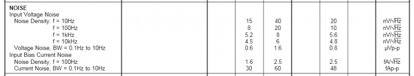

Here's the OPA627 noise.
NE5534 In=0.4pA /(Hz)^(-1/2)
OPA627 In=1.6fA /(Hz)^(-1/2)
femto! 0.4pA vs 0.0016pA or 400fA vs 1.6 fA
(but I have no idea if the tests are identical enough ... and how do you even measure femtoamps?!?!? :-0)
And here are the graphs:
NE5534
OPA627
I used NE5534 with 4.7pf between pins 1and5, as Doug Self did in his all active RIAA phono , to force it in unity gain mode.
Of course OP 627 is better, but NE5534 is suitable ,same as OP27 op-amp.

OPA627 and OP27 are FET input opamps with ~400 times less current input noise than NE5534. And that's just one spec ... I don't think you fully appreciate the extremely high level of technical performance that PMA has achieved with the OPENAMP1. Please review his measured graphs (not just 'in theory' or "I think the performance is this good") and compare them to other designs.

First of all, OPA134 has worse measured spec than NE 5534, but it is said to be more immune to RFI noise than BJT inputs. Tl071 is unity gain stable very old J-Fet design . OP27 is aBJT op-amp. Input current noise of NE 5534 is low enough not to increase total noise of the circuit with high inductance MM. I used Shure VST-V cartridge and my very similar preamp was dead quiet.4oo times better noise has no any influence, not even half a db.

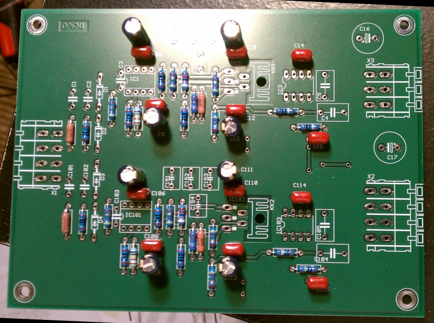

This is an issue for those that don't have the official PCB (I believe I got the last one).
Proper PS bypassing of both the 627 and the 1010 buffer, proper grounding, low-level signal routing ...
Perhaps a couple of people who know what they're doing could post their point-to-point layouts?
PS No, PMA won't be doing any more soon (please don't bug him, we need him for his technical advice, not simple corrections) and I don't think he'd be OK with a copy of his PCB...

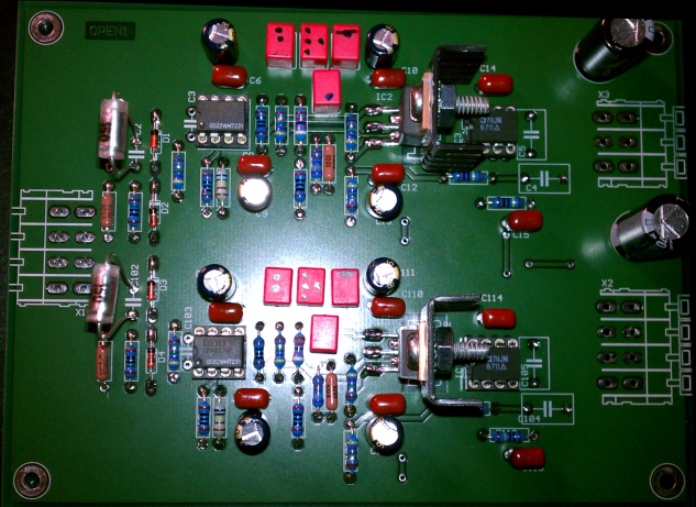

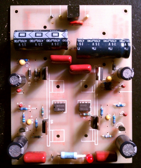

very slow progress, almost all passives mounted so far.
hopefully faster progress this weekend when the women are out shopping and leave me in peace to play 🙂
these are the 4 cartridges I've got to play with.
will wash up some vinyl tonight then go to bed.
mlloyd1

Looking good! What parts have you selected?
Res:
Yageo metal film
Vishay RN
Caps:
Bypass:
.1/50v metal films
Panasonic FM electrolytics
And those are some sweeeeeet carts. I'm especially interested in the M97xE (I bargain bin shop and end up with a lot of warped records: this cart specializes in warped records!)
thanks!
just the usual parts i have in my stock; the bypass film caps are some panasonic metalized polyester i happened to have that would fit. they've served me well as bypass caps for many years. the frequency shaping caps will be wima or vishay fkp series. the cartridge termination caps will be some nice polystyrenes i have. i'll match up caps up tonight, although i might have already set aside some matched sets from years ago.

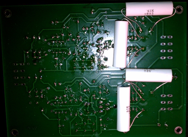

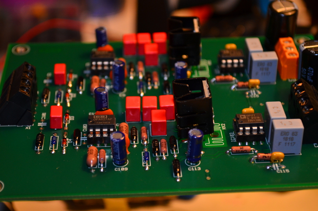

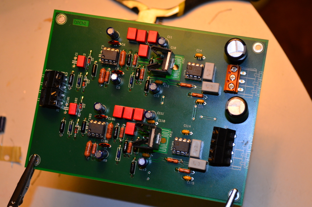

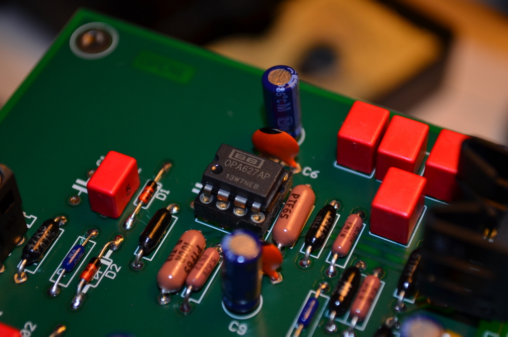

still at it ...
more porn for you junkies ....
i will probably hard-wire input, output and power leads for testing. i have a stock of AD711s i bought back in the 1980s; they are my default servo op amp until the stock runs out.
my servo caps are not the small box types, i had some old 2.6uF axial polyprop films, so I just hide them on the back of the PCB. I'll glue them down later ...
i was going to use one of my jung super regs for testing, but I didn't feel like disconnecting the ones currently powering my line stage and i didn't feel like building up another set. so, i'll just use one of my old (built back in 1985) borbely designed sulzer-like regs that I keep around for times like this.
yeah, I use lots of old parts. for example, you'll see date codes on the AD711 from 1987 and my OPA627 parts say Burr-Brown (not TI) because that's where they came from way back when. But then again, I never have to worry about problems from counterfeit parts using this approach.
