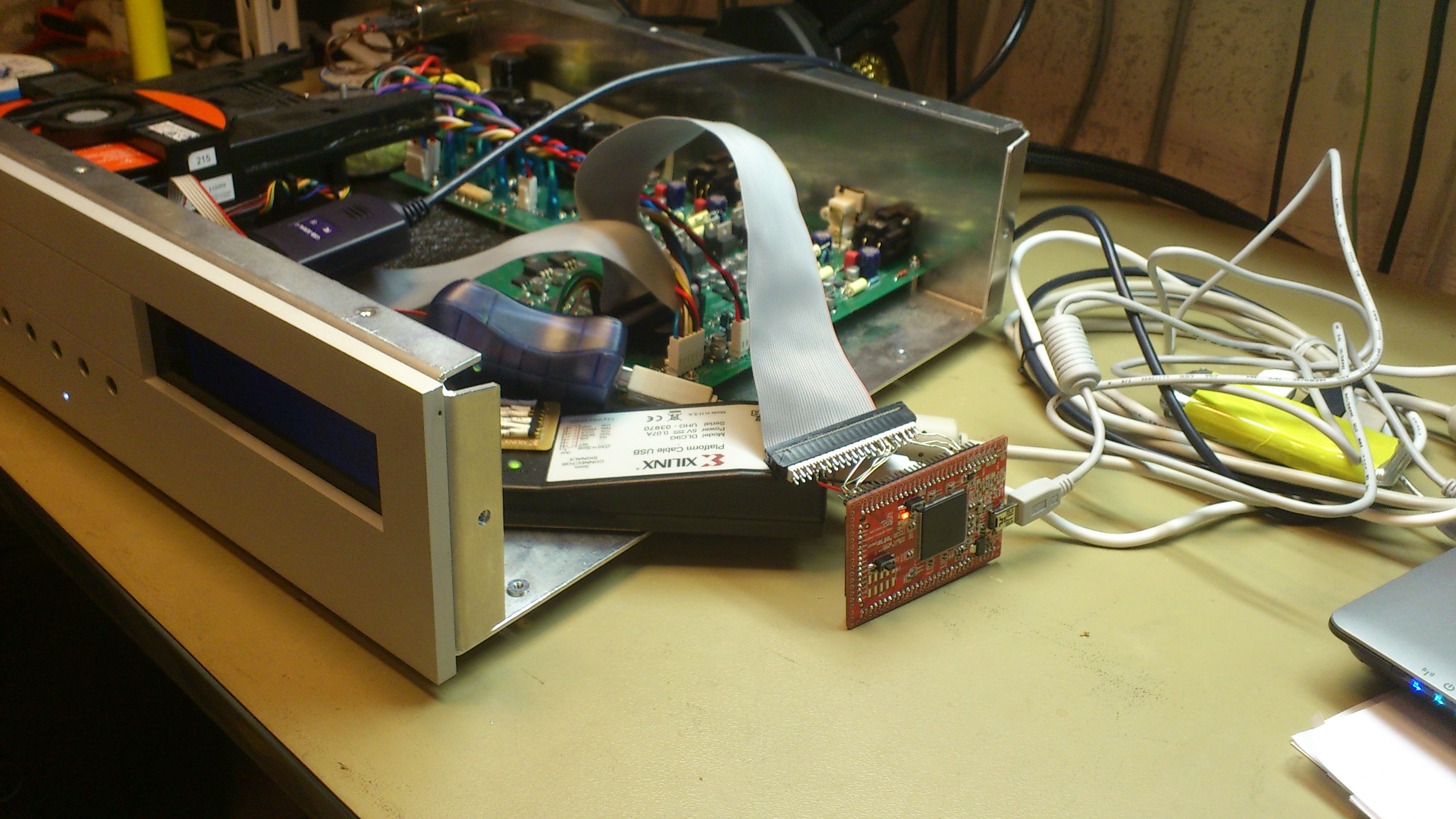

Late-night hacking - great success!
Hi guys,
I just have to tell you what I did in my lab! Countless hours, soldering and lines of code have come together to where I have merged the USB-I2S module with my CD player project. Doing this is why I started getting into this whole USB business in the first place.
The two became friends immediately, and all the content I threw at it (16/44.1-24/192) came straight through to the DACs.
A lot of debugging and verification still remains. But the most important thing is that it plays!
