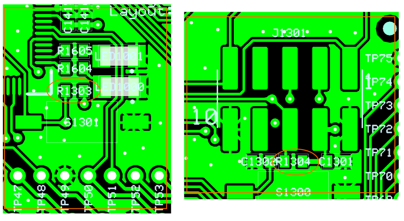

What is providing power in your setup? The JTAG connector has a direct connection to the regulated 3.3V supply of the MCU. If the Dragon also provides power things can go very wrong.

The power should be OK. Both the board and the Dragon are connected to two different USB ports on a laptop. I tried different setups with no change.
The reset happens when I launch any command on the Dragon, which actually pulls the reset line on JTAG low. I think this is normal, or not?
Anyway, when connecting an X-plained board in place of the AB 1.1 everything works ok: the reset line is pulled low, and the JTAG works ... with AB 1.1 the board resets, and the Dragon reports an error saying the it has troubles reading the JTAG id ....

Another doubt: browsing the code I see there is a section where the CPU tries to understand what's the cause of the reset ... brown out detector, actual reset button and so on ...
There's nothing that deals with JTAG. This code is standard or custom for the board?
From what I understand if it's executed ... it's normal that the board resets. Maybe it's another stupid question, but shouldn't be there some check on if a JTAG session is starting?

Maybe try disconnecting the USB from the audio-widget. Just power the Dragon and connect to the JTAG connector. In AVR32 Studio there is an option to supply power from the JTAG to the uC - make sure it is 3v3 (not 5V).
I have been using JTAGICE MkII with the sdr-widget (a sister project of the audio-widget) with no issues. I have not tried with the audio-widget though so it may be different.
You should be able to completely erase the flash on the uC and install a new bootloader and change the fuses (with the JTAGICE MkII). Don't know about the Dragon

I'm unable to find where I can set the Dragon to supply power, I suppose it's always on? VTREF pin is connected to VDD_3V3, so it should be so.
Anyway, after my last attempts I'm stuck in a very strange situation, with firmware of May 29 installed, working in UAC2 only, and unable to put the board in DFU mode any more. I tried in every mode, but without success.
Is there any other sequence that I can try besides keeping Prog button down and hitting reset?

The Reset and Prog button signals should see 10kOhm to +3.3V when not pressed, and 0Ohm to GND when pressed.
Which colour is your module? On the red ones I made a BOM mistake and specified 10nF capacitors for the pull-up resistors. This is something I fixed and then tested on each module which went out. What you are describing sounds a bit like what happened the first time I powered on a module like that. So if your module is red, check if R1303 and R1304 are indeed resistors.

Hi Borge, hi Alex,
after a lot of attempts I was able to revive the board, loaded the latest firmware with DFU and now it's working (in UAC2). I'll leave it this way to avoid
further problems.
Anyway, two details.
- My module is yellow.
- I removed the pullup resistor and capacitor to ground on reset line, the Atmel datasheet states that there is a pullup internal to the chip on RESET_N, so they should not be necessary (and my idea was that they were interfering with the reset signal coming form the Dragon). I got no change, the reset works equally well without them in place, and the Dragon is not working in the same way.
- My final idea is that there is something in the code or fuses that prevents the JTAG resent signal to be interpreted correctly (the chip should understand that it's the start of a JTAG / ISP session, and instead it resets as usual). I don't believe that a JTAG ICE II would improve things, but if you confirm that the JTAG is working on other installations I'll try to find one to see if it's better. If nobody has recently used it with JTAG ... maybe it's a waste of time, maybe the code has changed since your last successful attempts.
