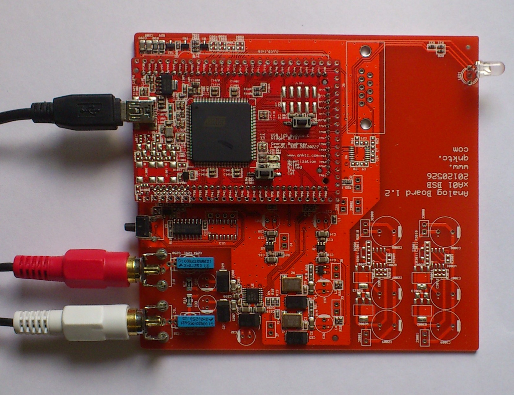

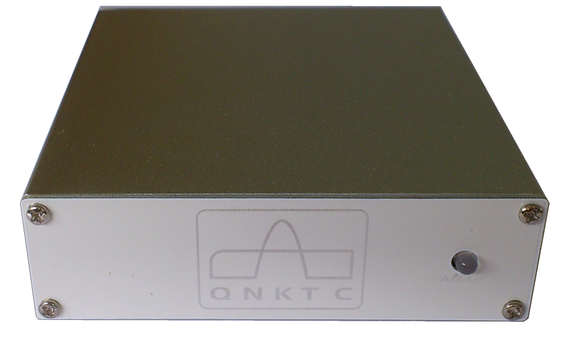

AB-1.2 has arrived!
The AB-1.2 has arrived!
I'll start shipping the pre-orders tomorrow or Monday.
Børge
