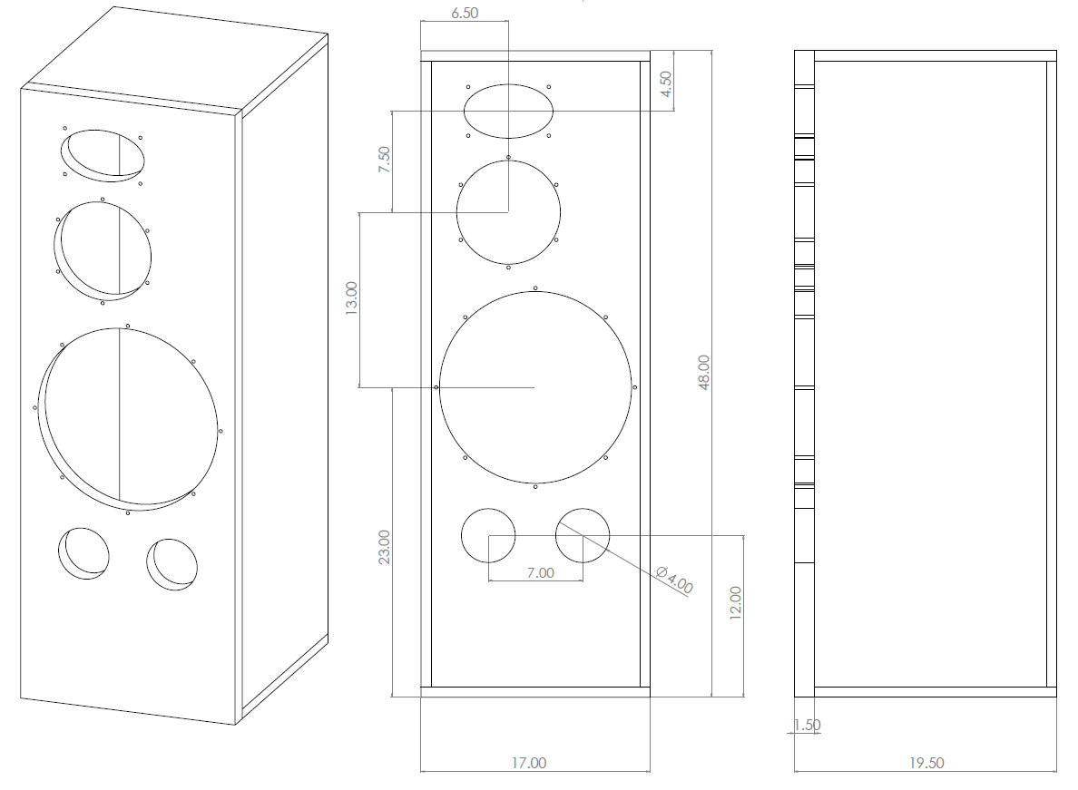

this is my proposal,
761953d1560123521-source-tower-xl-txl-v3-drawing-jpg
Volume is about 160L net. we can offset the mid and tweeter if needed.
You'll need a separate comparment for the midrange. Otherwise the woofer and midrange will interfere with each other via the their shared internal box volume.
I would suggest to offset the mid and tweeter away from the centerline to smear out baffle diffraction. A baffle diffraction simulator can be useful to determine the offset. I usually end up at left/right ratio close to the golden ratio. For the tweeter, the distance to top edge also may also be considered.

agreed, that's what i was about to bring up next. my focus here was the cabinet shape and size for bass volume and baffle difraction.
thanks for the tip, I will offset the drivers in the next drawing and also will push the drivers down a bit.

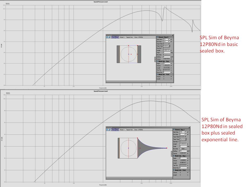

The simulation for the Beyma 12Pd80ND in a rectangular volume + fiberglass on the walls produces a 5db resonance at 800Hz. A wide range of internal bracing can reduce cabinet resonances, engineers at B&W obtained the best sound using a large open rear volume for dynamics, followed by a tapered tube with absorption material to reduce resonances. Pyramid shapes performed almost as well as tube shapes..... constant rear volume reduction + increased absorption material. Angling one rear horizontal board behind the driver to create a triangle for absorption material is a good simplification which still leaves rear top-bottom free air flow for the woofer.

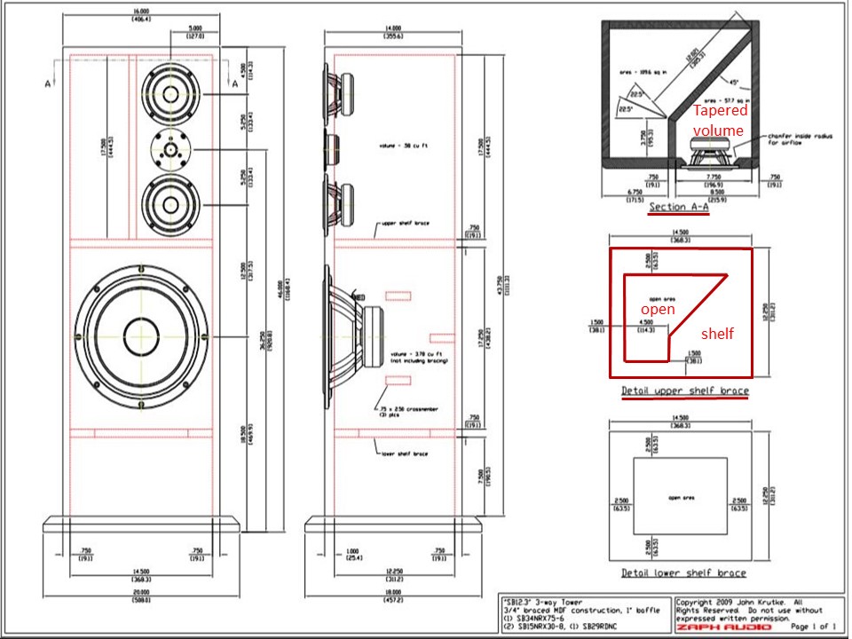

Jeff Bagby SB12.3 cabinet uses a simple triangle shaped volume in back of the midrange drivers. Simple construction detail.... small construction effort.
For a sealed midrange I often select a Qtc~0.57 to 0.6 alignment, which typically requires a large enough volume for a crude rear pyramid shaped. Large open volume around the driver for dynamics, absorption material in rear tapered volume to reduce resonances, enough open space remaining for bass air flow.
In some recent designs, I've used a simple rectangular tapered tube for behind the mids. Sort of similar to the Nautilus but easier to make. Typically there is a 90* bend for the tube to go up or down to fit it in.

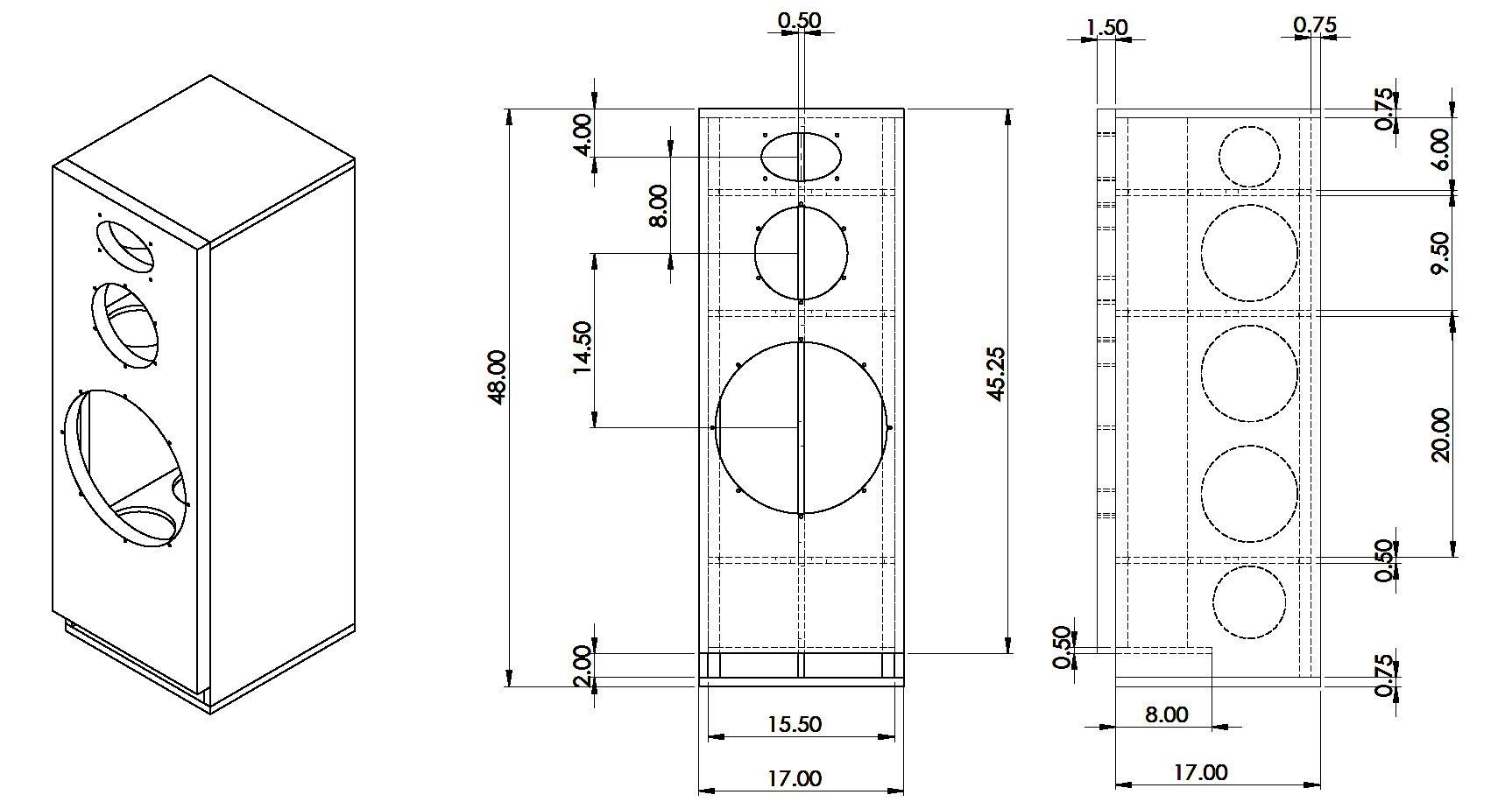

second attempt.
i lowered the drivers, now the HF s not that close to the top edge, I also offset the mid/hf from the center, and replaced 2" slot port on the bottom to a 4" port right under the woofer and offset from center (same distance as the mid/hf), no separated chamber for the mid section yet, i m still working on this, but so far what LineSource suggested (SBA cabinet) looks easy enough, we can talk about the mid section later, what do you think of the changes so far ?
Did you model the diffraction of the tweeter and midrange on your baffle? Did you try different driver positions?
If you'd move the tweeter and midrange to the right by 0.5" (6.5" from the left edge), their left/right ratio would end up pretty much at the golden ratio. Also, the top/left ratio for the tweeter would end up at the golden ratio if you'd change the horizontal distance of the tweeter to the top edge to 4". But I might be too obsessed with the golden ratio thing.

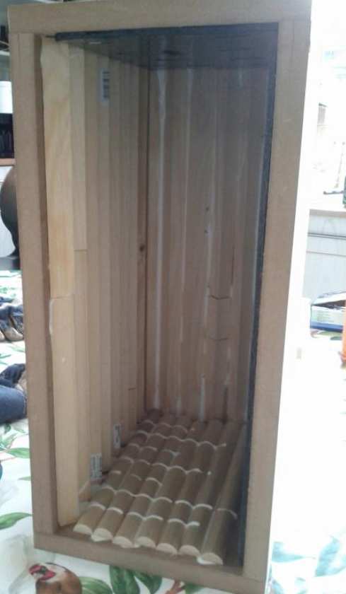

making the bottom and the top un parallel should be possible, but i came across this approach to avoid standing waves:
attachment.php
one side is covered with triangle (or half round) shape and the opposite side is covered with something like roofing material or some other absorbent material.
what do you think of that ?
763573d1560802335-source-tower-xl-ins-png
Waste of time, effort and enclosure volume. Bracing it properly would do far, far more to benefit the sound.

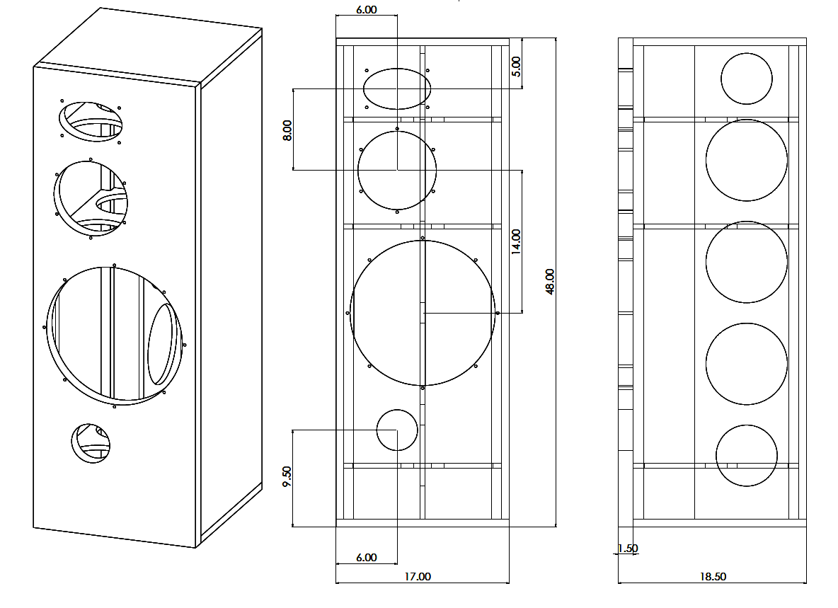

Thanks for the reply guys,
I made some changes to the drawing, i pulled the woofer almost to the center of the baffle (23" from the bottom instead of 24") and the ports 1/4" baffle height from the bottom.
in the Troel link you sent and almost all the classic JBLs the ports is close to the wall, which I don't get, maybe the cross over is lower than the first mode ? (here is 300Hz)
anyhow I tried to implement all the suggestions so far into this drawing, let me know what you think.
having the separated mid section is still puzzling me, with Q of 0.5-0.6 the volume for the TD8M is about 2-4 liter (winisd) which is way too small to do anything with other than a regular stuffed box around it.
Also having one of the top or bottom angled is a challenge to keep everything simple and easy.
