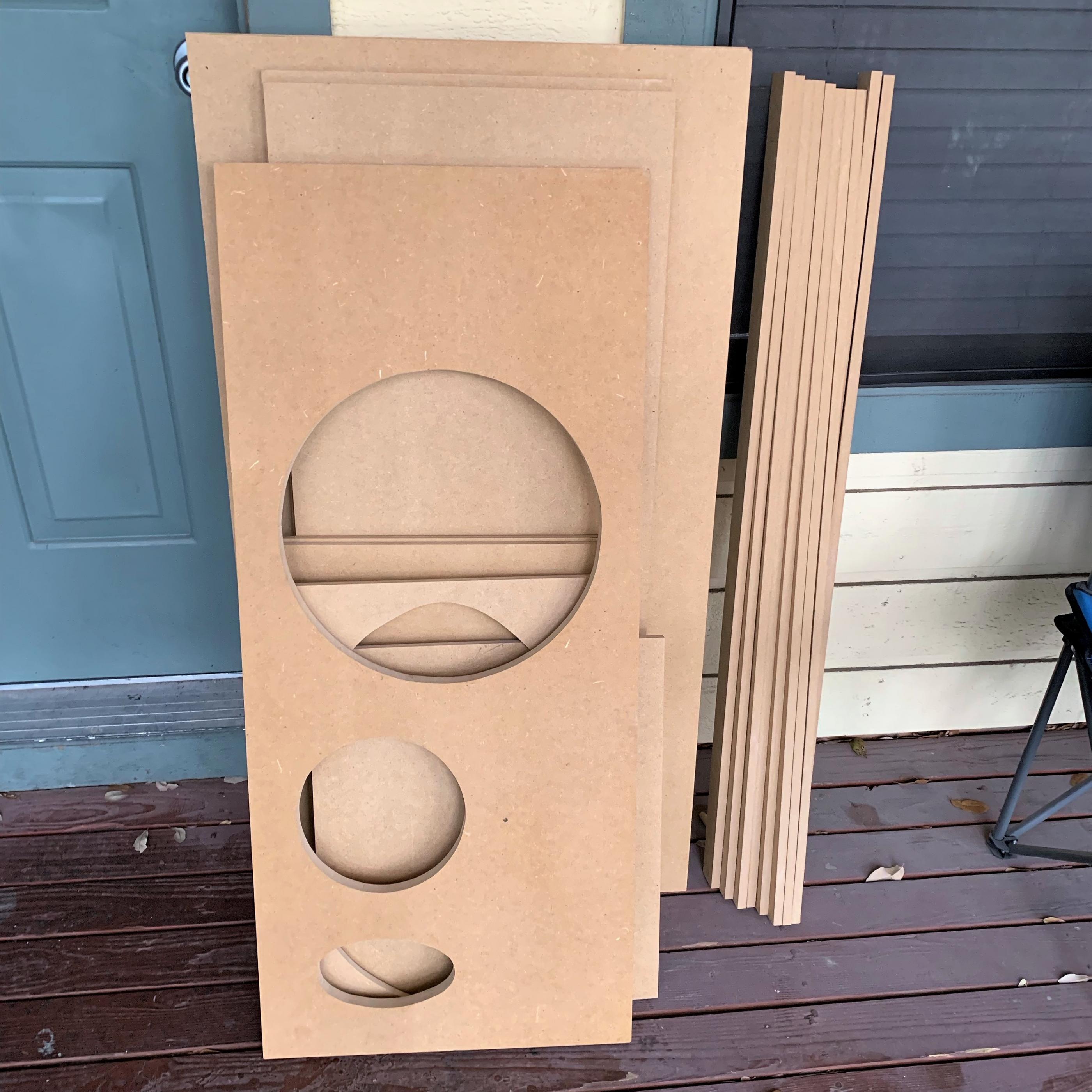

hi pcgab,
last questions about woodwork:
how many watts has your router?
the circle guide is an accessory sold separately? how much it cost?
I can make a pass with the router, jump a few spots down the circle guide, route, repeat, until I get to the final mark.
Why don't you use a larger router bit and do it in one pass? Do the small bits have any advantage over the large ones?

The router is 1678 watts / 2.25 hp. It's the Bosch 1617 EVSPK I believe. Personally I have the MRC23EVSK, which is also an excellent router.
The circle jig looks like a Jasper circle jig, works very well. Not 100% sure which model pcgab has 🙂
mbrennwa, generally I have found that larger shank router bits will result in a better cut, but good results can be achieved with smaller ones as well as we can see from pcgab's excellent work here. The most important thing equipment-wise is to buy a high quality bit in my opinion, and to make sure you're using it properly (correct speed on your router, which I determine with scrap and trial and error). Personally, all my bits are Whiteside and CMT. I prefer the Whiteside ones slightly because I find I get somewhat better/cleaner cuts with them.
The bit I used to cut those is Whiteside, they make great bits.
Pretty sure that's the model router I have, and it is a Jasper circle jig. 'Jasper 200J Model 200 Circle Cutting Jig for Plunge Router'
I used that bit, a 1/4" cutting diameter bit because it was recently sharpened and it is a spiral down cut, which tends to leave the top face a bit cleaner. When I'm cutting work material that's clamped to a sacrificial top on my bench, I prefer the spiral down cut bit. This generally allows the cuts to be executed so that both end up with clean edges.
They don't have any real advantage in this use case. It was simply what I had available that was sharpest. For a small recess like this, 16-18mm IIRC, it only takes a minute or so to make multiple passes, so it's not terribly inconvenient.

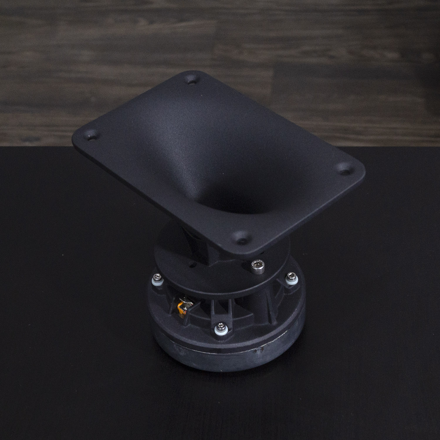

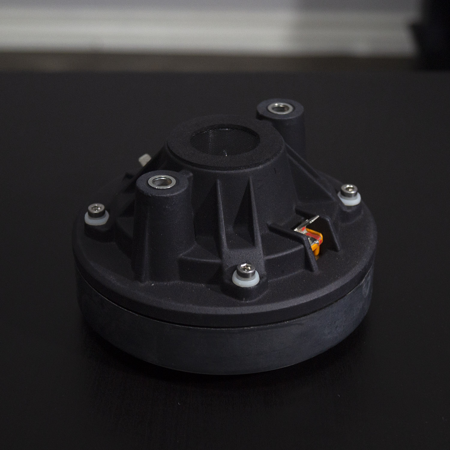

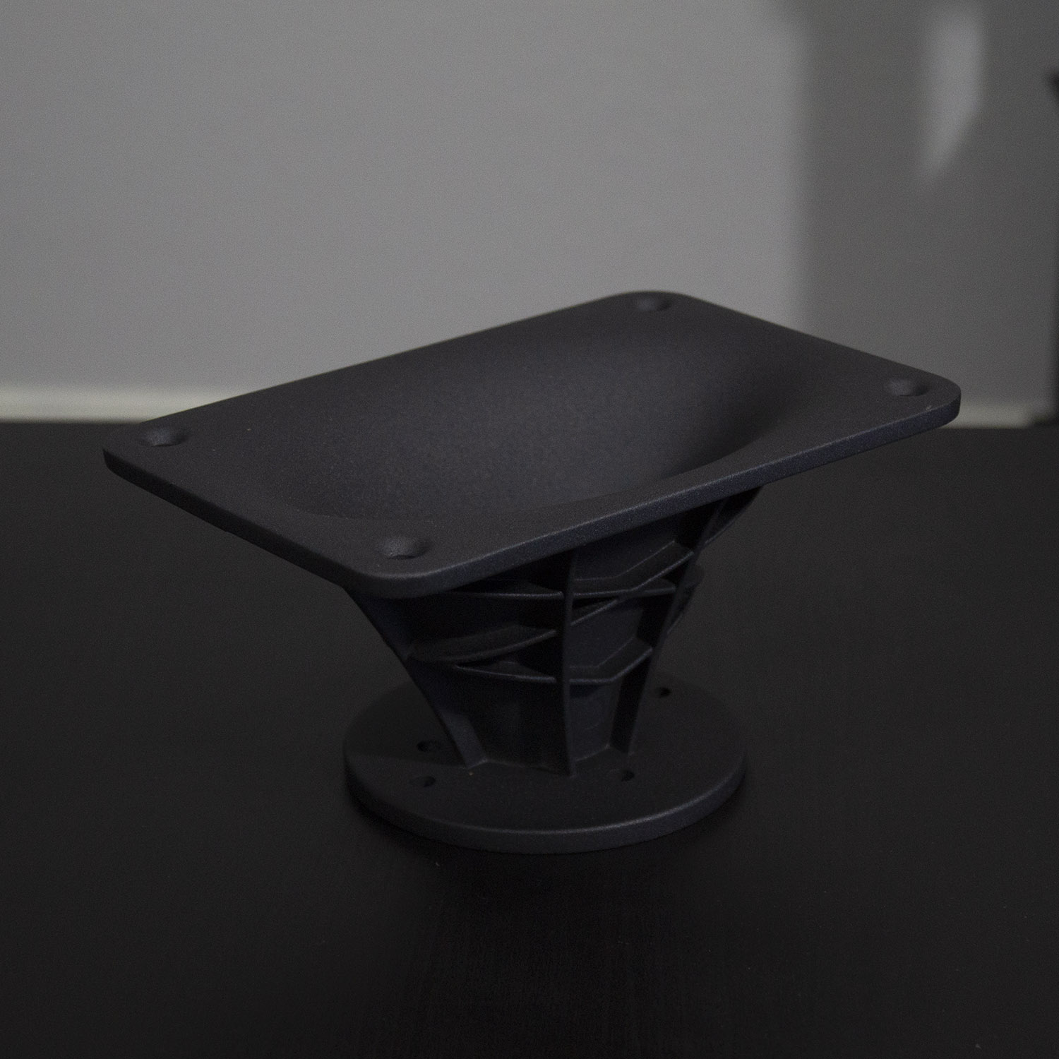

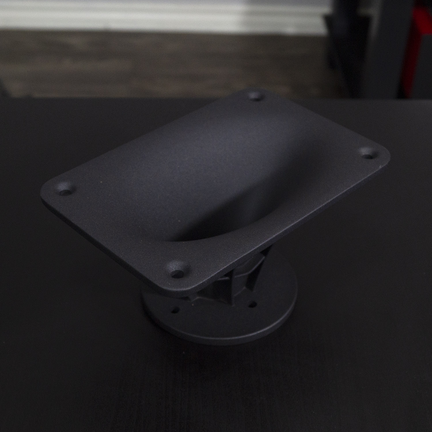

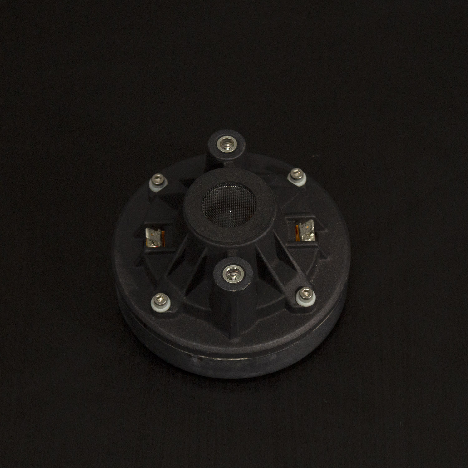

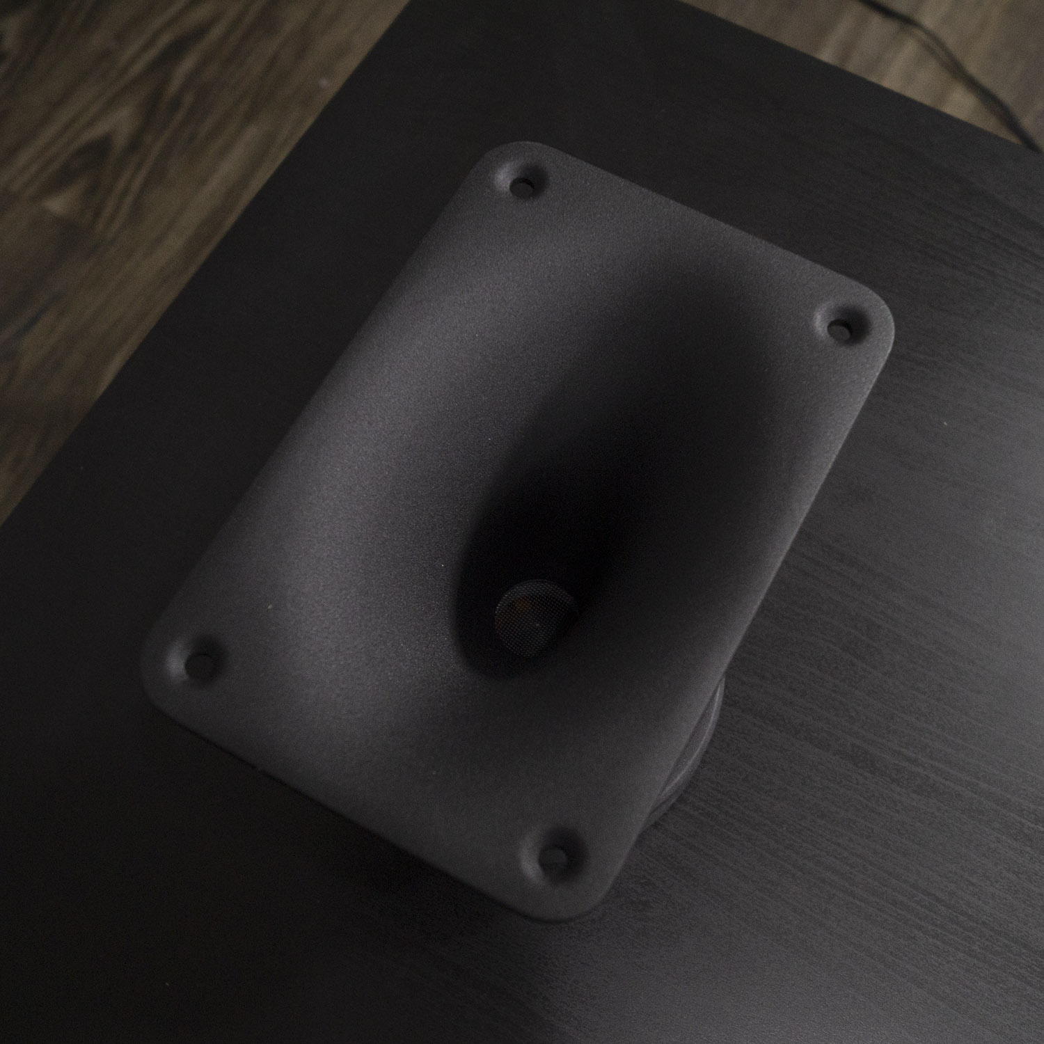

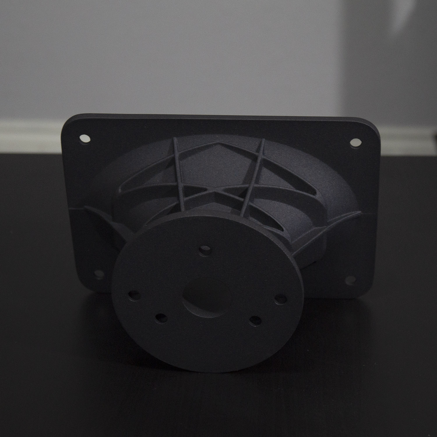

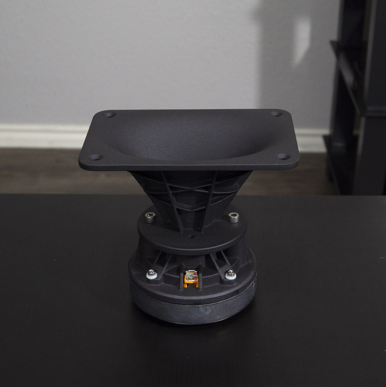

I recieved the other HF107 over the weekend, it has been shipped in different packages but the guys at speakerdirect were very helpful.
HF107 looks very well built as you would expect from Faital, it is a big CD and has some weight to it, I dont have my DATS with me at the moment, but we will do some measurements soon.
what was more impressive was build quiality of STH100, solid aluminum piece (casted of course) looks heavy duty, I will post some pics 😉
