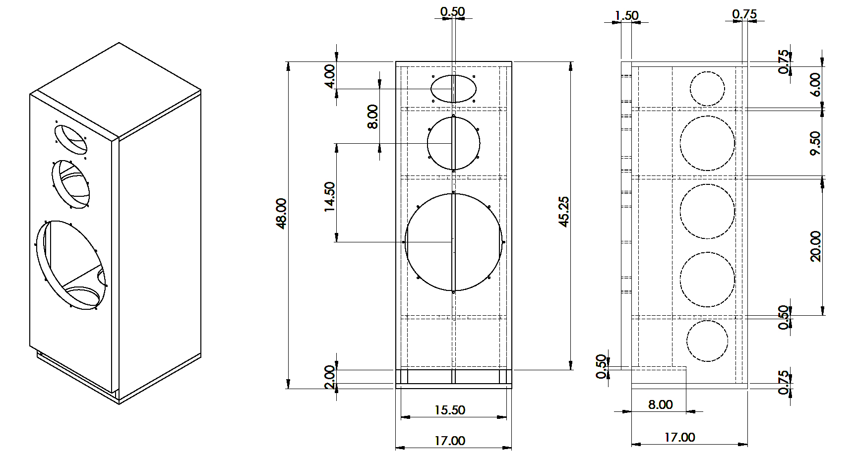

Yeah it has been a while, Life is happening and a lot have changed at my end, long story short, we moved to a new location and two 250L monstrosity would be a very tight fit for the living room, with just a foot or less away from the walls and each corners, and most important it will not be approved after the wife realizes the actual size of the speakers !
The reason I haven't brought this up before is that I wanted to find a solution before start tossing ideas around again, or me having to abandon the project.
The only option for me would be to reduce the foot print, making the front as narrow as possible (with about 15mm or less from the woofer edges to the sides) which I m not sure if it introduce new issues, also the height is limited to 47" (119cm) due to available sheet size of 48" and my limited tools and woodworking skills, so this will reduce the cabinet volume to original 150 liters we had in mind, which is not bad and I don't see any other way that I can make it work.
option number two is to sell the drivers and start over.
thoughts?

I have thought about a sealed box and to use a sub (or subs) to cover the lower octaves, the AE TD15Xs need a 94 liter box for a q of 0.7 and it will go to around 60Hz for f3, 94 liter+bracing+other drivers wouldn't be much smaller than original 150 Liter in mind and it still need another set of driver(s) and amp and DSP to run the subs, so yeah, not convenient, with a net volume of 150 liter bass reflex box tuned at 30, the TD15Xs can breath a little & can go down to 37Hz and hopefully to 30Hz with some EQ which will make me happy, unless my cals are wrong.

Sorry if I was not clear, I was talking about the sealed option because it was mentioned in previous post.
What I was trying to say was that sealed option is not ideal here because of the reasons I mentioned.
Right now i m looking at a 150L net volume bass reflex box, if I remember correctly the original design for TD15Xs was 150L also before we decided to go with 240L "Extended Bass" version.
let me know what do you think of 150 liter bass reflex box, nothing else is changed.
So far I have participated in this project, same as the rest of you, but due to my new limited space I simply don't have enough room for two 240L titans, I would be happy if someone can take over and continue the project as it was planned, supposing we still have people interested, but if no one else is willing to take over the build, I m willing to go with a smaller 150L bass reflex.
If you can do a 150L version, thats fine with me. If someone else wants to go 240L later, the only major change would be in the impedance compensation of the xover, which should not be a big deal.
