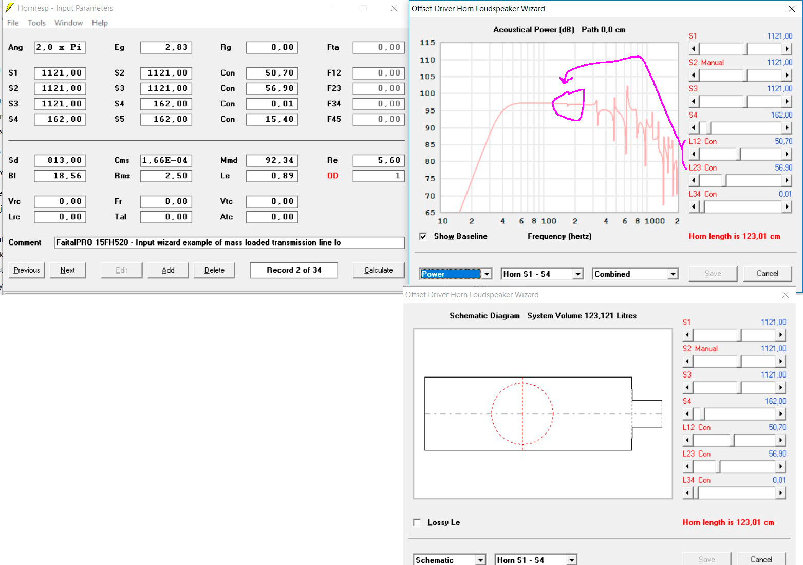

Would you mind sharing the numbers on that hornresp sim? Just a picture of the input window please. Not being lazy, but I just sneak in a couple minutes of diyaudio every now and then, packing and prepping for vacation, so very limited time for audio stuff.
... Did you include the alternate tapering top?
Hi, nope didn't include the tapering top, but one could try it in hornresp.
It is just a concept that seems to hold true with my prototype box. Use Hornresp MLTL wizard, tune parameters for your box, adjust L12 con (driver position) and see the lowest resonance come and go. Driver at ~halfway the resonance goes away, seems to be at the half wavelength on the longest dimension (attached, ~106cm height, ~160Hz lowest standing wave).
One could tame the lowest resonance with the IHA, and target some of the other resonances with the driver / port position. Thus, prototype necessary to see what the midrange leakage from the reflex port is, and then try to address them as much as needed, if needed.

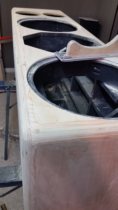

I found a baffle edge treatment picture of a 1" quarter round on a 12" midrange MTM plywood cabinet.
Note the hand sanding block.
Note no blood stains.
? Any early builder using DSP with tri-amps?
1.25 radius, 15" MTM cabinet. Hand sanding was used after router, several passes were used.
Large plywood square base screwed to stock router base.

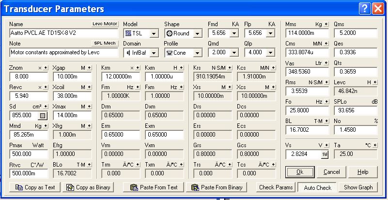

I used the TSP of the AE TD15X-8 as measured by Aatto a time ago, see Leap driver model in attach. To avoid SPL boost around 100 Hz, fB has to be chosen at 22 Hz or lower.

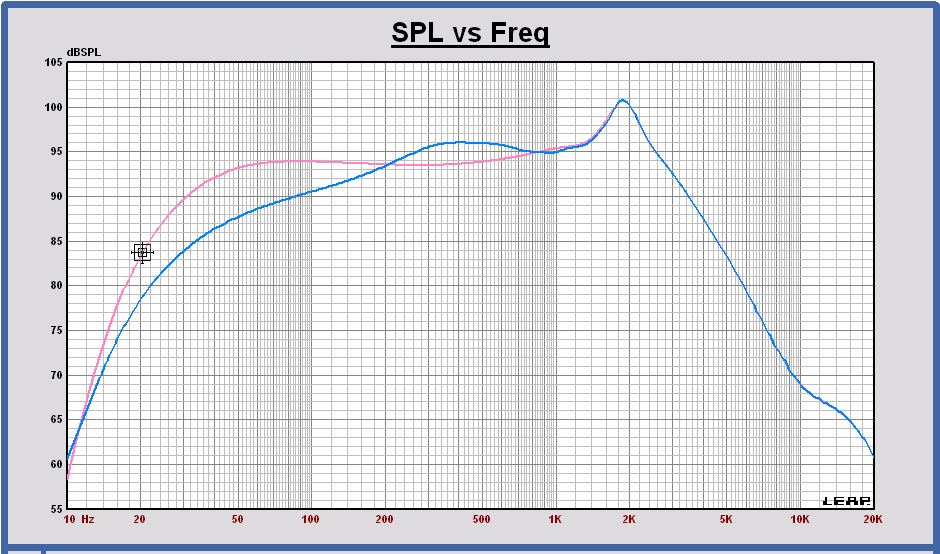

This is the result of the system simulation:
AE TD 15X-8 in VB = 180 L, fB = 22 Hz, F3 = 33.8 Hz, F6 = 25.9 Hz, F10 = 20.2 Hz.

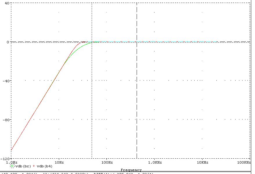

This is a basreflex system more damped than a B4 alignment at the same system frequency. See the comparison of the low frequency SPL (green) versus a B4 (red) in the plot. In attach also the SPL of the woofer system on infinite baffle (pink) and in full space (blue).
The speaker that can be designed will have a sensitivity of 88 dB @ 2.83 Vrms, 1m and -3 dB at 34 Hz, full space.
