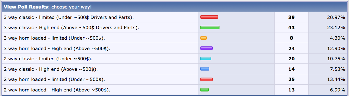

For the sake of clarity, I'd advise not to erase the first poll, rather start a new thread with a second poll and a link pointing to this thread. When the new poll results are complete, we should be able to decide what loudspeaker type(s) is/are to be designed.
:cop: I see, you initially set a 7-day timeout for the poll. I re-opened it for you, so you should be able to make edits or reset it.
Here's a screenshot of the first poll, so we haven't lost it 😀

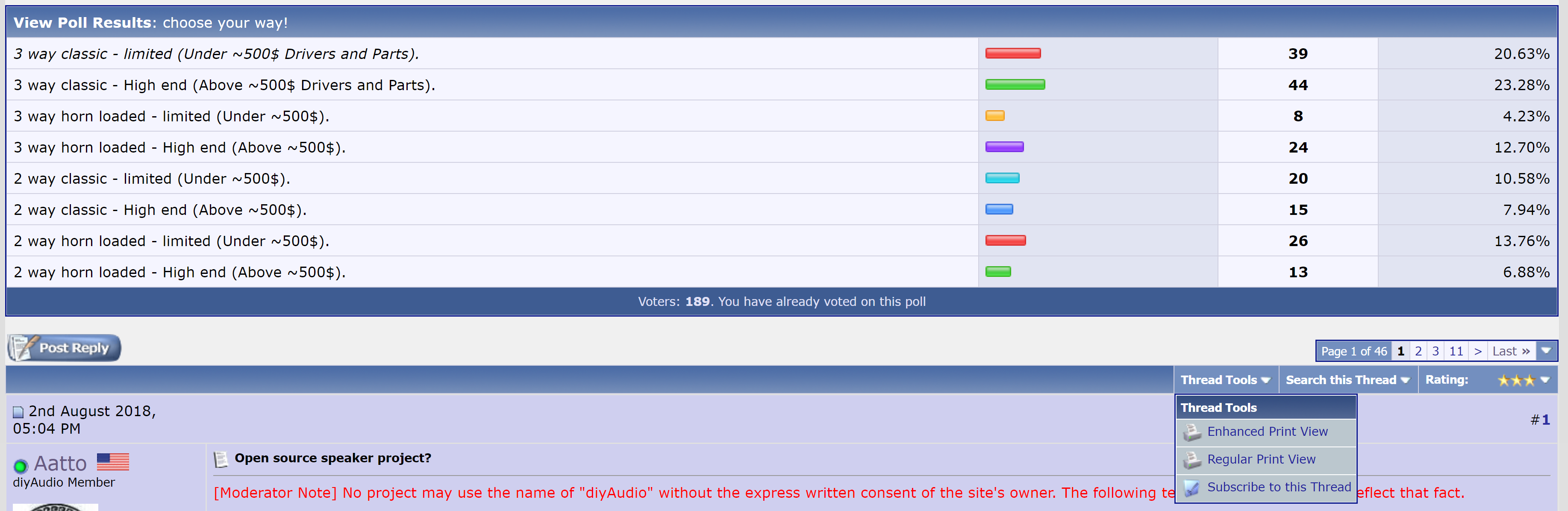

It doesn't say the poll is closed no more but there is no edit options available 😎
maybe you can add the suggestions in post #410 to the poll ? and reset it , please 🙂
