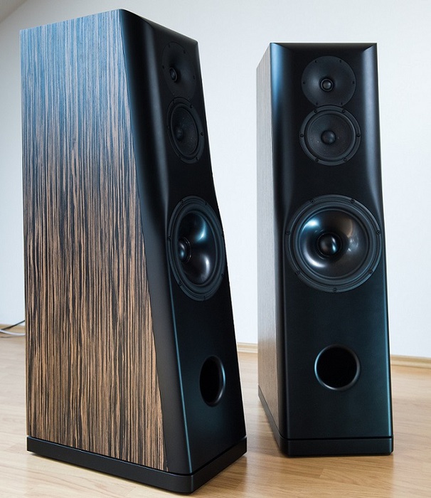

I like the idea Pida put out in post #310 (see attachment). One could utilize this Thiel like design with a single 12" woofer such as SB 34NRX75-6 in a sealed box for acceptable bass extension and not bad sensitivity. There may be other woofers that might work, but I have not found many that model well in a sealed enclosure that goes as deep as the SB Acoustic model mentioned. I'm still very much a newbie at this hobby but after building (3) typical rectangle style enclosures its time to look at something a little more unique. I will continue to follow this thread or any others that may spin off from this with great interest to continue learning along the way.

I think it would fit my goals nicely. The wife gave me the go ahead last night to start pulling supplies together to build it. I'm going to head down tomorrow and purchase some 3/4" Baltic Birch plywood. I have mids and tweeters already. So only need to purchase woofers. I can't hardly wait until the snow starts flying so I can dedicate some serious time to this build.I like it!

Montana, speakers shown on the have 90l per cabinet, so it would accomodate 2xNE265W-8 in BR, or 2xWO24P-8 in Closed cabinet with Hypex FAxxx which would enable equalization.
For the mid and tweeter there is option to implement following combination:
SatoriWG7 :: Pkaudio
or any suitable 7" midwoofer/midrange.

The SB 34NRX75-6 is specified to 90 dB at 2.8V. Subtract baffle step (3-6 dB) and you and up around 85 dB. Also, the impedance of this driver is rather low. Overall, that will NOT make good friends with small/weak amps.I like the idea Pida put out in post #310 (see attachment). One could utilize this Thiel like design with a single 12" woofer such as SB 34NRX75-6 in a sealed box for acceptable bass extension and not bad sensitivity. There may be other woofers that might work, but I have not found many that model well in a sealed enclosure that goes as deep as the SB Acoustic model mentioned. I'm still very much a newbie at this hobby but after building (3) typical rectangle style enclosures its time to look at something a little more unique. I will continue to follow this thread or any others that may spin off from this with great interest to continue learning along the way.

Yes, it lacks in sensitivity compared to others but could the designer move the woofer lower on baffle to mitigate baffle step some? The room size that these will occupy is not huge so 3-4 db loss is more like it. As for small/ weak amps, it is not my vision to go that route currently. If a bigger amp is required, then that will become my next purchase. Lastly, I'm not hung up on sealed vs. ported. It is the fact everything that I have built thus far has been ported and it is time to try something different. Simple as that. My goals may venture away from others here because I'm not ready for the more complex builds like the Yamaha NS5000 but I want something different then what I already have. It does not seem practical to expect that everyone will agree on every facet/ consideration of speaker building. I'm still a novice here but it appears that no matter what there is compromises when it comes to speaker building. For me, getting the bass correct and to my liking has been the most challenging. Thus, I'm ready to try something bigger in a sealed box to achieve the dynamic bass I'm after. If I want something polite there is other speakers in the house to listen to. I want this beast to 'Rock'!The SB 34NRX75-6 is specified to 90 dB at 2.8V. Subtract baffle step (3-6 dB) and you and up around 85 dB. Also, the impedance of this driver is rather low. Overall, that will NOT make good friends with small/weak amps.

Thanks for the added info Pida. I was most interested in using this design as a guide with slight modifications to size but not an exact clone. I already have some drivers that need a home. Midrange: Sb Acoustics 15MFC30-8 5". Tweeter: either Dayton RST28A-4 or SS R2604/83000. So, all that remains for driver purchase would be a suitable woofer (preferably a 12" woofer). Seems like it would make a nice enough Classic 3 way.
