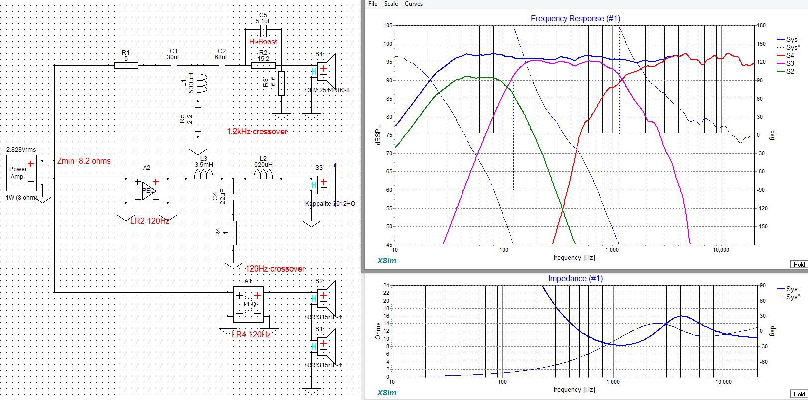

Attached feasibility XSim3d simulation and a few example construction pictures from the Tweek Geek website.
The Eminence Kappalite 3012HO was selected for the midwoofer based upon the $188 price, datasheet measurements and user feedback. Open discussion of under $200 alternatives midwoofers is invited.
