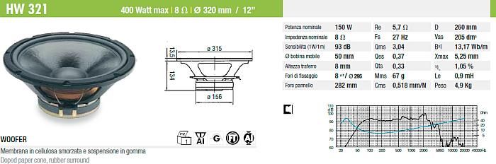

fs of its bigger brother (12") is 27Hz, but a large Vas of 205.
I don't find a Ciare 12 inch driver with these parameters, which is the type number?
I found the Ciare 12 inch FXC 12-3. In a 80 L basreflex tuned at 45 Hz, the F3 is 45 Hz and the full space sensitivity is 90 dB.
The volume can also chosen smaller, in a 65 L basreflex cabinet tuned at 48 Hz, F3 = 48 Hz.
Interesting driver for some concepts.
