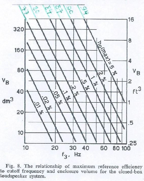

Same figure for a closed box. Not much work to post that one also.
If you compare, a closed box speaker with VB = 80 L and F3 = 40 Hz shows a typical sensitivity of 87dB full space. That is 3 dB less than the vented box with the same VB and F3 parameters, see in previous post #500.
Maybe better to say it in another way, a driver with a sensitivity of 93 dB half space in the data sheet, has a F3 = 40 Hz in a cabinet volume of 80 L, sensitivity 87 dB in full space of course.
