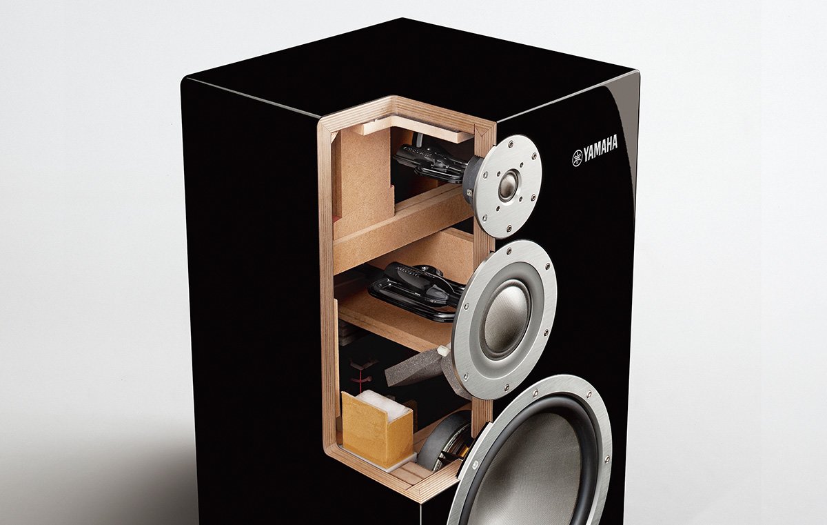

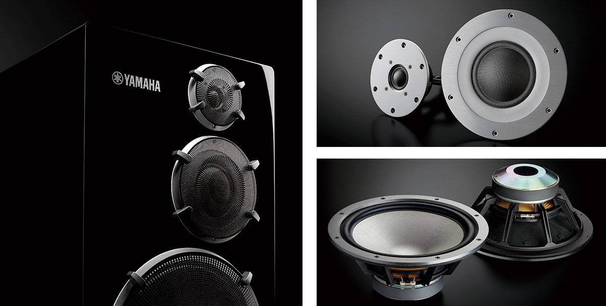

Yamaha NS 5000
I bet this one would have found a few fans that'd consider building it.

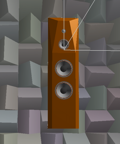

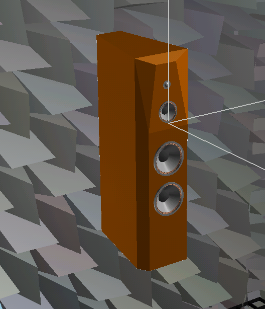

A few years ago I made a design with a Sonus Faber front look for someone. Because of a lack of time it has never been build.
I post it to offer some ideas.
It is a three way with 2 x 8 inch woofers, 5 inch midrange and a 1 inch dome tweeter. It has a Sonus Faber front look. A little inclination backwards of the midrange – tweeter baffle.
Dimensions W x H x D = 32 x 115 x 56 cm. See attached figures. I should make the cabinet less deep now.
At that time I had chosen 2 x Eton 8N402 woofer, Accuton C90 midrange and Scanspeak Be tweeter D3004-668000 tweeter.
I should choose other driver types, because this set is rather expensive. But keeping the combination 2 x 8 inch woofer, 1 x 5 inch midrange and 1 x 1inch dome.
Choosing the crossover midrange - tweeter around 2 kHz. In that way with the 5 inch midrange, there is no real need for a tweeter wave guide to keep the power response flat (constant directivity).
Some specs taht can be created with such concept:
- Overall sensitivity around 90dB @ 1m, 2.83Vrms, choosing the appropriate drivers.
- F3 around 40 Hz; woofer closed box system. For a woofer operating in the low medium frequency range I prefer closed box.
- Maximum SPL depends on driver choice w.r.t. maximum excursion and power of the driver, especially the woofer. I will calculate that value again to give some idea.
- Crossover: 400 and 2000 Hz to realize a flat power response above 400Hz.
- Crossover can be an analog and/or a digital design.
All types of crossover can be designed, Butterworth, Linkwitz-Riley, elliptical,… low and high orders. All to be defined.
Very interesting to compare different filter topologies using a digital implementation.
If the concept is defined (cabinet, driver choice, crossover type) a complete concept study can be done, starting with the driver data sheets and a first cabinet drawing. SPL, impedance, power response of complete system, excursion plots, needed amplifier power, SPL at maximum excursion, horizontal and vertical responses can be simulated.
It gives a very good impression of what you can realize with the chosen concept.
When building it, drivers have to be measured carefully on IEC baffle and later also in the cabinet. At least one of these measurements has to be done. With these measurements the final design can be made.
These are all just ideas. I am prepared to give my input to a design.
I should say, shoot on it. What is good, what has to be changed,…to come maybe to an accepted concept for more people…
Anyway once the concept of the speaker is defined, it has a lot of sense to do a complete concept study in simulation. I can help with that.
Paul

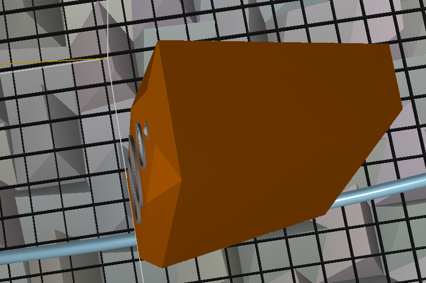

Hi Paul
Cool! The way I see this project is that we are trying to come up with a design for a high-quality speaker that is an easy entry for newbies or less experienced DIYers. This means the enclosure should be easy to make. The large bevels on your design may be a bit on the tricky side for such builders.
I think bevels/chamfers are usually not acoustically effective anyway (except maybe towards the upper end of the audible spectrum). Siegfried Linkwitz writes "With most speaker cabinets the radius or chamfer is acoustically too small and is primarily cosmetic.", and he has extensive measurements on baffle diffraction here. My own measurements seem to support this, and I also confirmed that the typical baffle diffraction issues with flat rectangular baffles can be avoided by placing the drivers asymmetrically on the front (golden ratio is king!). See here (sorry for the German, but I hope you get the point -- just ask if it's not clear). A simple flat and rectangular baffle is not acoustically worse than a chamfered baffle, although the marketing departments of the big audio companies may say something else (I believe they do it because some people like the looks of large chamfers).
In any case, I'd vote for a simple flat front that is easy to make, allowing an easy entry to the DIY world for newbies.
Hi Mbrennwa
I agree to keep the cabinet simple.
Concerning the bevels, for that speaker I have chosen very smooth edges for the bevels around tweeter and midrange, see the top view in image 1. The radiation is not bad and better than a front with only 90 degree edges.
Simulations in Leap (it has a good diffaction simulator) show that a slow curved front to the sides has a very good radiation pattern.
If you make a front with a top view like shown in image 2, there is already a lot of improvement compared with only 90 degree edges on the front.
I think that such front is not so complicated to built.
Placing the drivers asymmetric on the front is a solution on axis. Off axis there is still a problem. It also makes the horizontal radiation pattern asymmetric, I don't like so much.
Paul

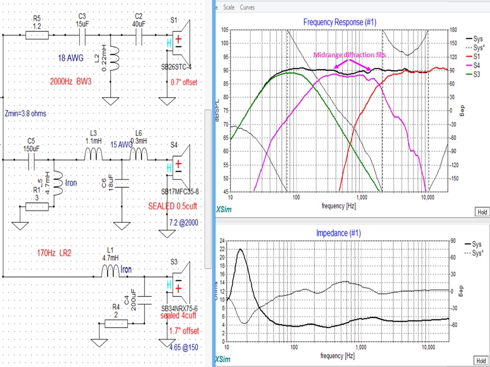

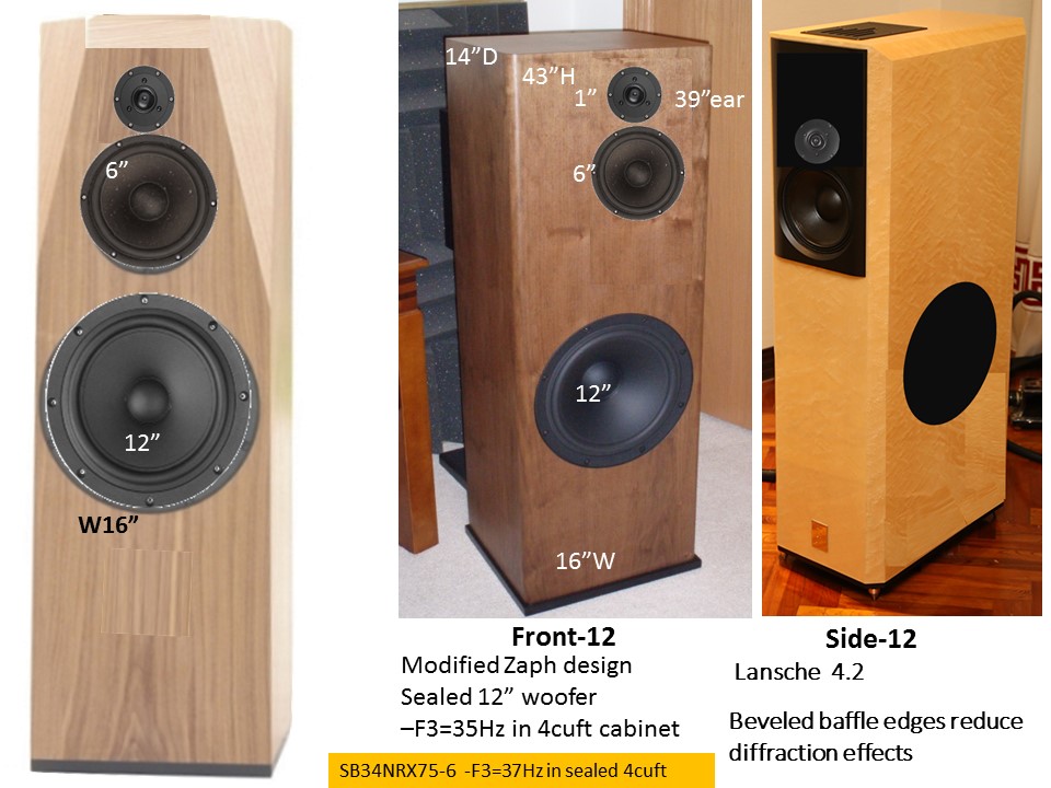

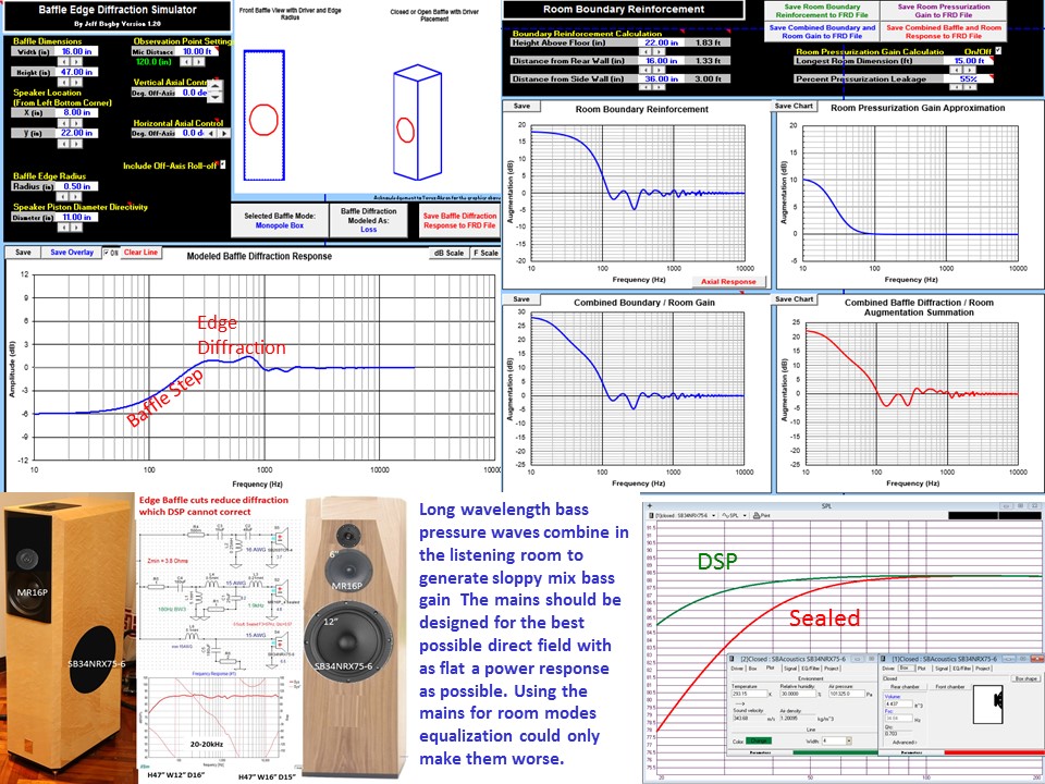

I would like to se a regular square but well made and easy to build box. Good quality drivers, a 12" closed box bass, 6.5" mid and a tweeter in a small off the shelf wg to nicely match directivity to the mid. A crossover for regular placement but also one with minimal or no bafflestep for near wall placement.
Good quality drivers, a 12" closed box bass, 6.5" mid and a tweeter. A crossover for regular placement but also one with minimal or no bafflestep for near wall placement.
The $172 SB_Acoustics 12" SB34NRX75-6 with an Fs of 19Hz is designed for superior transients from sealed woofer operation, and models to -F3 ~ 36Hz in a 4cuft sealed volume. Google Zaph SB12.3 kit documentation. This MTM-W box can be modified for TM-W
A low diffraction Avalon-style cabinet is a basic box with a 2x-3x thick front baffle with 3 deep top bevel cuts which can be done with a hand saw. Since a 3-way woofer crossover will start at -F3 ~150Hz, this 12" woofer can also be mounted on the side of a narrow cabinet.
Based upon your budget, the midrange could be the $72 6.5" SB17NRX35-8 (or polycone SB17MFC35-8) or the Satori MW16P-8. Using NdFeB, the $33 1" dome tweeter SB26STCN-4 has a 2" diameter body which reduces C-to-C lobing effects. The $53 1.1" SB29RDC-4 dome tweeter has several proven lower frequency crossovers to the SB17NRX35-8. You will find diy-members with completed 2-way SB17NRX35-8 + SB29RDC-4 who will want to just add your woofer design.
