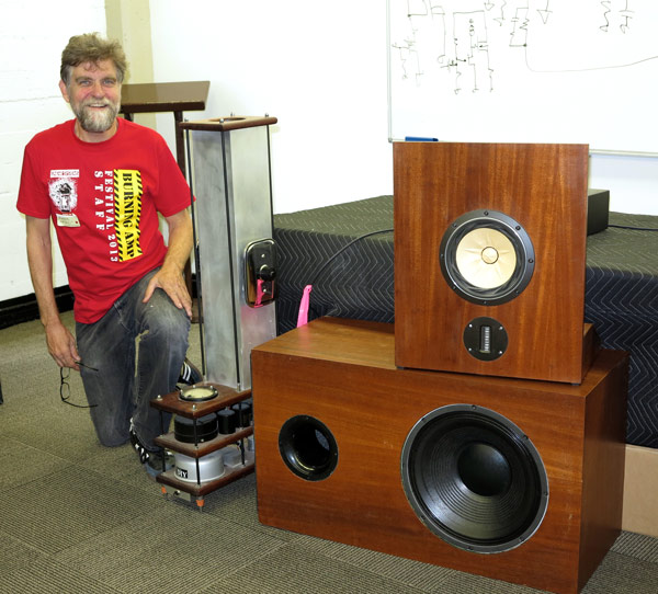

This is Basszilla, right? (Open baffle 2-way using a planar tweeter plus a 7 inch mid, with bass cabinet below)

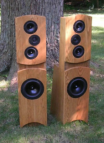

What do you think of the Undefinition Sunflower as a general layout, but instead with a planar tweeter and a single mid-woofer?
Sunflower [Redux] - undefinition
Yep. Variac posing with his kit. I guess this is the 2nd gen, those are 8” Fostex FE208E∑ mids.
