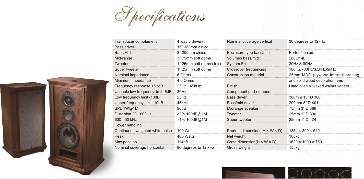

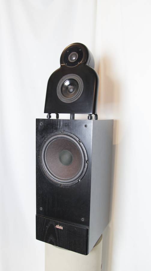

Aatto: Everything you want is in one of the Alóns, just pick your sealed bass woofer and cabinet width.
I remember the larger Alóns (model 1?) had one sealed 12 inch, and it was around 92dB sensitivity iirc. and a friendly 8 ohm load. I heard their open clean sound often in my friend's dedicated room with Mark Levinson upstream.

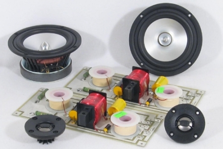

We could use the Zaph ZA5.2 drivers and xo as the foundation for the top 2-way portion (although these will be more like 87dB/W), but in an Alón or Nola type OB sitting on top of a sealed box woofer below, sized to the builder's tastes, so 1 or 2 eights or even a twelve.
Zaph|Audio - ZA5 Speaker Designs with ZA14W08 woofer and Vifa DQ25SC16-04 tweeter
Zaph|Audio ZA5.2 TM 2-Way, Pair
Besides, how is the ZA5 not the ultimate indecisive beginner's project? Cheap, unpretentious, and scalable, sealed or vented...
What needs improving on here, or what would you want different, Aatto?
We'll even rip off the name and call it 'ZAatto-5.'

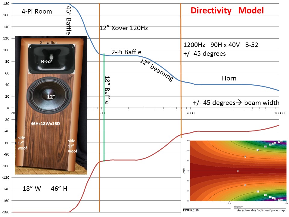

Parts Express has an excellent buyout waveguide.
The BMF1 speaker custom-built by Tweek Geeks has received high praise in public shows. The use of two-sealed, near-floor, side-side, counter-force, DSP-controlled woofers provides a BIG-BANG in a medium size cabinet. The Tweek Geeks website has several construction pictures,
HIGH-watts to two 24Hz equalized 12" woofers allows a modest total 5cuft cabinet that fits many homes.
$13 B-52 PHRN-1014 1" Horn 10" x 14" Bolt-On waveguide
Model: PHRN-1014|Part # 299-2303
$63 Peerless 1.75" DFM-2544R00-08 compression driver
$188 Eminence KappaLite 3012HO Midrange:
TWO $146 Dayton RSS315HF-4 12" woofer (two in series = 6.2 ohms)
$560 for drivers

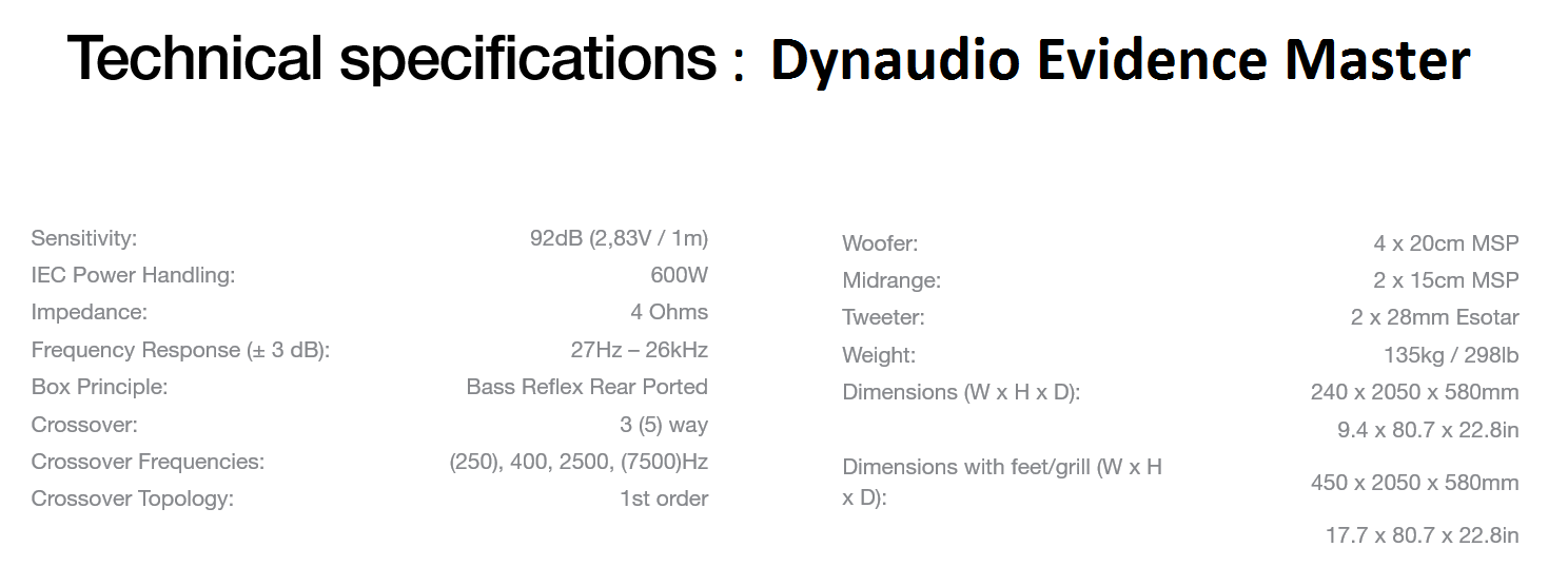

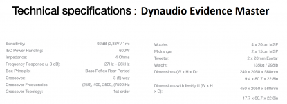

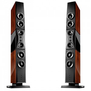

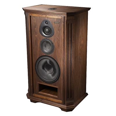

What do you say to building these gems?
We could scale down the speakers to meet our criteria more closely, to decrease the expense and enclosure volume.

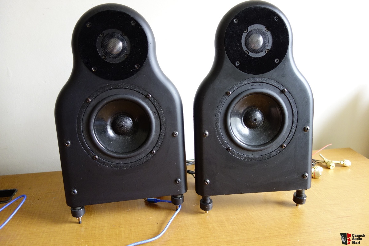

"Monkey coffin" / "monitor" format (similar to Yamaha NS 5000 etc.)
single 10" woofer*, cone midrange, 1" dome tweeter
flatish 8 Ohm impedance curve
efficiency > 92 dB/2.83V/1m
(* two smaller high-quality 8" woofers per box will be more expensive, leaving less money for the remaining drivers, x-over parts, and enclosure)
