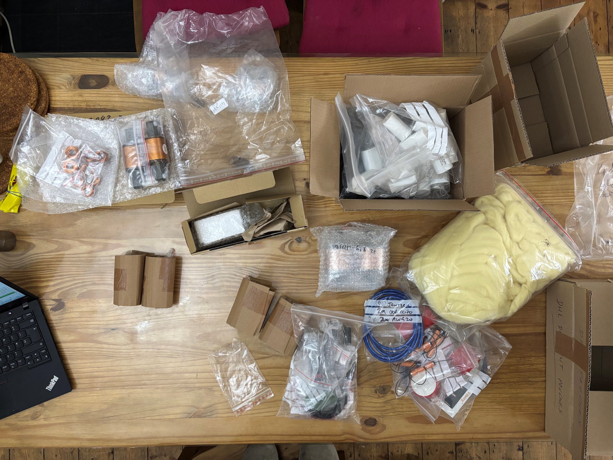

Wow I didn't think the crossover parts would be that expensive - @maximax77 Did you use "audiophile" capacitors, etc? I think I am correct in understanding that you that there can be a wide price range for the equivalent value capacitor
One can pay much more for crossover parts, take a look prices for duelund cast capacitors and inductors. I included the parts list so that people can compare with the recommended list in the OSMC doc. However, the price estimate there is now way too low and it would still have come to lower 4-figure if I had chosen those parts. Many part numbers on the doc are now outdated but similar parts are obviously available.

I opened a Duelund capacitor, so you don't have to do that 🙂 I thought that Duelund capacitors are physically bigger than Jupiter Silver Foil -Vitamin-Q because they have more foil and are better quality, but I was wrong. I found a ton of epoxy instead. The manufacturer could fit to 15mm diam package as 0.01uF, But for some reason he did't. I wonder what the real size of 0.01uF.. Overall these are great capacitors, I have no complaints about the sound quality
