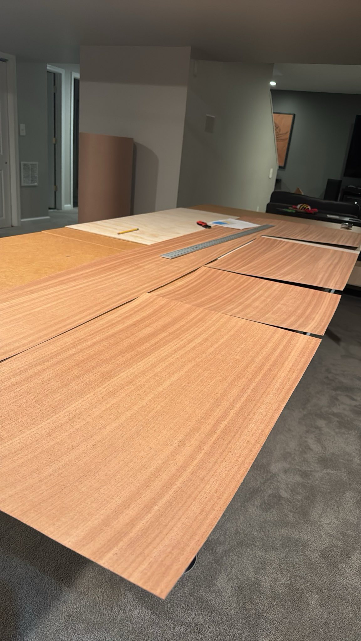

Progress update.. Will post some more pictures soon.. Very productive shop day last week. Plinth's built, backs cut, front baffles finished and attached to cabinets.
Cabinets back to my house for the veneer process. Some stumbling along the way with that process. Initially, I ordered a 4x10ft sheet of "flat cut" veneer. Thought that was enough, but came up ever so short considering the plinths that we built. So I ordered another sheet of 4x8 and mistakenly ordered the same species, but "quarter sawn".. When that sheet showed up I thought "WOW!".. It looked so much better.. So, another order in for a second sheet of quarter sawn veneer. Spent today measuring and cutting all of the veneer panels from the 4x8 veneer panels. Fairly easy to cut the paper backed veneer with a sharp utility knife. Changed the blades a few times as there was a huge difference in cutting with a sharp blade vs one with 8-10 cuts on it. Will start tomorrow with veneer attachment. Probably 2 more weeks with this, then back to my friends shop for finish work. Final assembly after that and it'll be "Music time"!

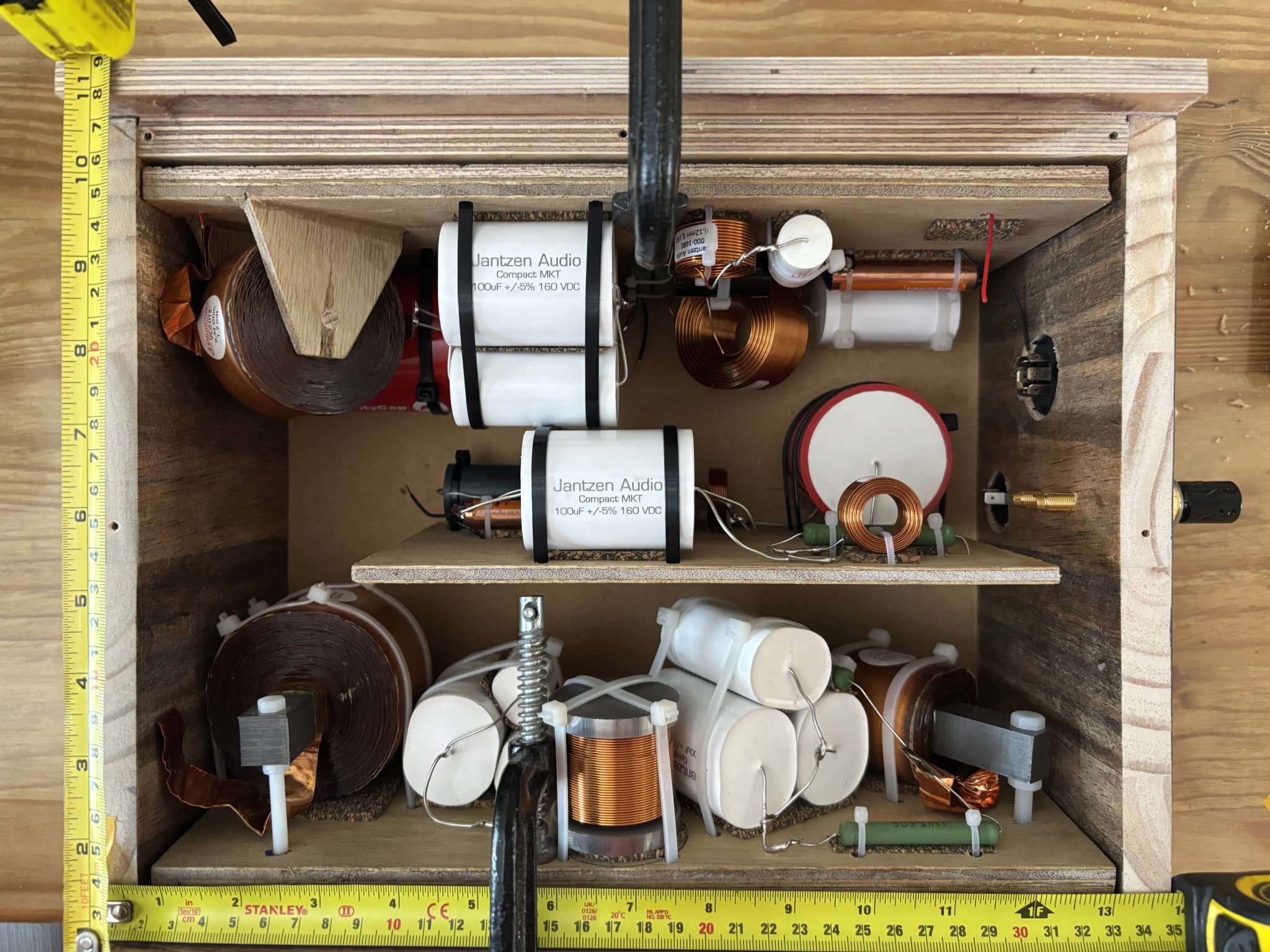

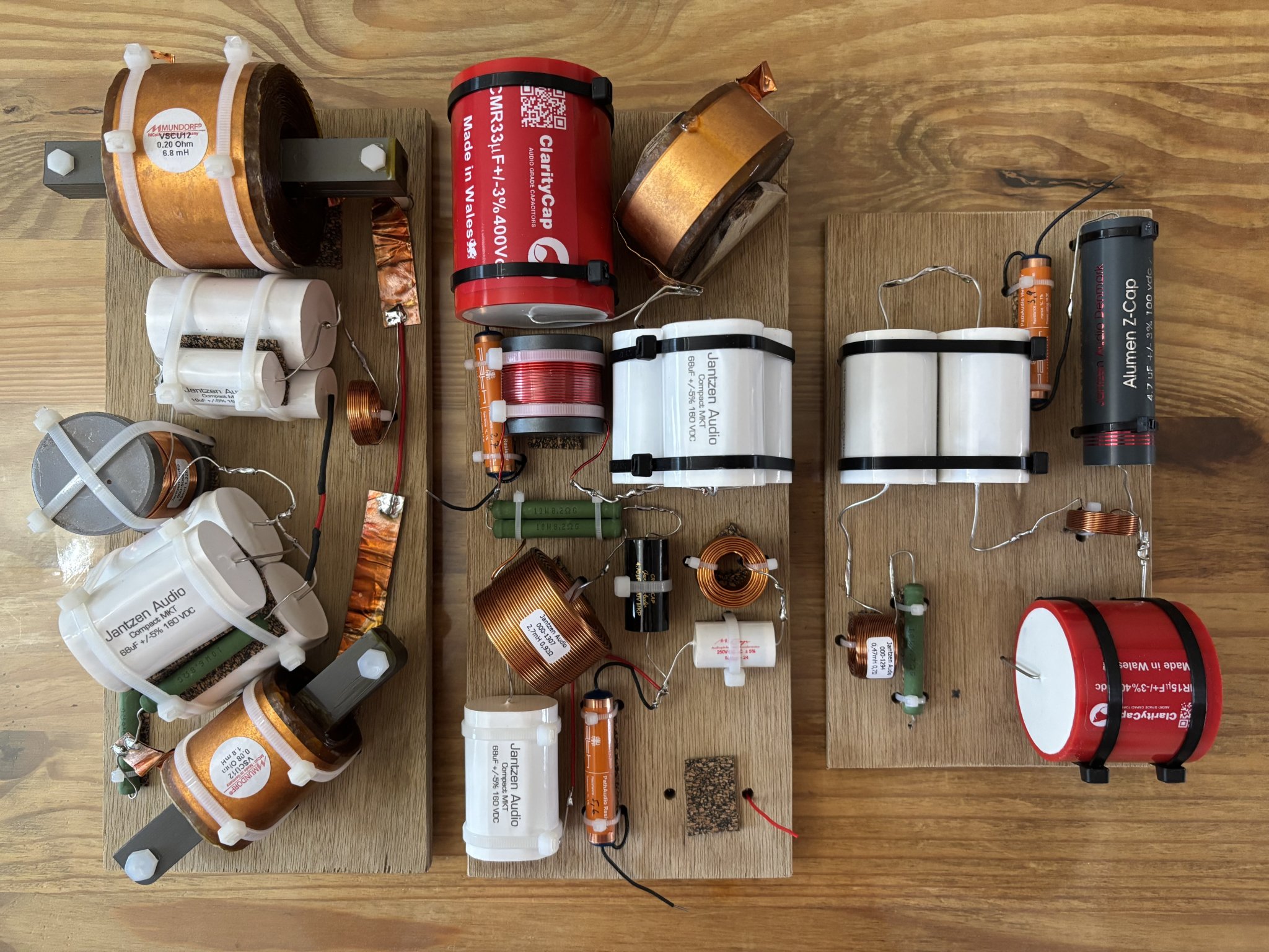

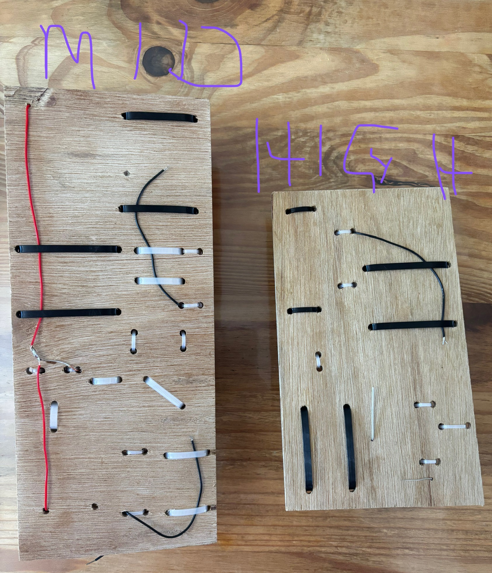

I am in the process of soldering the crossovers, below are the three boards for one channel. Lm2 and Rt2 are not yet mounted, the idea was to put the latter on the back of the board and then add an opening with a lid to the box so that Rt2 can be changed more easily.
The woofer board does not have connections on the back, but the others do:
The case shown below is lying on its side, the woofer board will be at the bottom. The idea was to mount tweeter board to the side which is lying down in the photo, but it doesn’t fit. So I placed it as shown:
How do the coil distances and directions look to you?
@maximax77
Coil orientations look good. Distance is always your friend as you know. And I actually really like your selection of crossover parts. There are areas where you do spend the money and there are areas where you don’t have to when you are building up this level of crossover. The decisions you have made are judicious. We are way beyond the industry standard of sand caste resistors, electrolytic caps and ferrite inductors here.
I would give some thought to doubling up on some wires to lower the AWG particularly in the woofer circuit or just use a wire AWG that is nearly commensurate to the AWG of the woofer inductors. In example, the wiring that goes from the binding post to LW1, the wiring that is between LW1 and LW2, the wiring that goes from LW2 to the woofer + voice coil and the wiring that forms the return from the woofer - voice coil to the negative binding post should be a thicker AWG. Since we are already guilding the lilly with this speaker project especially with foil inductors and such, might as well go all the way.
I don’t know how attached you are into putting all your XO components into a ‘box’ but I am actually in the middle of a XO build right now and I have splayed it all out into the open, it makes it easier to minimize inductor interactions - Just saying…everybody’s scenario is different.
And great job on the neatness and wiring.
