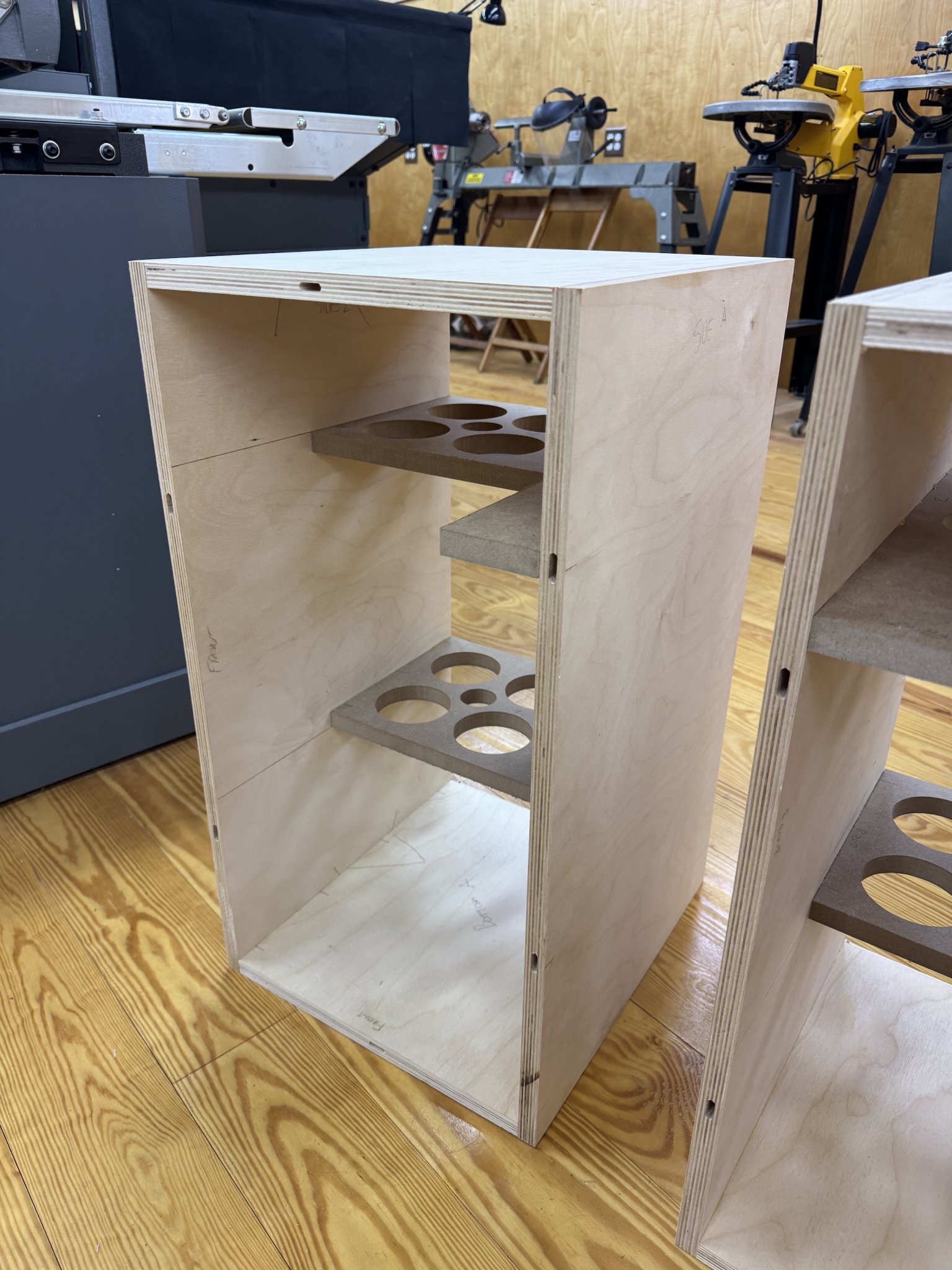

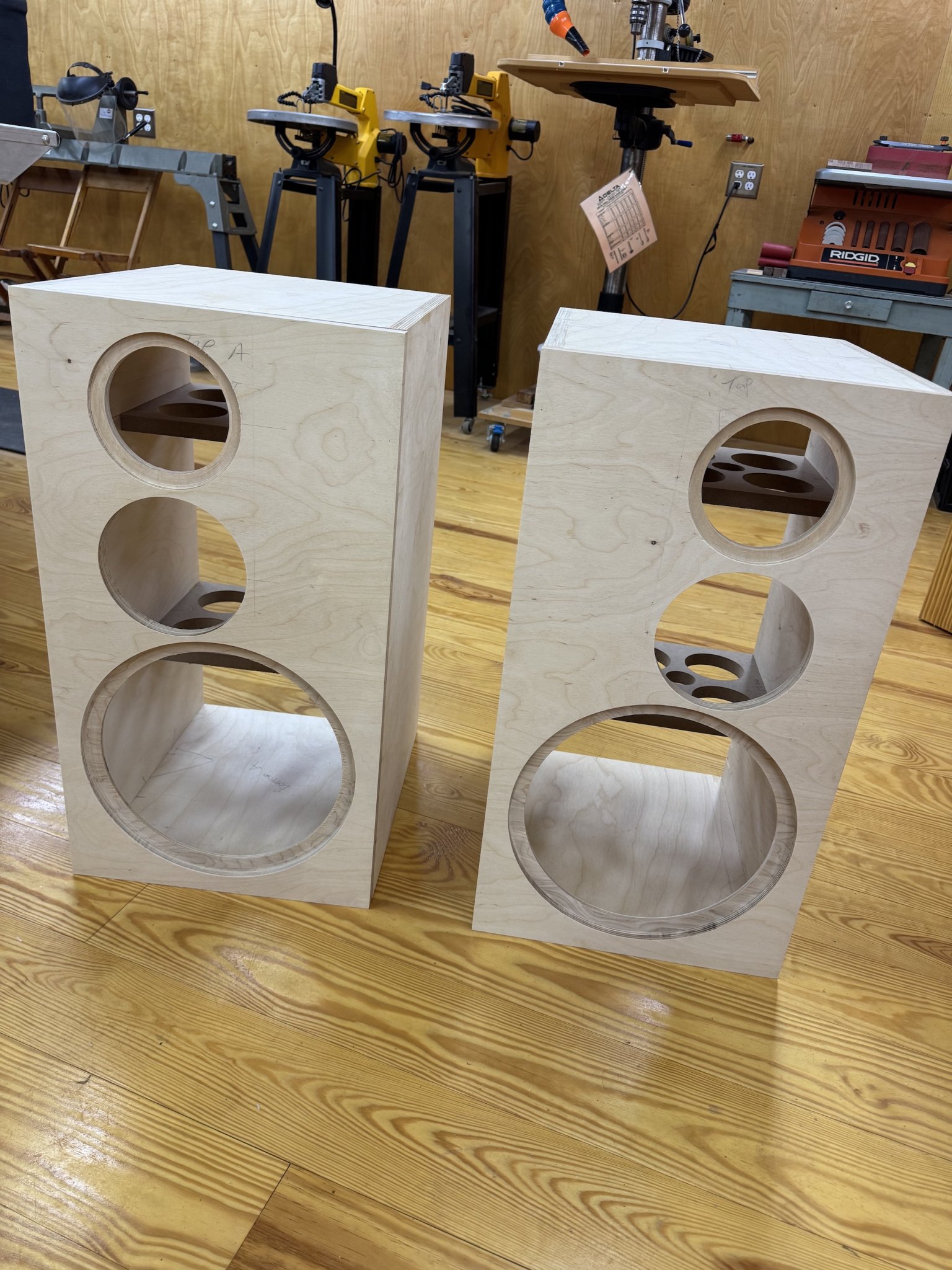

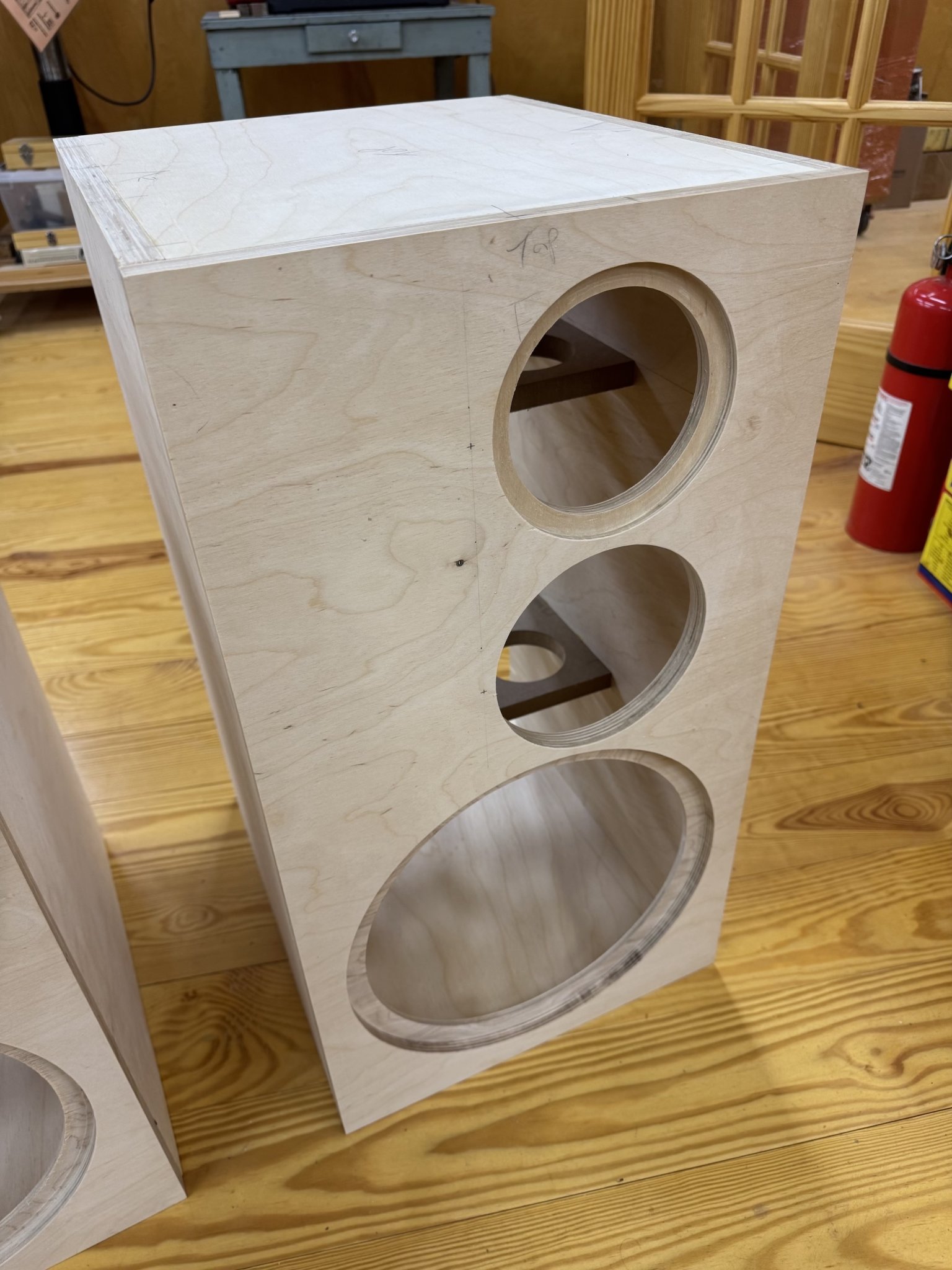

Progress update for this week.. Spent a good bit of yesterday working with my friend, Mark on the cabinets. We spent a few hours mixing various dye possibilities for the finish on the veneers. Still working on final solution for that. The rest of the afternoon was spent cutting front panels and getting driver holes finished. We cut the front panels slightly oversized, than used the router table with flush cut bit to get each panel to fit perfectly. Cut domino holes, next then on to the speaker holes. Back panels are up next then glue up of panel, and likely begin the veneers soon after that. We still have to finish the plan for the plinths and get them going.. This has been such a fun project with lots of "mini projects" along the way. Can't wait to listen to them with my Pass M2!
I was thinking the same thing - I have a Router and not much else - But great work and thanks for posting the pictures it helps clarify the process.
My wood is on the way. Post pitures of the Veneer process because I don't have a clue about that -- I am learning as I go
@tbrooke You're welcome, I'll continue to take pictures along the way. As far as tools, I"m in same boat.. Handfull of "weekend warrior/happy homeowner" tools, and that's about it. Did you order the large sheets of uncut ply, or did you order and have pre-cut like @Sorenm did?
Veneer process will be interesting. I"m going to bring the cabinets home and attempt to tackle that part of the process on my own. My friends shop is a 45 min drive from me and we are lucky to get 1 day per week to work on these. So the veneer process would take a LONG time if we do it together. I'll admit I have a little anxiety over that part of the process myself!
Sorry to say so, while doing a nice work, very often wood-pro's don't take bracing serious. Even with the two braces the open surfaces will ring like bells.
I don't really need to engage here... but ...curious if you have heard these speakers in person—or built them—or looked at the paper on them? What's the relationship between wood-pros and bracing? Or perhaps, how one might objectively measure "ring" related to a baffle? (In this case where the dimensions of all components and cabinets and related build factors are extremely tight dimensionally and a ton of analysis has been done—see paper).
Not defending anything here—To each their own—I suppose I just like to read comments that are constructive since I always learn things and maybe we all benefit? And it's a Herculean effort to build these....

MaxiMax77, I'm a bit confused by this. I'm arguably clueless when it comes to designing speaker cabinets. Are you and Turbowatch seeing something in my execution of the OSMC plans that is incorrect, or are you just in disagreement with Matthias work on this project in general? What does "Wood pro" mean and how does that correlate to a lack of knowledge regarding cabinet design? Could there be someone who is knowledgeable about woodworking, and also cabinet design? Are these mutually exclusive? I've not read anything from anyone who's built these who hasn't been thrilled by the outcome in terms of their sound.

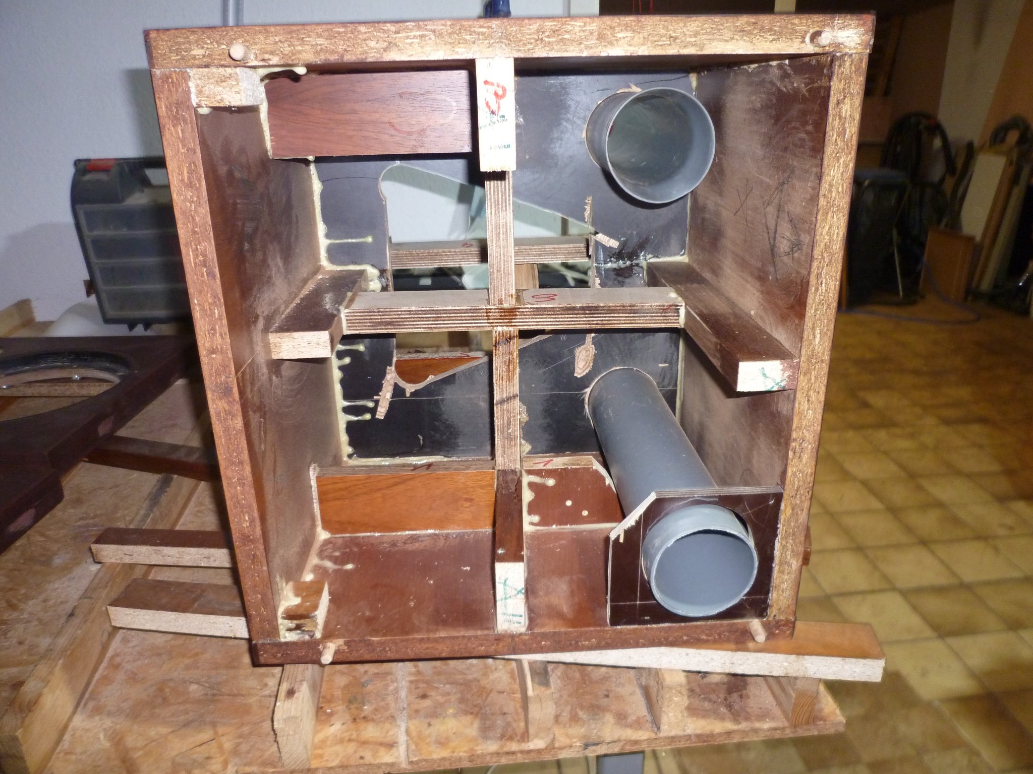

I know that some oppose serious bracing cabinets for various reasons.
In general people that are used to build things from wood have some very realistic views how to do that. So if they build a toy house for children they will make it stand that abuse, a living room table may have another kind of strength. I have been working with carpenters for many years and know how they "see" solid. From their practical education they do not understand that a box that can even stand the weight of an African elephant, may resonate when used for sound reproduction. In most cases they go for stronger walls if you tell them to make it more "solid". The concept of reasonable panel thickness and stripes applied to the inside makes no sense in their world, as it does not improve any of the the criteria they see and have been taught.
The complicated braces we see in many builds often are copied like godspell, while the concept of consequent and simple bracing is not understood. This is not limited to wood pro's.
If one ever build a speaker cabinet with a matrix like braceing, he will be surprised how solid and acoustical dead someting like 3/4" fibre or paricle board can get. Just some boring stripes of wood material consistently glued on any inner surface, dividing them into squares and rectangles of different sizes. No fancy design or secret formula, just plain simple work and a usual material. Inexpensive and easy to do.
If you tell someone you can tell where to put braces, just by knocking& listening, this is often meet with laughter. Sure you can start a finite elements analysis or attach accelerometers, but in the end you want to build something made for listening, so why not listen to the object?
This specific box design for the OSMB is as good as many expensive, well known brands will make cabinets, but far from resonace free. The braceing is the extreme minimum, made acoustically transparent inside, simple to build and of low parts count. Just knock on it from the outside and you will hear how the sound changes over the surfaces, from solid to hollow and resonant.
Sure, the speaker will work, but with more narrow, simple stripes, the bass will be tighter. This is just a simple fact, which anyone can proof by trying. It works for closed and vented cabinets.
I attach a picture of a subwoofer that has some very simple and cheap braceing, calming down low frequency resonances. This example is not the optimum, but will work for the cause.
PS this sub is build from recycled wood and leftovers. The outside is very nice verneer.
