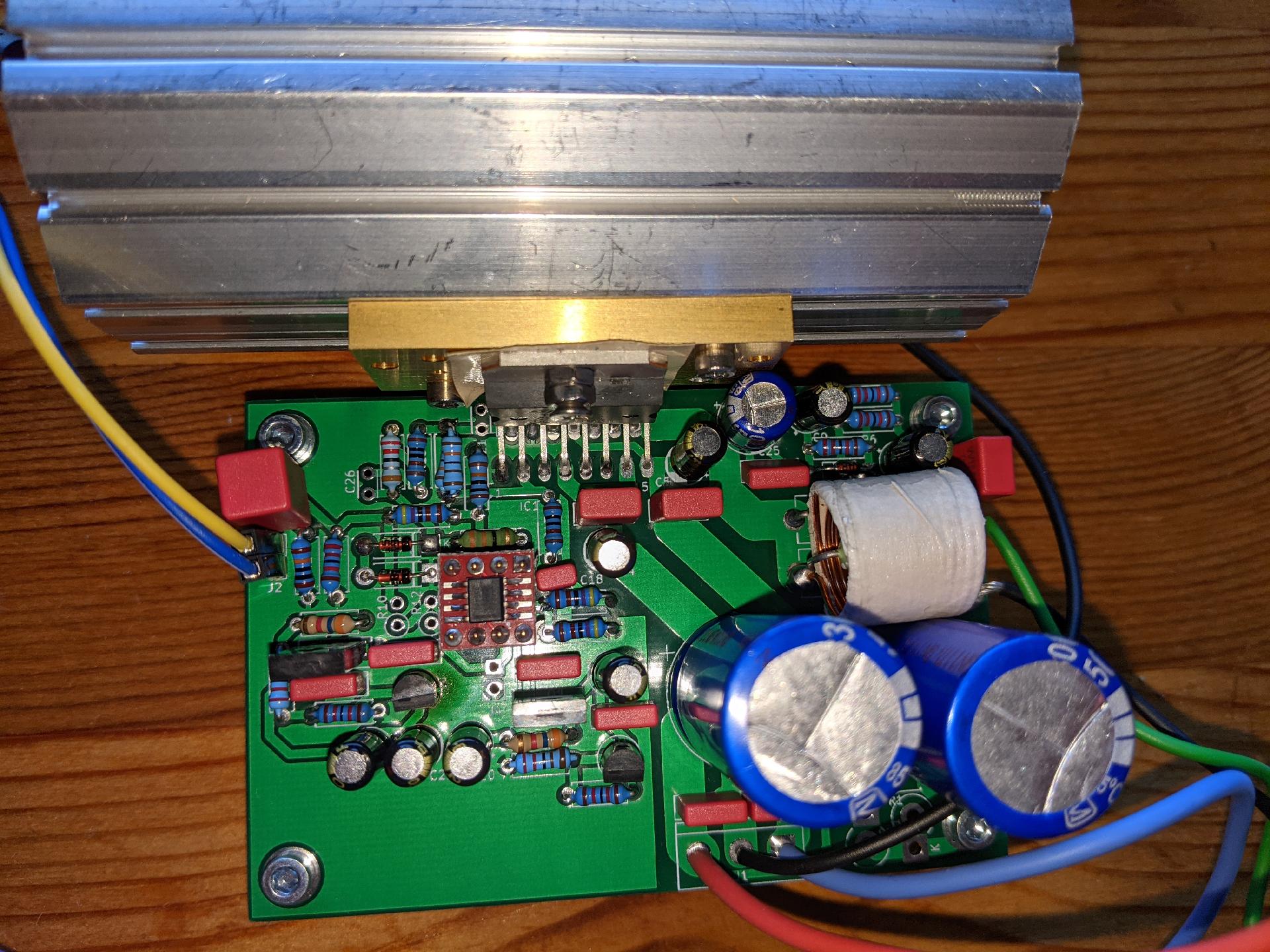

Still valid: if someone wants to join the club and make tests/measurements, I have 1 PCB left and can make gerbers available.

as I'm about to send Gerbers to China, I'd like to ask if I could get those for this Amp. One project for this winter could be exchanging the 6 open source LM3886 in my floorstanders to composite TDA7293. If wanted I could order a few more, for the DIY people in Germany, maybe Europe.

That said, I can provide schematic and gerber to you Jochen. Give me some time to look them up and at least have a brief check.

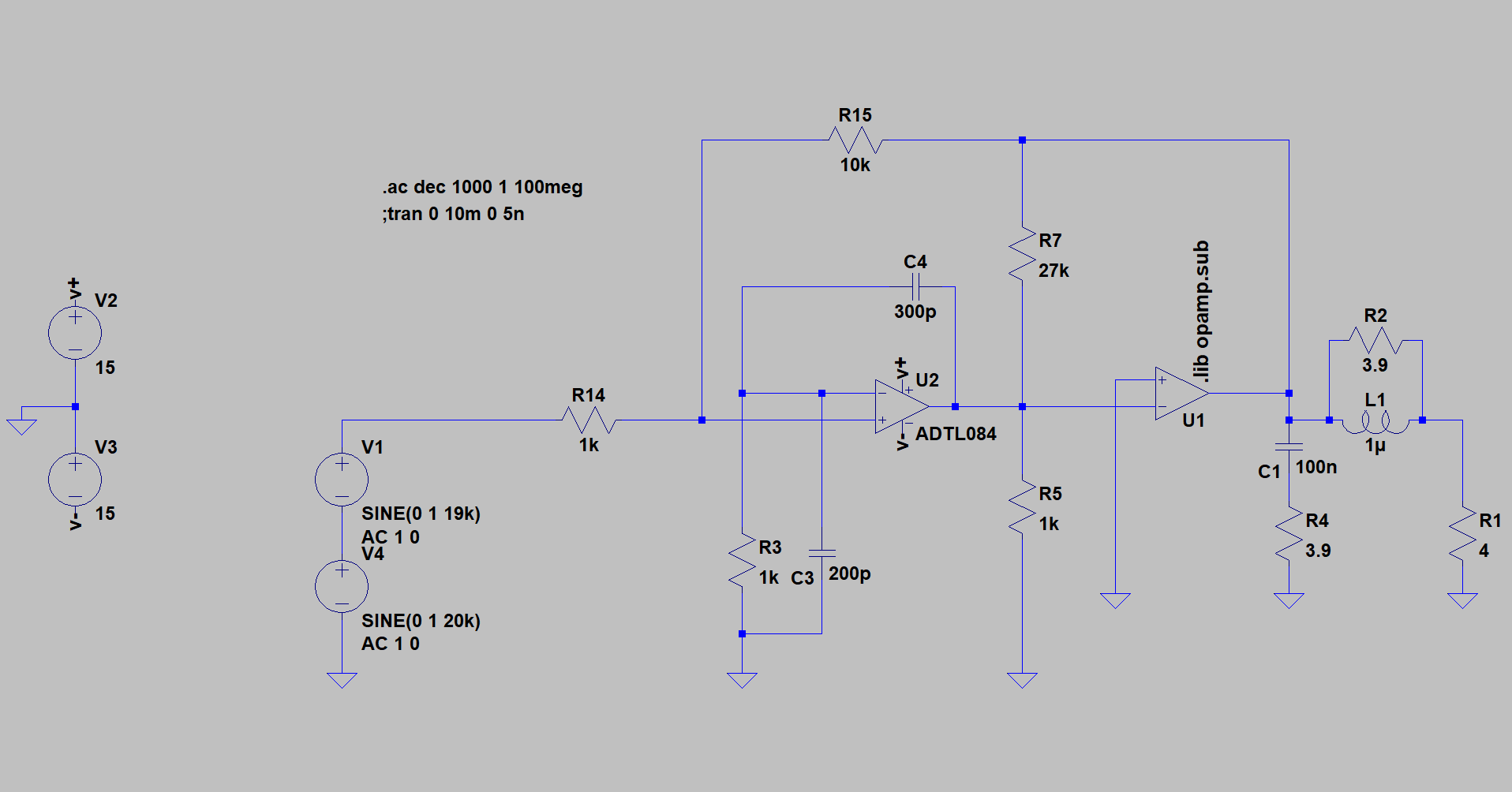

Power supply for the opamps is with 2xTL431 and BD139/BD140 pass-transistors.
I´m pretty sure I have an extra board (3 in total) if you shouild need another one.
I could even send you my prototype if you don´t mind the shipping.
