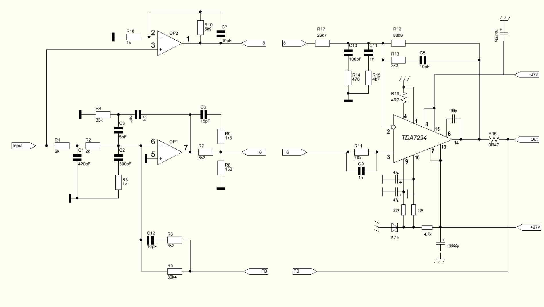

Questions about the power amplifier block are inverting or non-inverting configuration? And, DC or AC coupling?
For the LM1875 we chose inverting configuration. The OP-AMP doesn’t care and the inputs just have to be used accordingly.
Empirically we found that the LM1875 was easy to stabilize at very low gains when used in an inverting configuration. I can imagine some reasons: The gain of an inverting configuration is the feedback resistor divided by the input resistor. The gain of the non-inverting configuration is the same plus one (+1). Though we all like to get something for free, it can be inconvenient when you aim for a lower gain than natural stability recommends. The teaching from a minimum closed-loop gain to ensure stability means that the harder we feed back, the further we risk instability. If we would like the power amplifier block to have a gain of for instance 5, we can either use an inverting configuration where the feedback results in a gain of 5 or we can use a non-inverting configuration where the feedback results in a gain of 4 plus the 1 that comes “for free”. Thus, using the non-inverting configuration we use harder feedback than with the inverting configuration for the same overall gain. Hence, the chip-amp loop is a little less far away from natural stability with the inverting configuration. I have been told that reducing amplifier gain with a resistor between the two input pins increase distortion but in particular for common mode signals. Assuming that is correct, the inverting configuration is based on differential input signals only while the non-inverting configuration partly uses the input signal common-mode wise. Thus, two reasons indicating that the inverting configuration could be preferable.
In the thread which I have been referring to a couple of times, I tested various chip-amps only in inverting configuration with the purpose to show that there was a solution and more-or-less how that solution looked. It was no proof that the inverting configuration is superior to the non-inverting configuration. But, use of the non-inverting configuration requires that someone repeats my inverting tests for the corresponding non-inverting configuration and compares the results.
The controlling OP-AMP needs a feedback-response to all frequencies it tries to regulate, hence, to all signals it receives on its signal input. If we use a non-inverting power amplifier block, its resistor to the inverting input may be connected in series with a capacitor such that the resulting gain at very low frequencies becomes 1. This non-inverting coupling is useful for normal chip-amp circuits where we want to reduce the DC-offset at the output. In a composite amplifier with an outer controlling loop, the outer loop compensates for DC-offset in the power amplifier block. With this outer control loop, the DC-offset at the output becomes the DC-offset at the OP-AMP input times the closed-loop gain of that outer loop. An LM4562 has a typical input offset of 0.1mV. With a closed-loop gain of 10 (20dB), the DC-offset at the output will be 1mV. With a gain of 20 (26dB) the offset becomes 2mV. OPA1612 has an input offset similar to the LM4562 and the results become the same. OPA1656 has five times the offset of an OPA1612 such that the results at the output become 5mV and 10mV.
I find that even 10mV is nothing to worry about and a DC-servo or even manual regulation is unnecessary. Accordingly, I see no reason why the power amplifier block cannot be DC-coupled to the outer loop such that less components are use and the transfer function becomes the simplest. Very low frequency cut-off (some 5Hz) is then arranged at the input of the outer loop.

I´m with you FF, the TDA7293 in an inverting-configuration with a gain of 5.
In any case I´d like to include R3 from the circuit I posted above (post #19):
1. this way one can ensure stability of the inner loop under most circumstances
2. in case of oscillations one can better isolate if its triggered by the inner or outer loop. When not needed just replace with a wire, or 0R SMD-resistor.
I understand your reasoning for a gain of 6.3x for the LM4562 but if we end up with a gain of 30dB (5x6.3), that would mean more attenuation in front of the composite and thus more noise at typical listening levels.
I do believe the "first watt" is most important and don´t care so much about the performance of an amp where my ears already bleed ;-)
That said, this is not something that we necessarily have to define before (opamp & gain of control loop).
As I see it, the "only" things left open in the schematic is compensation(s), parts we gonna use(decoupling, SMD/through-hole, voltage regs. for the opamp, max. supply +-43V?) and which parts we have to expect to change in the process of evaluation (-> these go in the top layer and preferably non-SMD).
And what do we have in our drawers to keep cost down.
which parts we have to expect to change in the process (-> these go in the top layer and preferably non-SMD)

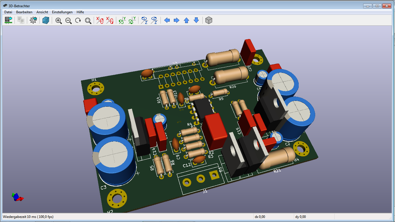

The feedback paths should be kept as short as possible which could mean putting parts under the TDA7293 or using SMD (which also isn´t too easy to change) but as you have more practical experience in composites and their sensitivity to layout i´ll stick with your opinion about that.
This is just a draft (parts placing) to whet the appetite and to get a feel for the size of the board and critical areas. You can see the feedback resistors on the bottom layer next to the TDA7293. (this PCB is 80x55mm)
(If you´re ready we will do the layout together, be it next week or in 2 months.)

We seem to agree a lot. R3 is just what I want as well. I will even suggest a resistor (R4) between the non-inverting input and ground such that R3 is connected directly between the two input pins and R4 goes to ground. This was how I tested various chip-amps in the other thread and an R4 seems to leave the possibility for further gain reduction.
I fully understand that a SOIC-8 OP-AMP can be replaced but for those of us who like to experiment, I prefer a DIL-8 socket and use of SOIC->DIL-8 converter boards. This is how I use my OPA1612.
I will also suggest an OP-AMP output clamp. It is basically two zener-diodes connected in series back-to-back and a small value resistor. This clamp catches the OP-AMP output when the power amplifier block starts clipping and the OP-AMP looses feedback (due to the clipping saturation).

If you chose a op amp for EC , chose the one with character of dominant H2 distortion.
TDA7293 have a natural H2 dominant character which is unusual for a Chip amp and found mainly in fine tuned Dis-create Class AB amplifier.
I will recommend adding a DC Servo to eliminate NFB cap , It will improve transient response and slew rate. All 7293 i measured have slew between 11v/us to 19v/us ( Bit erratic)

The fact that I ordered a preliminary version of the PCB (without initially posting it here for discussion) was due to the fact that I ordered other PCBs and had a timeslot for designing it.
