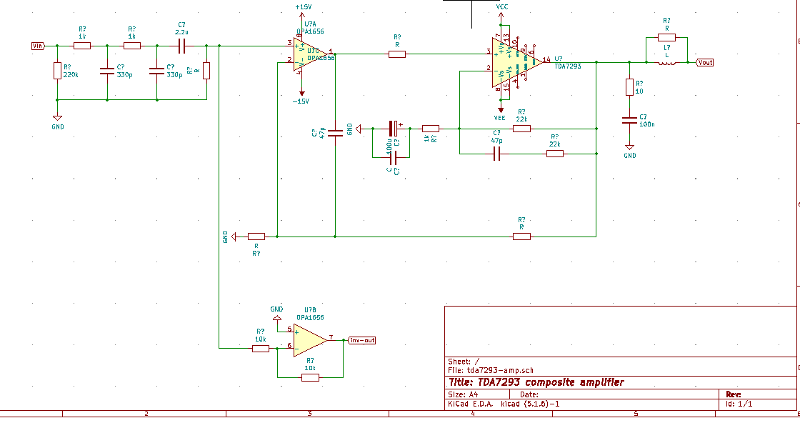

Attached is an premature sketch to get discussion going.

For starters a couple of points that can be decided later on:
- I´d suggest a single TDA7293 for compactness and keeping paths short. (although thanks to the extra pins the chip can be easily paralleled)
- I´m up for an all SMD-parts amp or at least the feedback network/-resistor to keep lead inductances small and maximize stability margins.
But I do know this is not very DIY-friendly.
- Applying a dual opamp as controlling opamp, the second half of the chip could be used as line-out-buffer, headphone output or inverter in order to (opt.) bridge two amplifier-PCBs.
Frankly, the TDA7293 will not make your life easy in a composite. The datasheet is completely silent on important data for a composite amp such as open loop gain graphs.
The distortion goes up quickly with frequency, which doesn't bode well bandwidth wise.
A quick note for the feedback network resistors: as you have to use relatively big resistors to avoid thermal issues, those smd parts would still be quite big.
Btw, there is a composite lm3886 in the open, the ZD50. It's an interesting design to study.

A few qualitative considerations that may help less experienced DIY’ers to understand what we aim to do. Further, if I am wrong it is possible to correct me before I go too far with useless ideas.
A principle with nested loops is that the simple way to make the combination work is by keeping the bandwidth of an inner element much higher than the bandwidth of an outer loop. The inner element in our case is the power amplifier block. The outer loop is the OP-AMP control loop.
When the inner element has a much higher bandwidth than the outer loop, the inner element has a simple transfer function seen in the operational range of the outer loop. The outer loop will see the inner element as a simple multiplication element between input and output of the inner element. Phase-delay between input and output of the inner element is little significant seen from the outer loop and has less importance for the stability of the outer loop.
Thus, we should use a power amplifier block with a bandwidth as high as possible. The higher the bandwidth of the power amplifier, the higher we can leave the bandwidth of the controlling OP-AMP outer loop. The higher bandwidth of the outer loop, the better suppression of distortion in the power amplifier output. It is mandatory that the inner element is absolutely stable under all normal operational conditions. As the outer loop is much slower than the regulation loop used for the inner element, the outer loop has no chance of compensating for an inner element that misbehaves. Hence, stability of the power amplifier block needs to be ensured before trying to add an outer control-loop.
I tested TDA7293 and some other chip-amps for use in composite amplifiers. The chip-amps were tested the same way but probably not according to a standard. That means that the test results only indicate characteristics of one chip-amp relative to another, subjected to same test.
For TDA7293 I found a -3dB bandwidth of around 600KHz while I found around 400KHz for LM3886. This indicates that TDA7293 should not be inferior to the very often used LM3886.
Chip-amps suited as power stage in a composite amplifier, LM1875/TDA2050 excluded. , posting #33 and other.

When I look at the compensations used in that thesis, we are talking about a handful of parts that are (most probably) needed anyway. In place of capacitors (resistors etc.) we could solder sockets like these (cut a single one off) and measure.
https://www.mikrocontroller.net/attachment/197276/MPE_115_1_010.png
This would take the variable PCB a little bit of out of the equation in the search for stability (not that I am an expert in PCB-design but it´s easy enough to better the veroboard I guess).
I´d suppose we start with circuit from the paper above and maybe also that same opamp. Thanks to your measurements the TDA7293 shouldn´t be that far off the LM3886 so that circuit could be a nice fit already.
BTW: If you have a problem with SOIC-packages I can always solder them in before sending the PCBs to you.

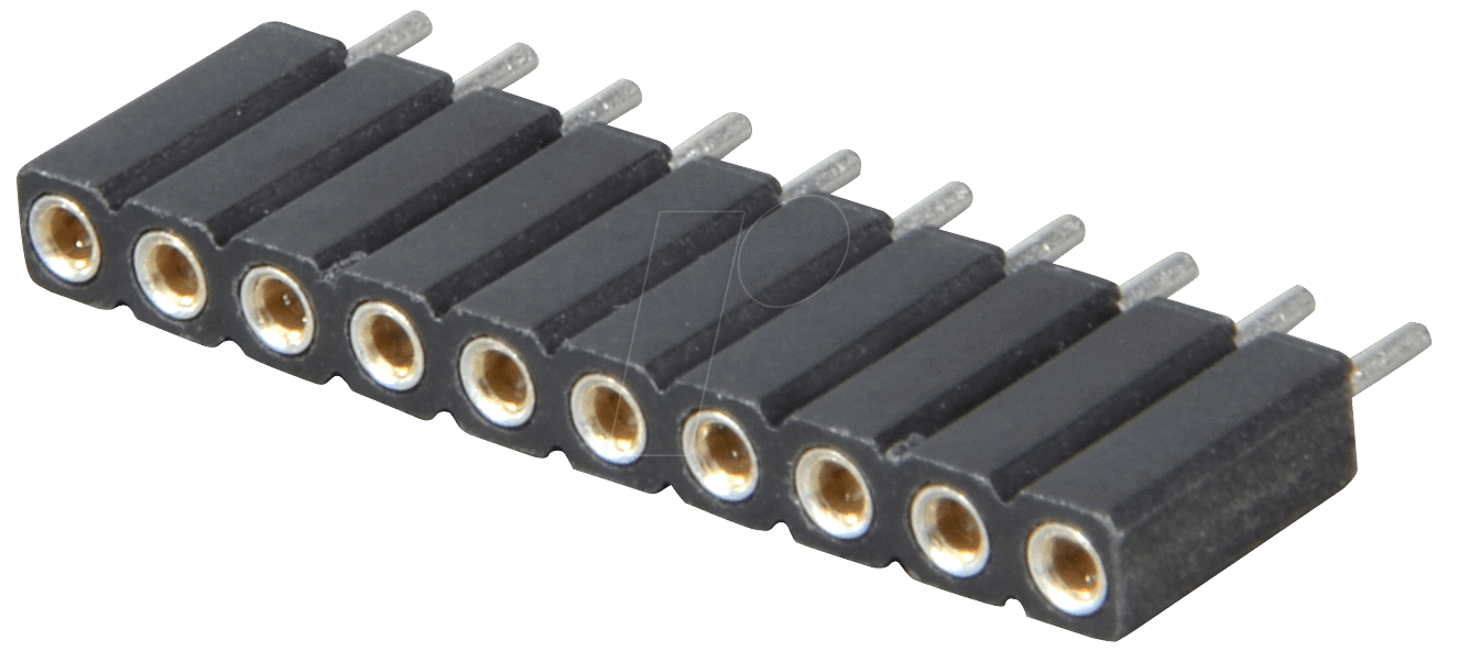

I think it is understandable that you want to build a PCB that allows for easy testing, but providing for many options regarding compensation and socketing more components leads to many compromises in layout and adds unwanted parasitics (potentially in locations where you really do not want them). So keep it reasonable I would say.
About the "paper": Let's just say I would rather look elsewhere. Apart from switched OpAmp inputs on one of the most important schematics (Figure 3.12), there are a bunch of other things that leave me scratching my head. I have seen better circuits to use as a starting point on this forum and elsewhere on the web.
Thanks knoppers.
Yes, sockets are not the optimum and might ultimately not be a good solution.
It works quite well though if everything is properly soldered except this one component you want to fine-tune.
I´m aware of parasitics.
And yes, the schematic has a mistake and by the time of writing the circuit hasn´t been build yet and thus should be taken with a pinch of salt.

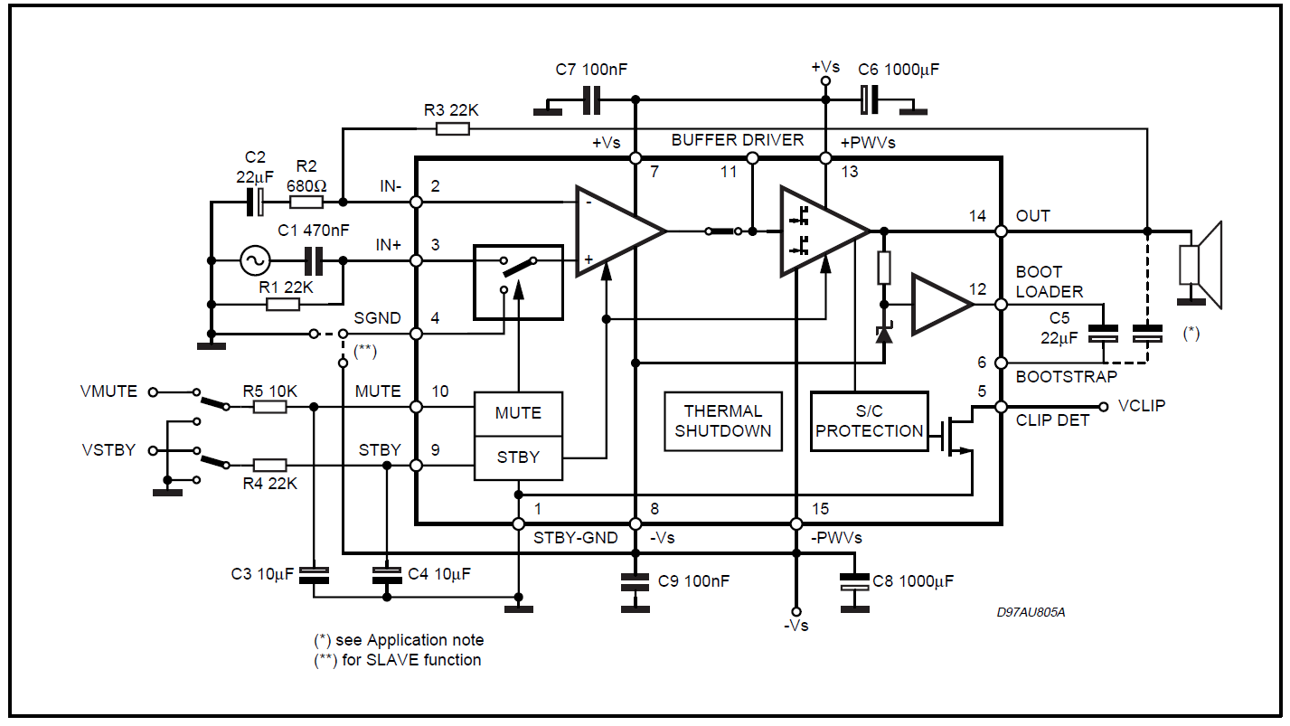

If we would apply the minimum gain from the datasheet to the TDA7293 (26dB) that wouldn´t leave much gain for the controlling opamp. (assuming we don´t need/want >30dB gain; I personally would be fine with 20dB or even less)
FF has shown function of the chip with a gain of 5 and but I think that has to be tested further and I´m still sceptic this could work out in a stable way unless we test this with signals of all frequencies, levels and shapes.
As it seems the TDA7293 can be used as power buffer which could eventually be a solution that would make the composite arrangement much simpler.
A 100W or so buffer for 3€? That would be amazing!
Unfortunately I can´t find much info about that other than this little thread here from 10+ years ago:
TDA7293 as output stage
So it would be one of the things that could be tested on the way and could make for a simple and stable solution.
Drawback obviously would be, the need for a driving stage that makes use of the TDA7293 output capabilities.
A simple solution would be a OPA604 for example that could at least provide a voltage swing of about roughly +-20V (assuming +-24V supply voltage) and thus about 25W into 8Ohms.
Absolutely fine with me as long as it works and sounds as good as we´d like.
Another drawback is (as it seems from the block diagram in the datasheet) we´d skip some of the protection-/mute-circuitry. It looks as the thermal protection is also located before the buffer. That would leave just the short-circuit-protection active. But these are just guesses!

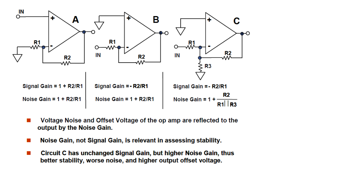

Did you ever try to use a signal gain of 1 (inverting) but introducing noise gain of about 26dB (->minimum gain from datasheet); circuit C from picture. That should definitely be stable and make the composite rather easy to handle.
That would of course mean that the noise and thus S/N-ratio would get about 26dB worse.
Signal gain of 4 (12dB) and noise gain at 26dB would still be S/N-loss of 14dB.
That said, in the composite the overall noise could still be better than a single TDA7293 (assuming a very low-noise controlling opamp).
Picture taken from MT-033 tutorial (Analog Devices):
https://www.google.com/url?sa=t&rct=j&q=&esrc=s&source=web&cd=&cad=rja&uact=8&ved=2ahUKEwiGhbjLwajvAhWFr6QKHR5QAxsQFjAAegQIBBAD&url=https%3A%2F%2Fwww.analog.com%2Fmedia%2Fen%2Ftraining-seminars%2Ftutorials%2FMT-033.pdf&usg=AOvVaw2tNPmBlfid2O50Ov_Ok6th
Just realize that this is plain wrong.:rolleyes:
In order to calculate the actual worsening of the S/N one would have to know the actual noise that is being amplified but you get the point. Noise in that configuration would be amplified with a factor of 20 and the signal only between 2-5x, if applying reasonable gain in that inner (power) loop.
