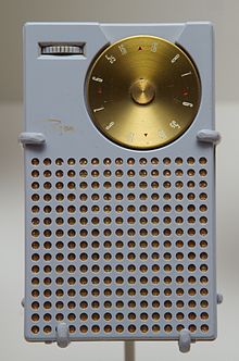

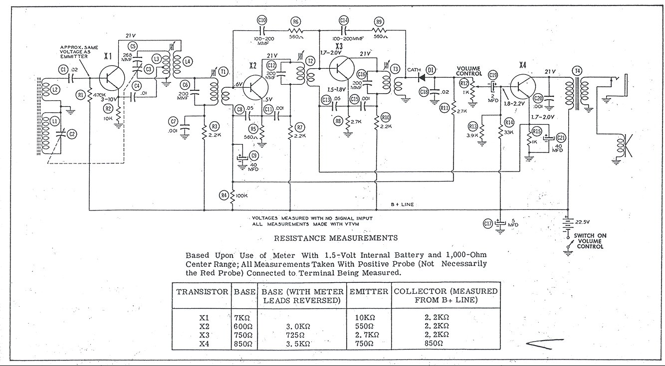

Okay, now look the 1954 Regency TR-1, the first commercially produced transistor radio. Do you see anything complicated in this, now?
Retrospectively, you could build one, as soon as 1958, after carefully studying the people and companies present at the 1958 Brussels Fair, involved into semiconductors distribution and PCB manufacturing.
