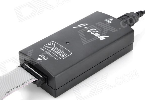

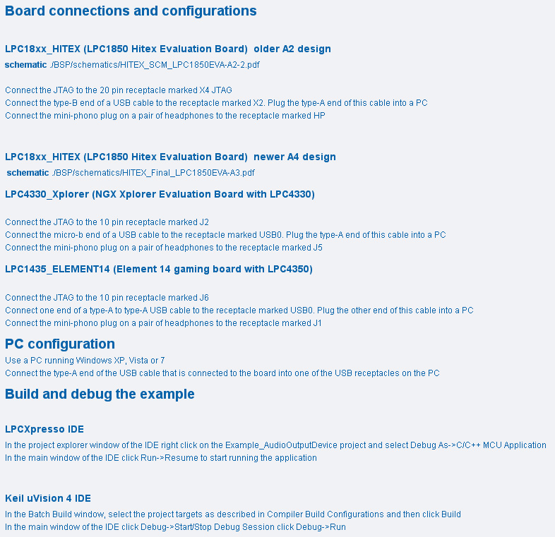

I am using Keil & J-link with my custom made development board based on LPC4330FBD144 chip.

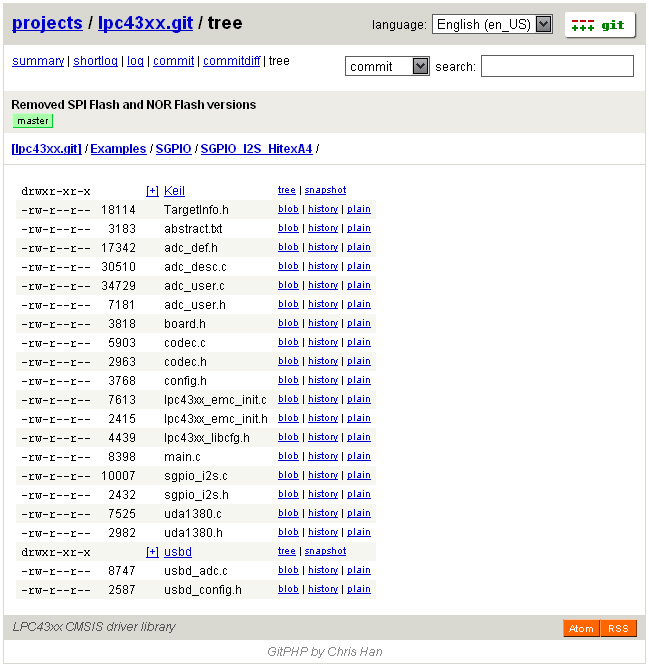

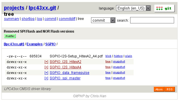

Examples from NXP are available here: LPCware.com GIT server :: lpc43xx.git/tree
Now I am developing UAC2 firmware for full multichannel output testing...

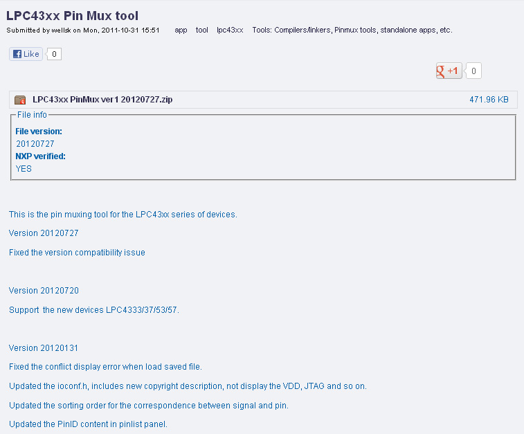

Cool. I've had some time to work on my 4300 based DSP+DAC project lately, an offshoot of which is the attached spreadsheet for tracking pin assignments.
There is very helpful tool for quick pin routing:
LPC43xx Pin Mux tool | www.LPCware.com
Thanks for the links! I'm looking forward to going through the samples. The pin mux tool is interesting as it doesn't support all pin assignments listed in the datasheet. I'll have to compile the differences and email the author.

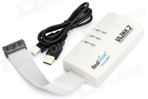

Hmm, is it possible to buy a ULINK-ME on its own or is it always bundled with an eval board? I checked all the US distributors and they're always bundled, though $210ish for for an eval board + ULINK-ME isn't hugely far from $170 for a Red Probe with the 10 pin Cortex debug adapter. Main difference is MDK-Lite's 32k limit and steep licensing fees versus LPCXpresso's 128k limit and considerably less agressive pricing. But I'd be surprised to hit 32k and $40ish can quickly pay itself back in hassles avoided. ($300-400 for a ULINK2 is more than I'd prefer to spend.)
For folks who've used both environments all the way though to debugging, what's your preference? (I've only toyed with LPCXpresso so far.)
There are more cheap variants. 🙂
For example: J-Link V8 ARM USB-JTAG Adapter Emulator - Black - Worldwide Free Shipping - DX
or Keil Ulink 2 ARM Multi-Function Emulator for SCM - White - Worldwide Free Shipping - DX
Nice! I would guess it's probably just a change in the silkscreen on the box to say Real View instead of Keil. The Real View Ulink 2s eBay for as little as $0.01.

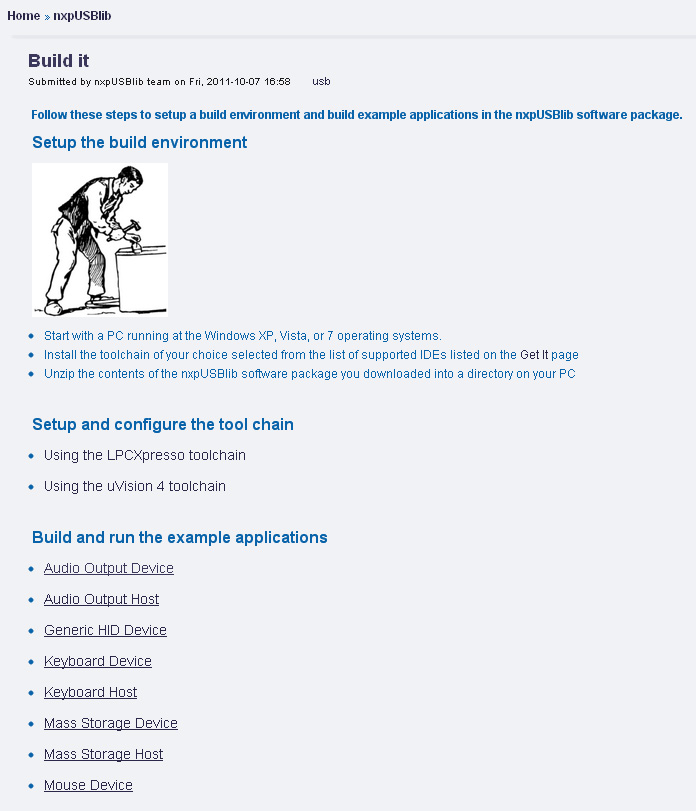

Those last weeks the LPC4330 support improved thanks to:
- NGX LPC4330-Xplorer board ($56.42 - I already own two of them)
- LPCware
- lpc43xx.git (especially the lpc43xx SGPIO I2S for UDA1380)
- nxpUSBlib (grabbing audio from USB)
- LPC43xx Pin Mux Tool

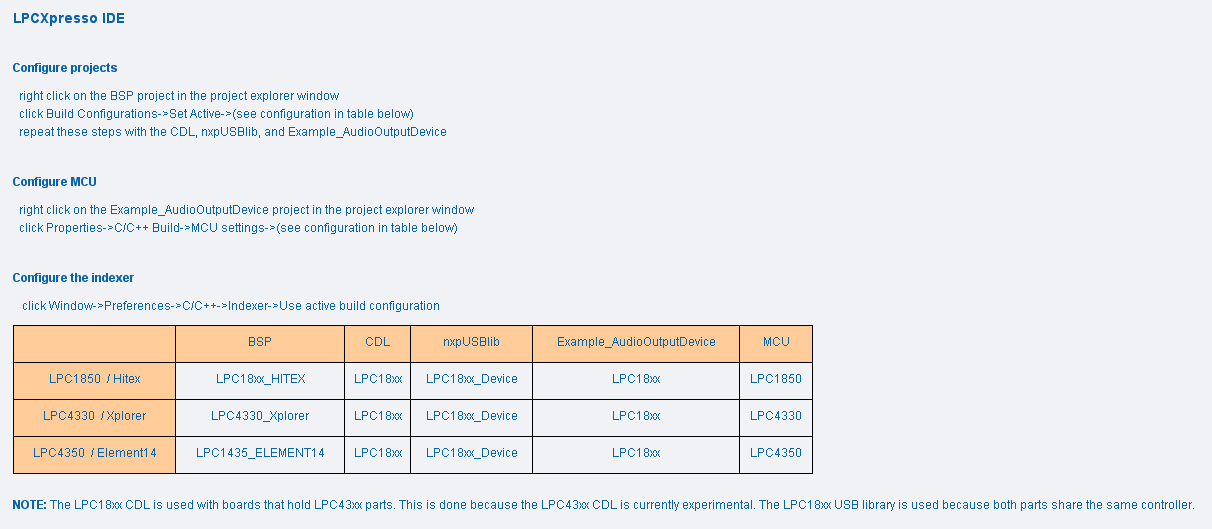

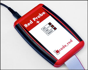

You can use either:
- a Red Probe+ (or original Red Probe)
- or the LPC-Link probe from an LPCXpresso board
to debug your LPC4350.
LPC_4350_Support
LPC_4350_Support

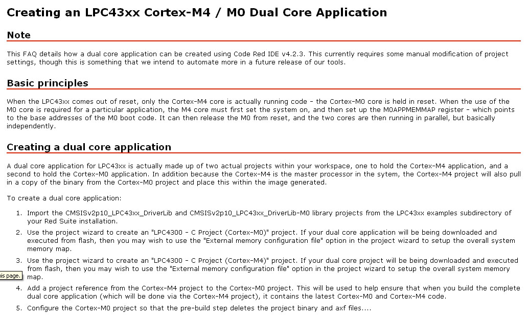

How to a access both the M4 and the M0 on the LPC43xx.
Read this: LPC43xx DualCore Projects
Make sure you read the whole webpage. To me it looks quite complicated. I guess most developers will hate working this way. Such is the current issue with the LPC43xx.

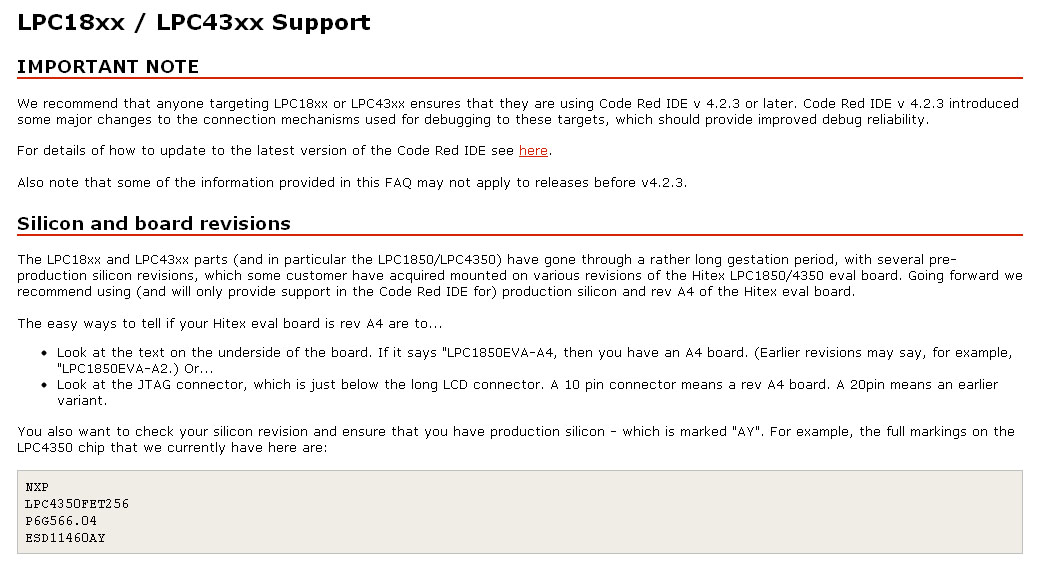

I suppose I could have been more explicit about this when I linked that page back in post 279 but, to recap, it's a moving target:
LPCXpresso 4.2.2 - no meaningful LPC185x or LPC43xx support
LPCXpresso 4.2.3 - cumbersome support as described on the wiki
LPCXpresso 4.2.4 - TBD
I would guess by 4.2.5 writing M0+M4 code could be pretty smooth. From a glance at the sample code a5856 linked Keil's been there since at least March. So I'd be cautious about inferring the state of dual core Cortex development from Code Red starting to catch up. (This is not to say all's well with Keil. I'm not hands on with MDK yet as Keil's download page thinks the email address I've been using daily since 1994 is invalid---haven't gotten a response from Keil support yet.)
