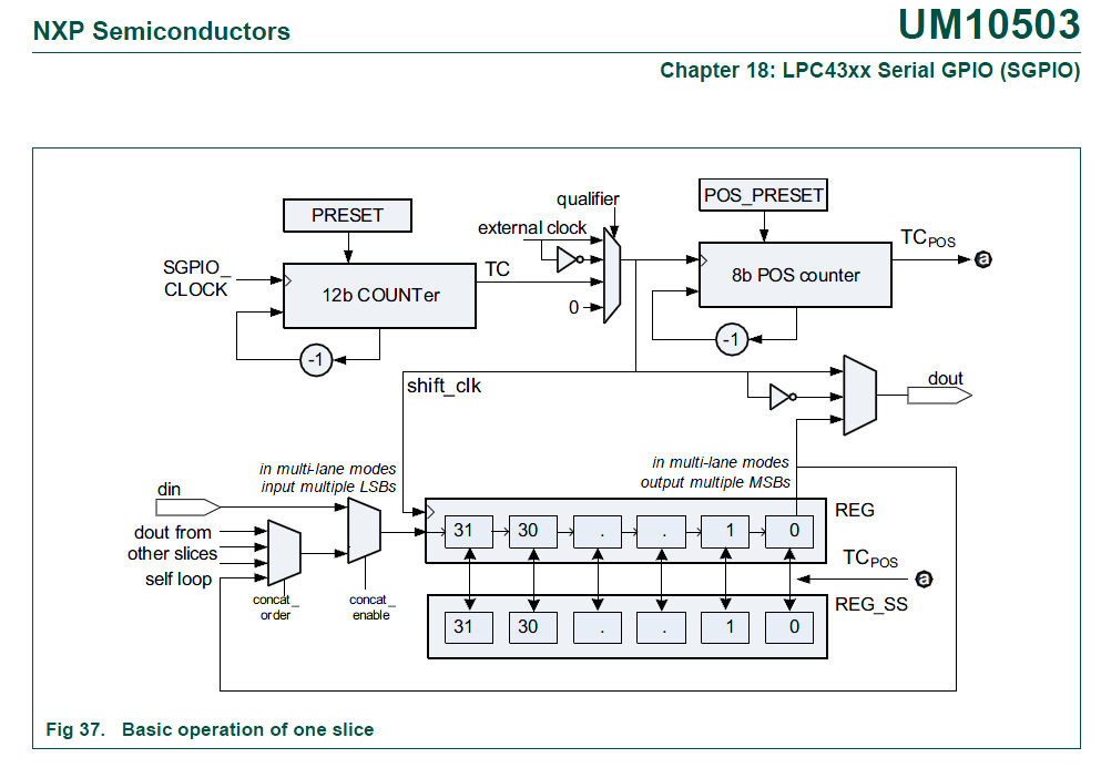

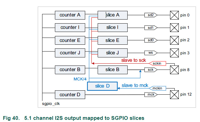

hello twest820, thanks for pointing the new LPC43xx User Manual dated 8 June 2012, available here http://www.nxp.com/documents/user_manual/UM10503.pdfOh, teh dramaz. Implementing section 18.8.1 of the LPC4300 manual or variants thereof isn't particularly difficult programming, loop back mode on the XMC4500 USICs has the same SCLK regeneration limitation, and a 50MHz clock is plenty in the majority of crossover and equalization cases.
Chapter 18 starting from page 347, dedicated to SGPIO, is now more than 30 pages long.
Unfortunately, the 5.1 channel I2S proposition is unpractical. Confront it to any modern multichannel Codec. Draw the WM8581 block diagram next to it, and try connecting it. LPC43xx as I2S slave and WM8581 as I2S master. Good luck !
