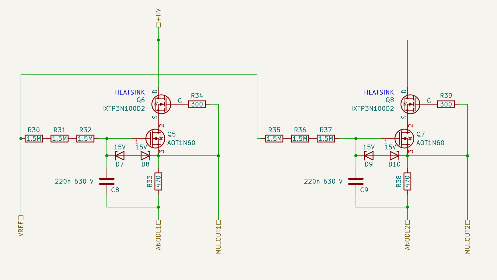

Standard deviation of FETs parameters (mainly IDSS) will be enough large. Matching (or rather measuring) its for IDSS filters out weaker ones (generally similar IDSS gives similar gfs too) .... and fakes too.
Once I bought -cheap- 100 pcs J310 and measure its. All of them was fake, probably relabelled (below 10mA) K170.
If the gyrator output impedance is important, the lower FET forward transconductance (gfs) is defining parameter.
Approximate data:
J310 (with enough large deviation) 13mS (8-18mA depending of manufacturer);
J113 0.5-30mS;
2SK170 22mS;
BF 862 45mS;
AOT1N60 900mS.
Each of them datasheet shows "from-to" or defined gfs data, but all measured at ten-few ten D-S voltage.
The method of use -in this case- gives -about- 1-2V, so gfs degrading here, but generally higher datasheet value gives lower output impedance.
So AOT1N60 theoretically is better here than J310 .... but a little unpractical.
The first is TO220, the second is TO92 cased, AOT1N60 has -even- 1A capability, the matched/measured J310 is appropriate for 20-30mA application.
Approximate data:
J113 0.5-30mS;
2SK170 22mS;
BF 862 45mS;
AOT1N60 900mS.
The 2SK170 is limited to less than 20 mA, the BF862 is SMD only. The J310 and J113 would work ok. However, the AOT1N60 has much higher gfs, and I don't see anything unpractical about it. I guess we can stick to the AOT1N60.

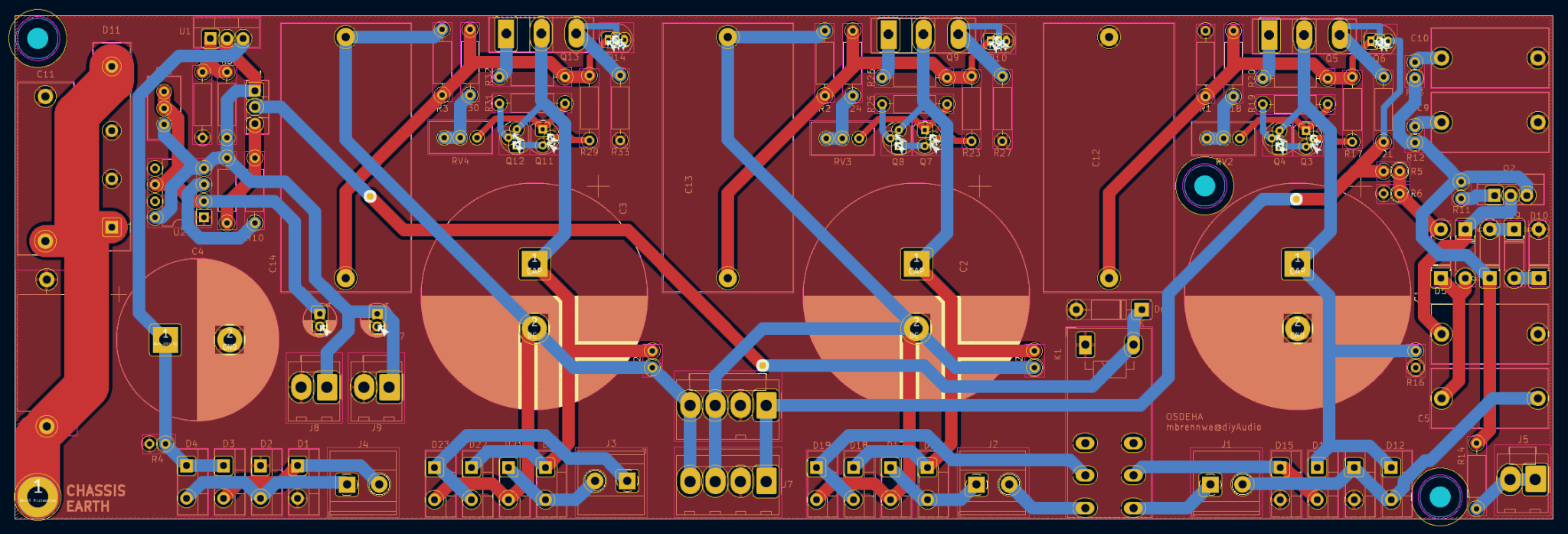

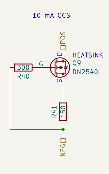

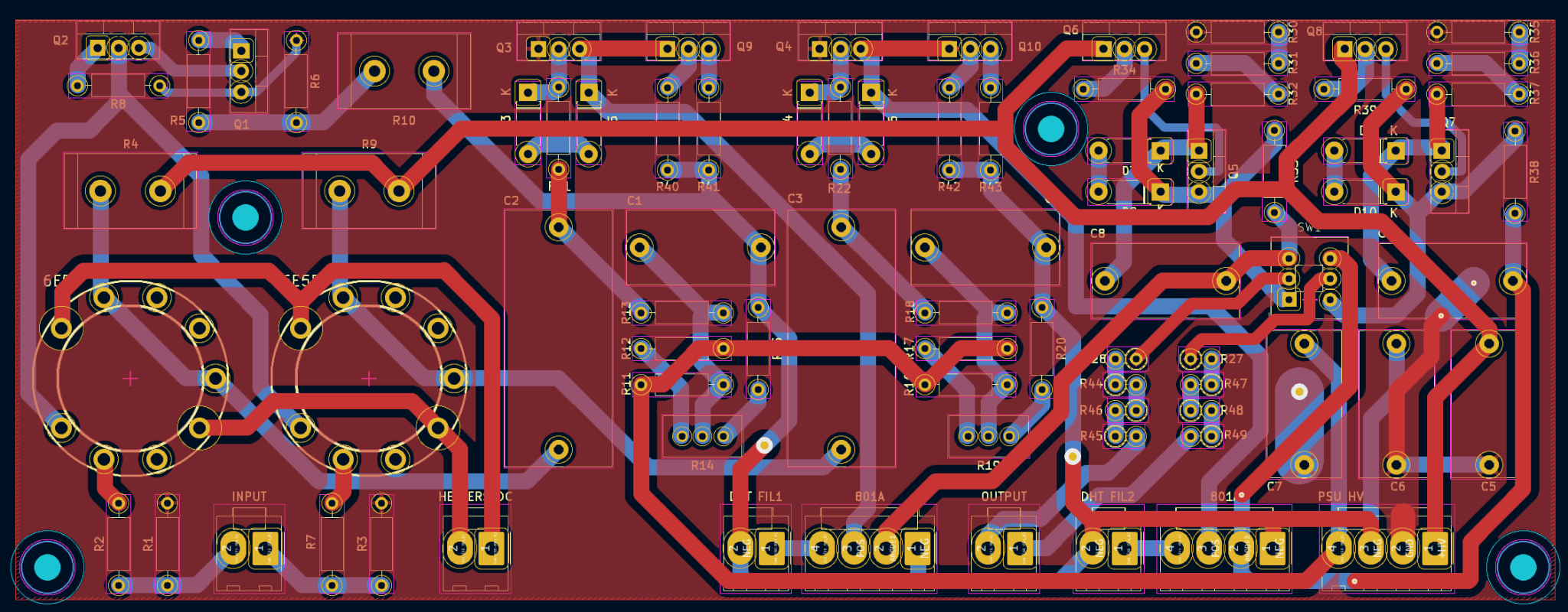

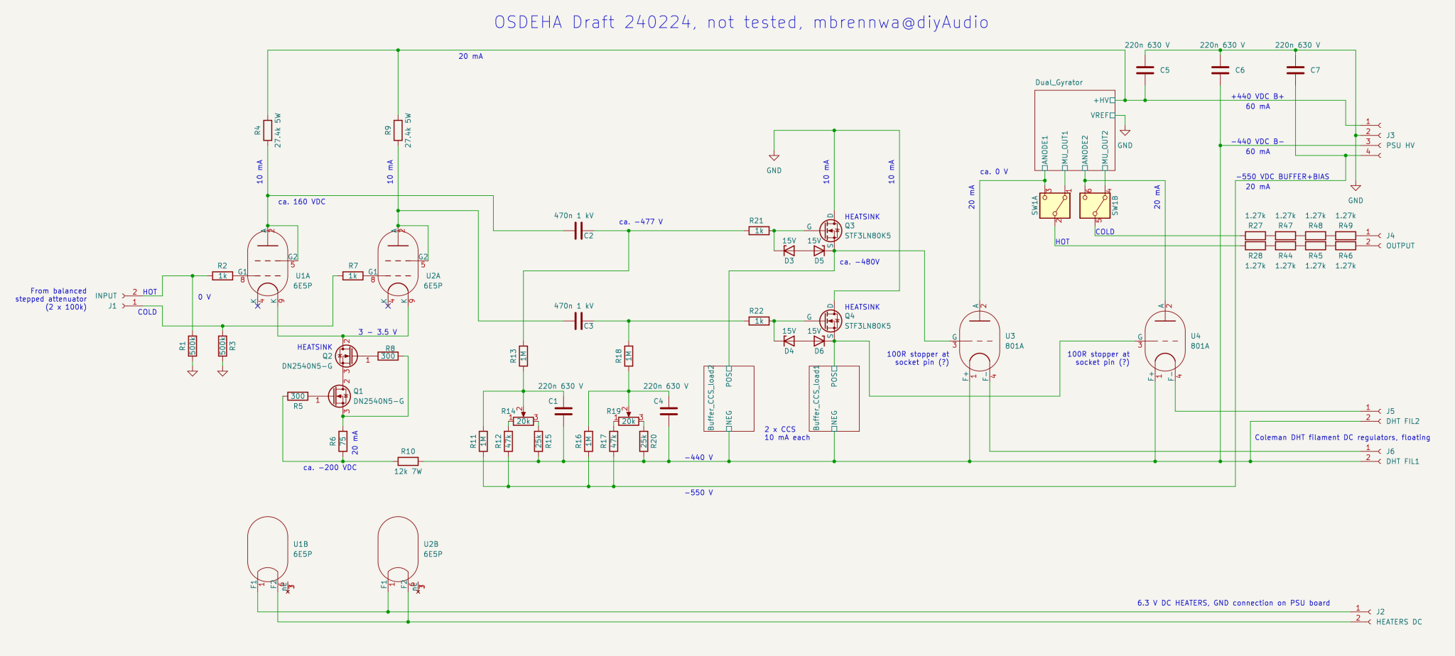

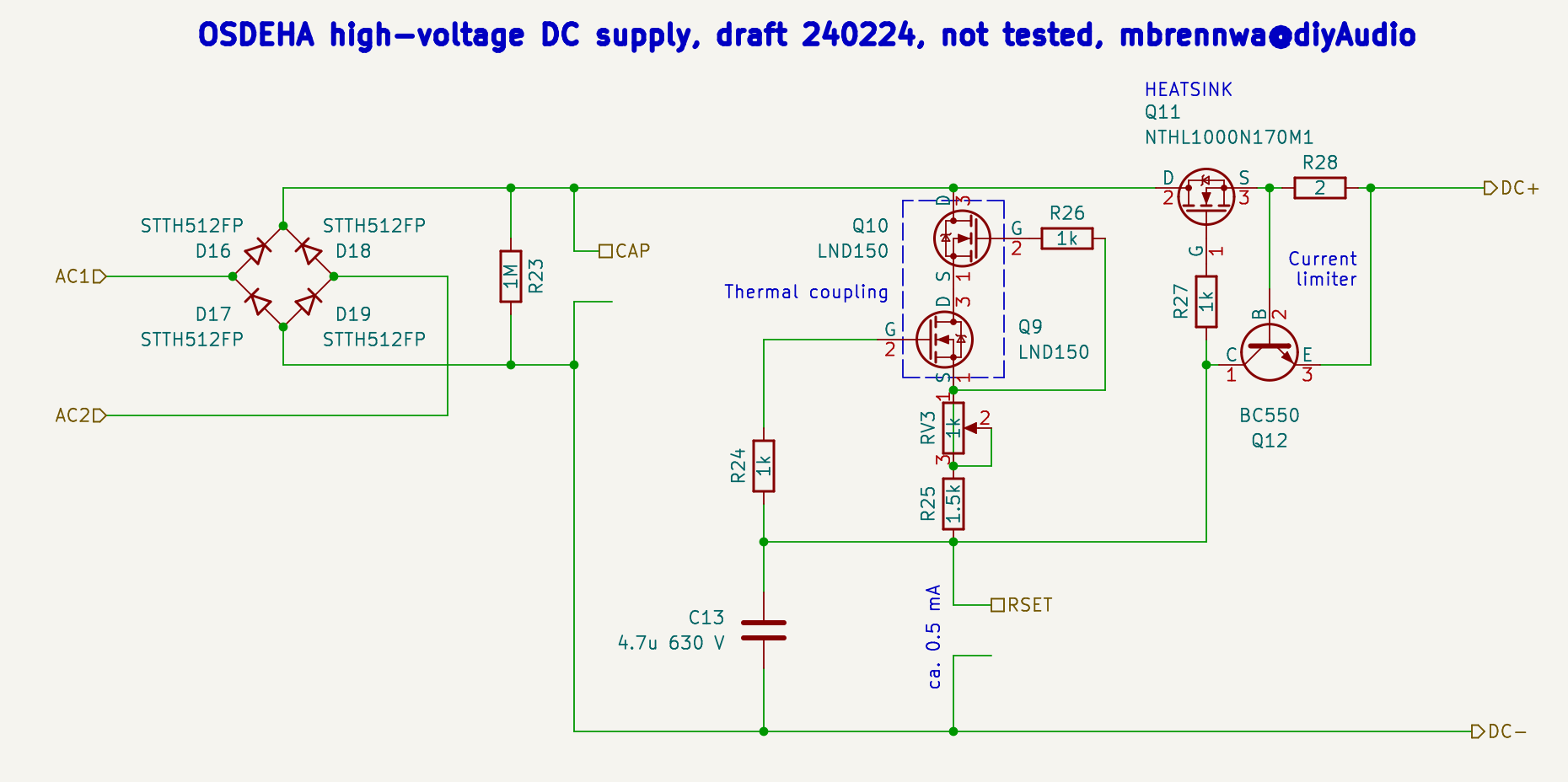

Here's one more iteration of the amp schematics and also a first attempt of a PCB layout. I am a total noob with PCB design and KiCad!
The amp schematics show the changes related to the recent discussions. The main change is the added filter caps on the amp boards, and the removal of some Zeners. I also realised that the HOT/COLD signal polarity got upside down after the buffer FETs, so I also fixed this.

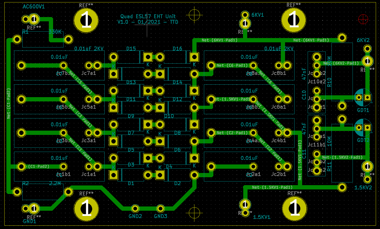

The spacing seems to be a little close in the critical area.

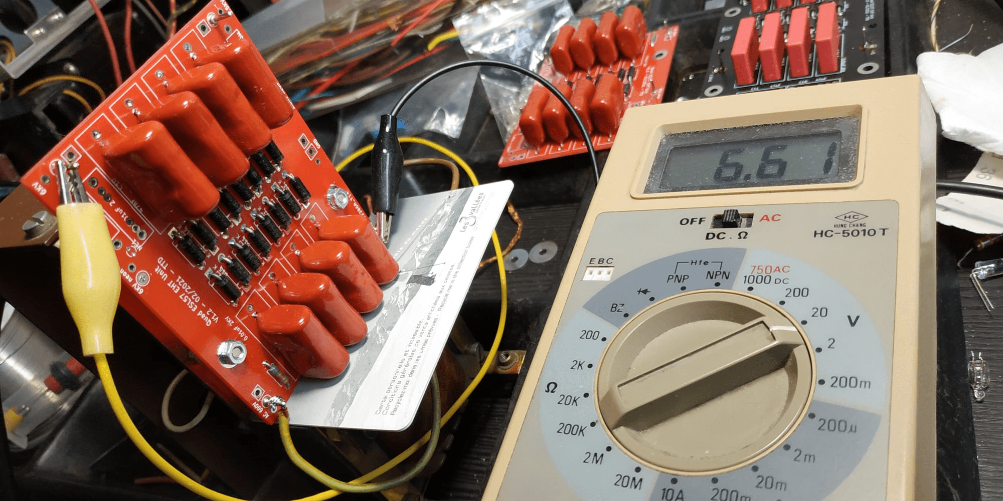

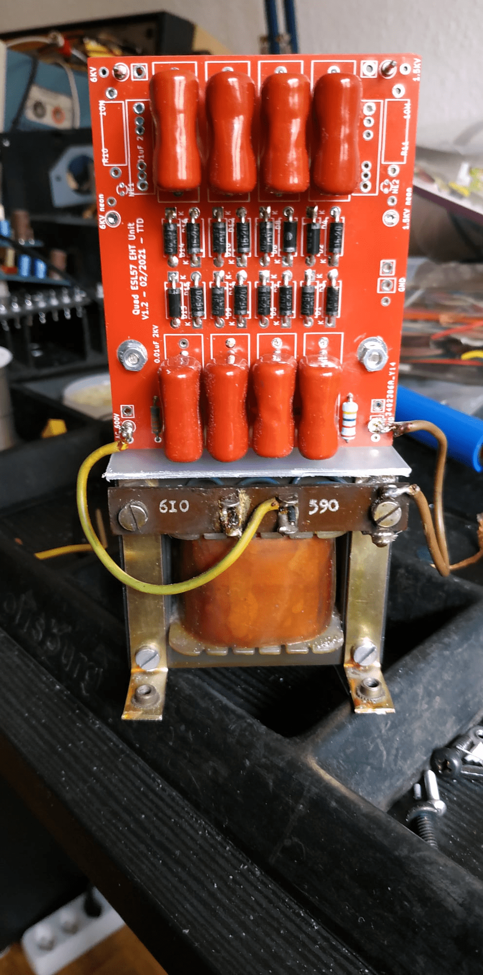

The first pic is my failed attempt at a HV board for the Quad ESL57: arc at the upper left hand side:

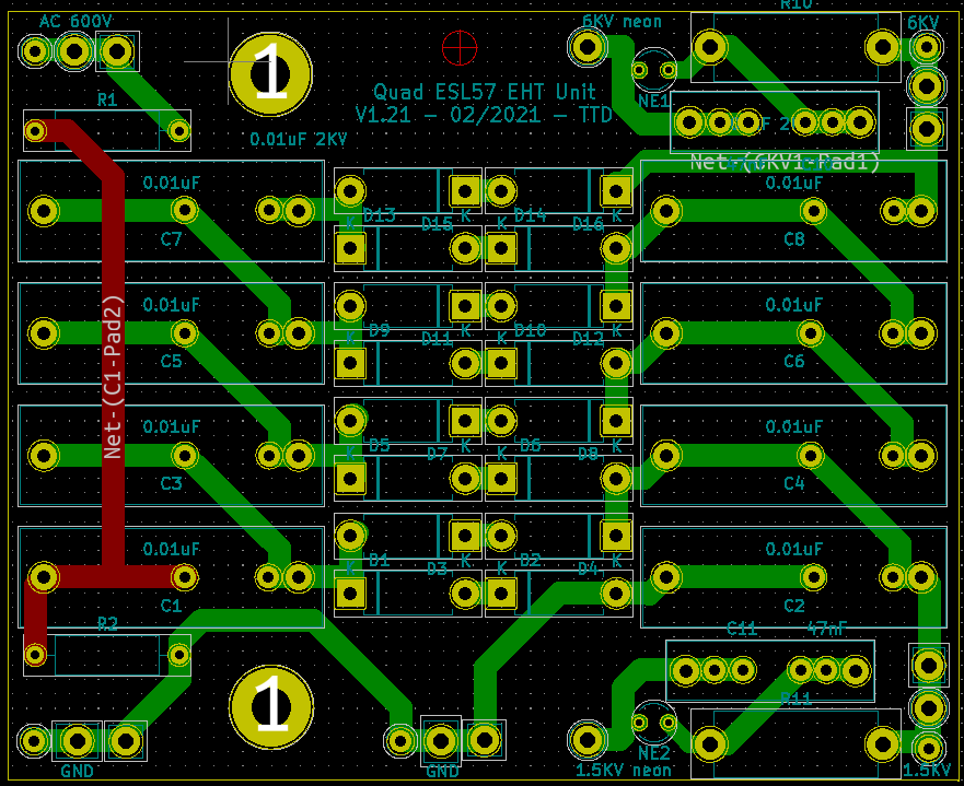

V1.21, the second attempt works:
Of course, these boards deal with 6KV, so YMMV.
Ah, oh, aehm. I didn't think of arcing at all... and I don't know much about it.
With the estat bias of +580 VDC and the grid bias / buffer supply of -550 VDC, the max. voltage between tracks would be 1130 VDC on the amplifier board. On the PSU board it might be slightly more right after the rectifiers, but not much.

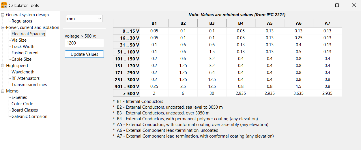

What is the typical/recommended limit for the distance between tracks for a given voltage? Does that scale linearly with voltage?
The working board in your example uses both the top/bottom layers. The distance between the tracks is only the thickness of the board. Will the board material prevent/reduce arcing?
Me neither, that's the feeble excuse for the 1st fail. 🙂
Rule of thumb: air is terrible, anything else buys you at least 10x improvement. Experimental proof: the arcs I observed were between the exposed wires of the parts. Also, the V1.21, while safe by itself, arced merrily between the board and the mounting; easily fixed by placing an old credit card in between; the card was subsequently replaced by a piece of plastic, for looks alone.

Clearance and creepage are the relevant terms. Clearance is for air, creepage is for surface conduction (which is very humidity dependent). Any gap less than about 7mm can be bridged by a curious ant too, another factor to consider in some situations!
Milled slots in PCBs are one technique for handling creepage.
You may already be aware, but there is some very upsetting precedent involving ants and Stax.
https://www.head-fi.org/threads/ants-in-my-stax-should-i-worry.609792/
KiCad does offer some tools for calculating creepage, sort of. Ants aside, 2-3mm sounds right. If nothing else, this helps keep stray capacitances down in a design where slew rate is critical. 🙂

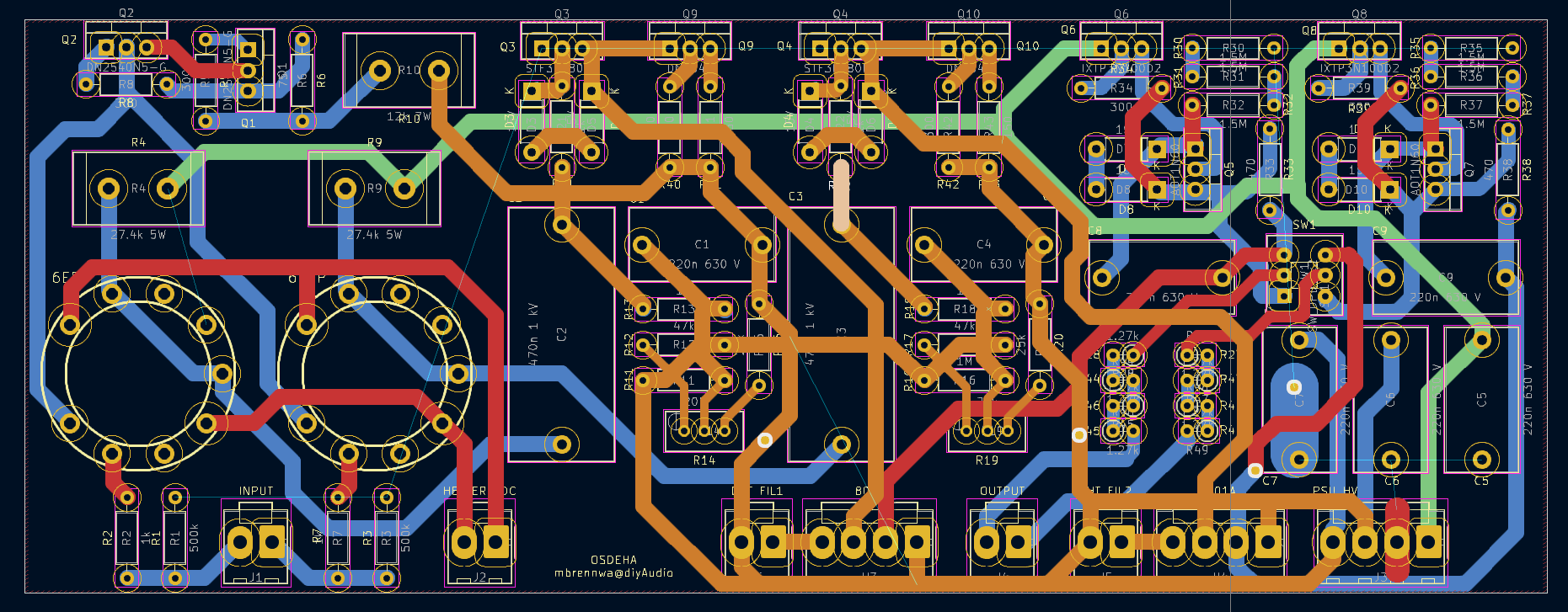

Here's what I did as a temporary amplifier board version (won't use that for the final production):
  • Changed board to 4 layers
  • Moved all traces that are at > 400 V to a separate layer (green)
  • Moved all traces that are at < 400 V to a separate layer (yellow)
  • Checked for separation between green and yellow traces (by eye)
As far as I can tell, the green and yellow traces are mostly separated by more than 2.5 mm where they are on the same side of the board. There are some exceptions around R43 (which is an easy fix). Also, the pins of some parts carrying high voltage are closer than 2.5 mm, but these parts are rated for such voltages and things should be fine.
