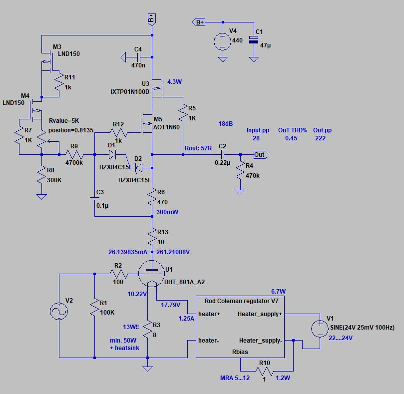

Are you sure, that -typically- 5mA IDSS J112 (with 20mS transconductance) is the good choice for CCS?
AOT1N60 is robust, high current, high transconductance (900mS) device, so if you use in "gyrator" as lower FET, the output impedance will be enough low.
Sample:
Joined 2004
It's only a sample, which shows the AOT1N60-IXTP "gyrator" (as load of 801a driver) architecture, and simulates it's output impedance.
As you can see, even at 440V B+ the "upper" FET dissipation is significant (the lower is cold), and the bias resistor -in this case 470R- also dissipates.
If you want to use 801a in A2, the grid stopper value should be minimized, or eliminated.
Ok, I see. Your circuit is overall very similar to the OSDEHA draft -- did you set this up for the OSDEHA, or did you by coincidence already have this from another project?
Anyways, looking at the bias point of the 801 tube in your SPICE model (260 V, 26 mA) and looking at the 801 curves (see here), the grid would be at -12 V. Feeding that with 28 pp signal would run the grid up to +2 V. That's not a whole lot of "positive grid", and the grid current will be well below 1 mA (according to my curve trace measurements). Still, 1 mA into 1k grid resistor would mean 1 V of distortion to the grid voltage. Thanks for pointing this out! I guess that lowering (or avoiding) the grid stopper is something to test in the first prototype build.
Joined 2004
I've been using Ale's gyrator since the beginning (one of early prototype still working in my 801a preamp).
I tested it with various upper and lower FETs, that's why I recommended to Ale trying AOT1N60 as lower FET (greater transconductance == lower output impedance, than -for example- DN2540).
Nowadays for medium anode current (about 20-30mA) in this position I usually use J310 ... but it's required selection (my batch is between 28..34mA IDSS).
As upper FET I exclusively use 1kV IXTP types (I lost dozens of DN2540 even at low voltage).
For simulation I use the 801a model that Ale developed for me (and to the community).
Enough precise even in A2 mode, several device developed with it.
p.s. tracing DH tubes is need precise biasing. If the tracer use DC filament and don't use virtual cathode (resistors from each filament point to v. cathode point), the "real" bias can be shifted.
So, should we stick to the AOT or change to the J310? Which is better, and why?
Also, I'd like to understand why you suggest IDSS and matching the J310. The OSDEHA will have the DC operating voltage of the output tubes fixed near 0 V at the anode, and the current is set by adjusting the grid bias. What's the reason for matching the FET?
