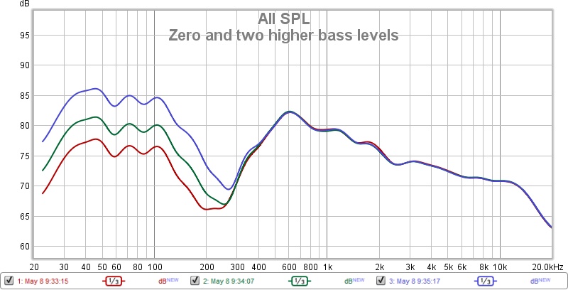

Hi there, i did the easy one here, mid back on its crossover, bass and OB back in line, normal flat and two increased bass levels, clip attached..........
I remain interested to experience a bit more about OB, but unless i can learn how to configure the bass filter in Hypex to take it up to say 300 i feel i am at the limit of the experiment with existing parts only? - even that will leave the mid peak, but would be a bit more

I can increase the woofer level easily as Hypex has gain control on it, i will try that, but it probably will be across the entire bass range?
Meanwhile, measuring mid only is beyond my expertise, do i disconnect the other drivers, and is the amp happy with that (sensitive tube thing?) many thanks, mike
Yes it will be across the entire bass range with a simple level control. More bass is almost always preferable to not enough.
By programming the Hypex you could change the woofer EQ to shape that more but without an ability to EQ the Mid directly I think you are getting towards the end of your options with this as it stands. The dipole peak could be handled in a basic way by using EQ in a media player the dipole roll off would be less successful.

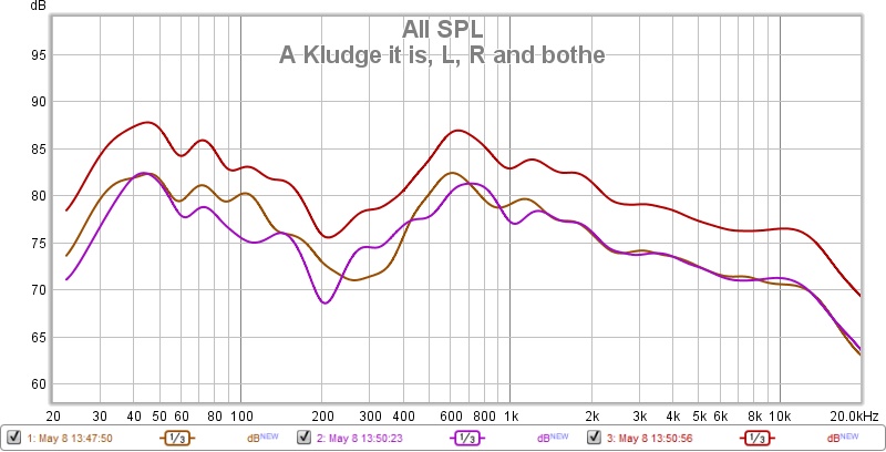

Kludge it is for now, very happy with that description for this! here it is attached with the bass lift and O.O. phase, not sure where the extra e came from, i will do some listening!

Remember you can't boost much in a DSP. You have to lower the rest instead. Boosting too much really don't sound good. It's easily heard with a sine sweep. The lows sound funny with too much boost.
Thanks for that info, i have used about 1/3 what's available and set the levels equal by the REW to match the mid peak with the bass peak, so i have as equal a setting i can easily get

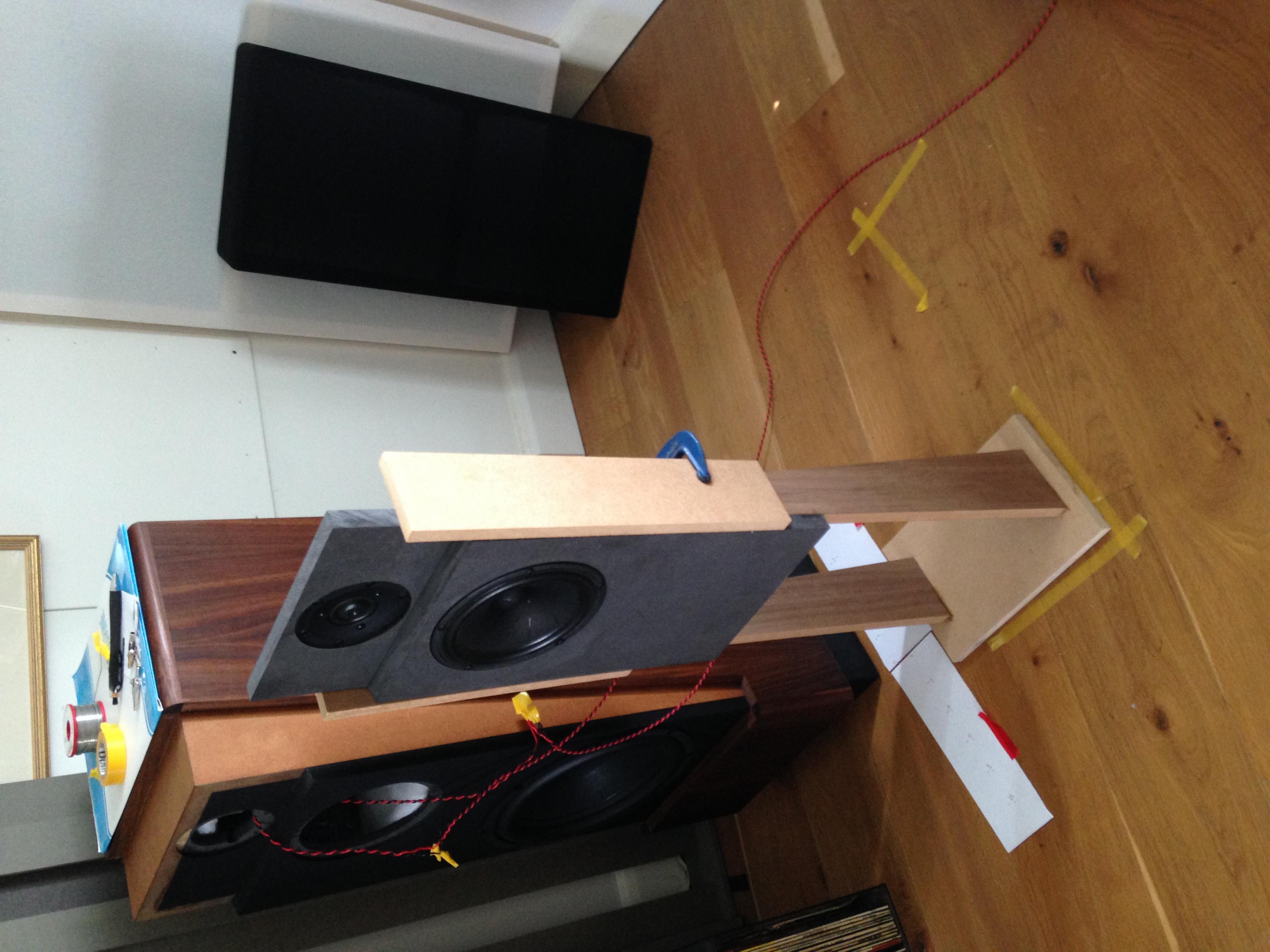

You could try a larger baffle for the midrange, it won't be such a good dipole but it will still be an open baffle 🙂
As chief "cludger", can i just clamp a bit on each side.......or a couple of wings on the back? - any idea what sort of added length makes a difference please?

You can do that or add some pieces to the sides to make more of a U shape. Both of those will change the path length difference from front to back, the wider front baffle will affect the response of the mid differently.

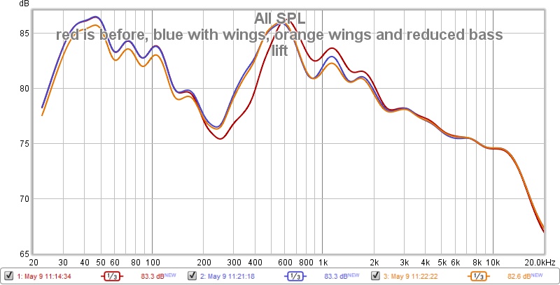

So continuing the Kludge, here is the winged version and three FR traces, before, after with wings, after with wings and reduced bass lift

You have a couple of modes showing in your measurements which could be reduced a little with EQ and might help the bloom, taking the dipole peak out with some EQ ahead of your mid treble amp would likely make a worthwhile improvement.
Seems like an improvement that will make the EQing easier.
