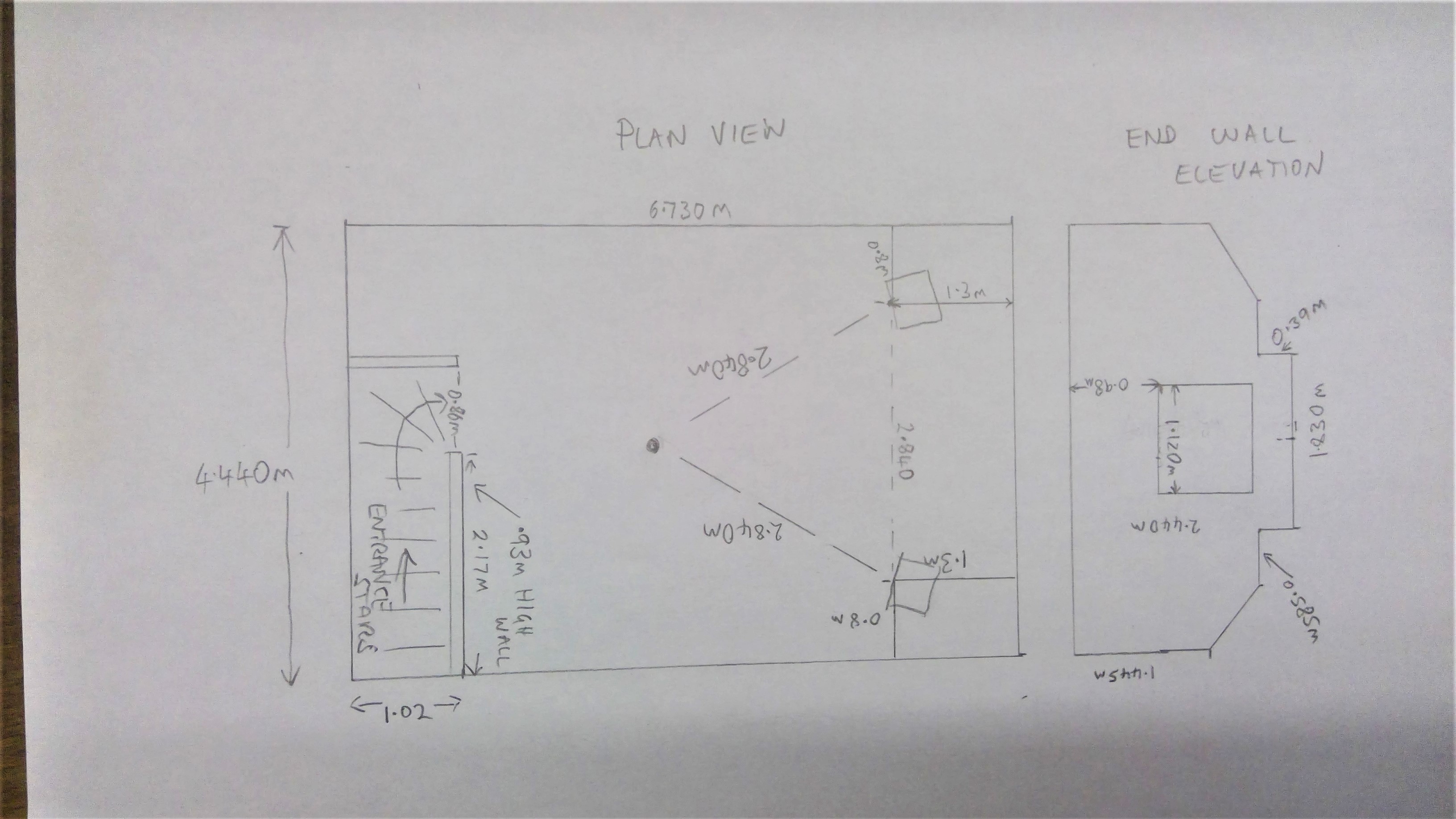

What's your room like and how do you plan to position the speakers and yourself?
I think my room is a pig! - however its the only one i have, i attach a diagram prepared when i was trying to get a better set up and was asking people, i think its now quite reasonable although i have a peak at 600hz to sort still. I will build a slotted absorber on the front of my corner LM panels to try and grab that.
i have a ceiling arrangement set out over the various angles, LM in both front wall corners, broadband on other parts of the front wall, diffusion on side first reflections and the back wall.
Things do get moved around and i also listen from my desk where i am now typing which is just behind the normal listening position.

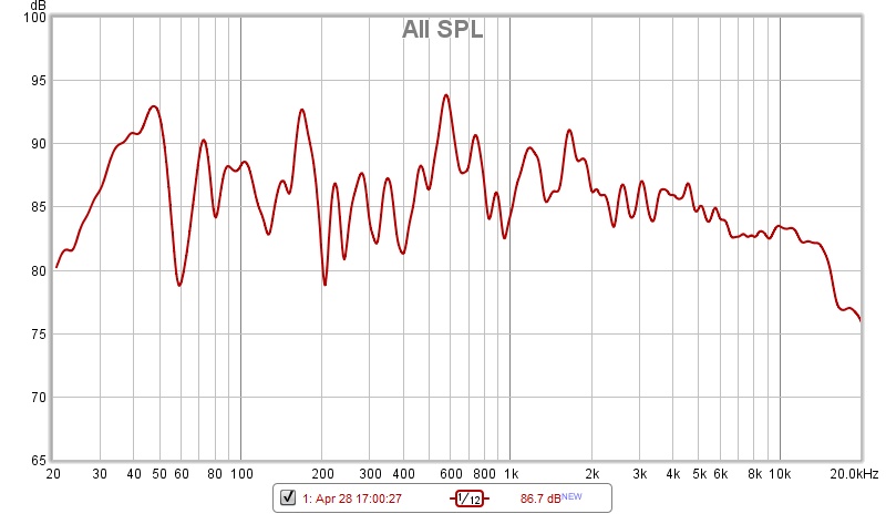

The room is a mess right now but here is a quick sweep i did.

The set up and distances look ok for dipole. The first reflection will be reduced due to the dipole null. Frontwall, I mean the wall behind the speakers, should have diffusion, if any treatment, don't absorb what's coming from the rear of the speaker. Absorption would be best on the backwall, although it's far enough away as that you may not need any.
That will make measurements for sure, how to take them and interpret them is the hard task 🙂I have REW and a UMIK1 so can do the measurements i might need...
You have a few peaks and a number of dips the 60Hz one being due to placement based boundary interaction. REW has a room simulator that is good for working out placement by moving the speakers virtually until you get the best response. Worth a try if you haven't done it. 600Hz is beyond the transition point of most rooms so a defined peak like that is odd. Have you measured the speaker outside or gated inside to see if it is still there?I think my room is a pig! - however its the only one i have, i attach a diagram prepared when i was trying to get a better set up and was asking people, i think its now quite reasonable although i have a peak at 600hz to sort still. I will build a slotted absorber on the front of my corner LM panels to try and grab that.
