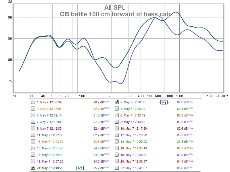

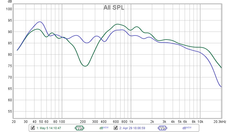

It absolutely amazes me how you guys know all this stuff, and can predict such things, i did do some measurements and there is a big hole in the x over region around 200Hz, i didn't save those, but here is a quick comparison just now, the OB in green, compared with a similar position where i had the Fusions, i can flatten that bass hump on the Fusions, but they are way up the room to achieve it, it sounds better but is not practical

It's the slope below the dipole peak and relates to baffle size. Electro-acoustic models You may be able to mitigate the hole a little by running the mid fullrange.

The dip in your response between mid and woofer could well be in part by the time alignment being off.

A simple test is to move the woofer box forwards and backwards while measuring with pink noise using the RTA of REW set to average and see where you get the best summation. Or just take sweep measurement at different points and see the difference. Once you have established the offset needed you can add that as a delay in the DSP and put the speaker box where you want it to be and adjust the delay accordingly.

I did it in 5cm stages, using one side only, bass cab going further away first and there was gradual improvement, but this was also giving a gradual rise in bass response lower down so i went the other way and moved the OB forward of the bass, up to 100cm was still reducing the dip, by then its become impractical to actually position and live with though

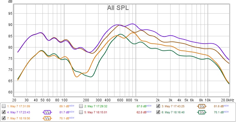

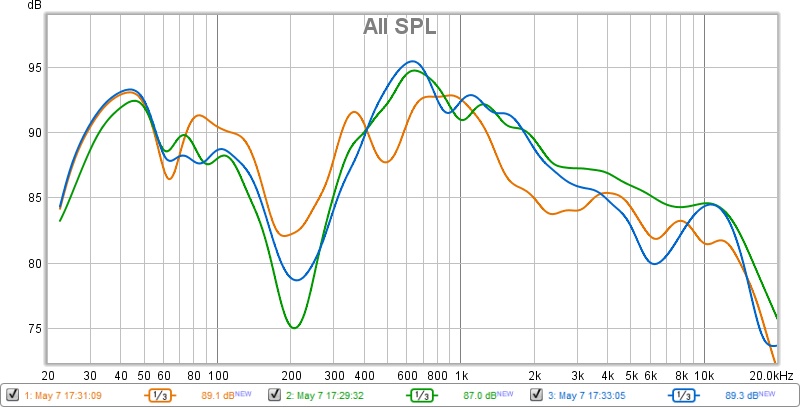

Also, change the position of the mic (higher / lower / closer to / further from the speaker) to see if the shape / depth of the dip changes. I often see a dip in that frequency range due to floor bounce cancellation when measuring in-room. You don't want to wind up chasing your tail over a measurement anomaly.
Thanks all, so a few things to experiment with before cooking dinner, different mic positions attached, yes it can change the depth of the ravine, but the trend is the same, good thought, the best "orange" trace would have been listening lying down height!Mike,

Woofer out of phase = same as moving the baffles apart, was that expected?

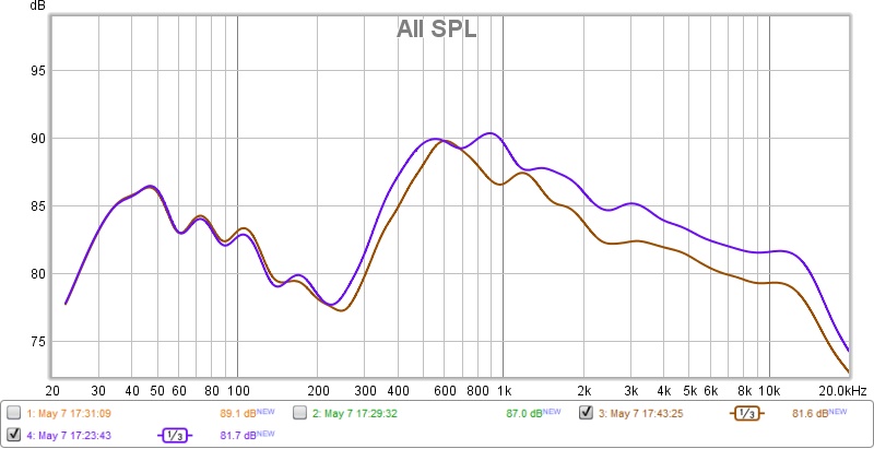

Running the mid range doesn't seem the route, here attached a comparison with the woofer out of phase and the baffles at 1m apart which produced the same improvement, the mid full range was not as good as either of those, whether in line or apart and that improvement has disappeared, its the slope?It's the slope below the dipole peak and relates to baffle size. Electro-acoustic models You may be able to mitigate the hole a little by running the mid fullrange.
It can help to align the phase slopes in the same way as moving or time delay.Woofer out of phase = same as moving the baffles apart, was that expected?
Your measurements show there was some time delay mismatch but you are now left with a dipole peak and dipole roll off to correct for.
Measure the mid only on to see what the response is. Do the same for the woofer.
That will give you an idea of what is needed. Looking at the way the Fusion is setup I don't know if you will have much flexibility for EQ'ing the mid which is what is needed most.
Another simple thing that might help is to increase the woofer level.
