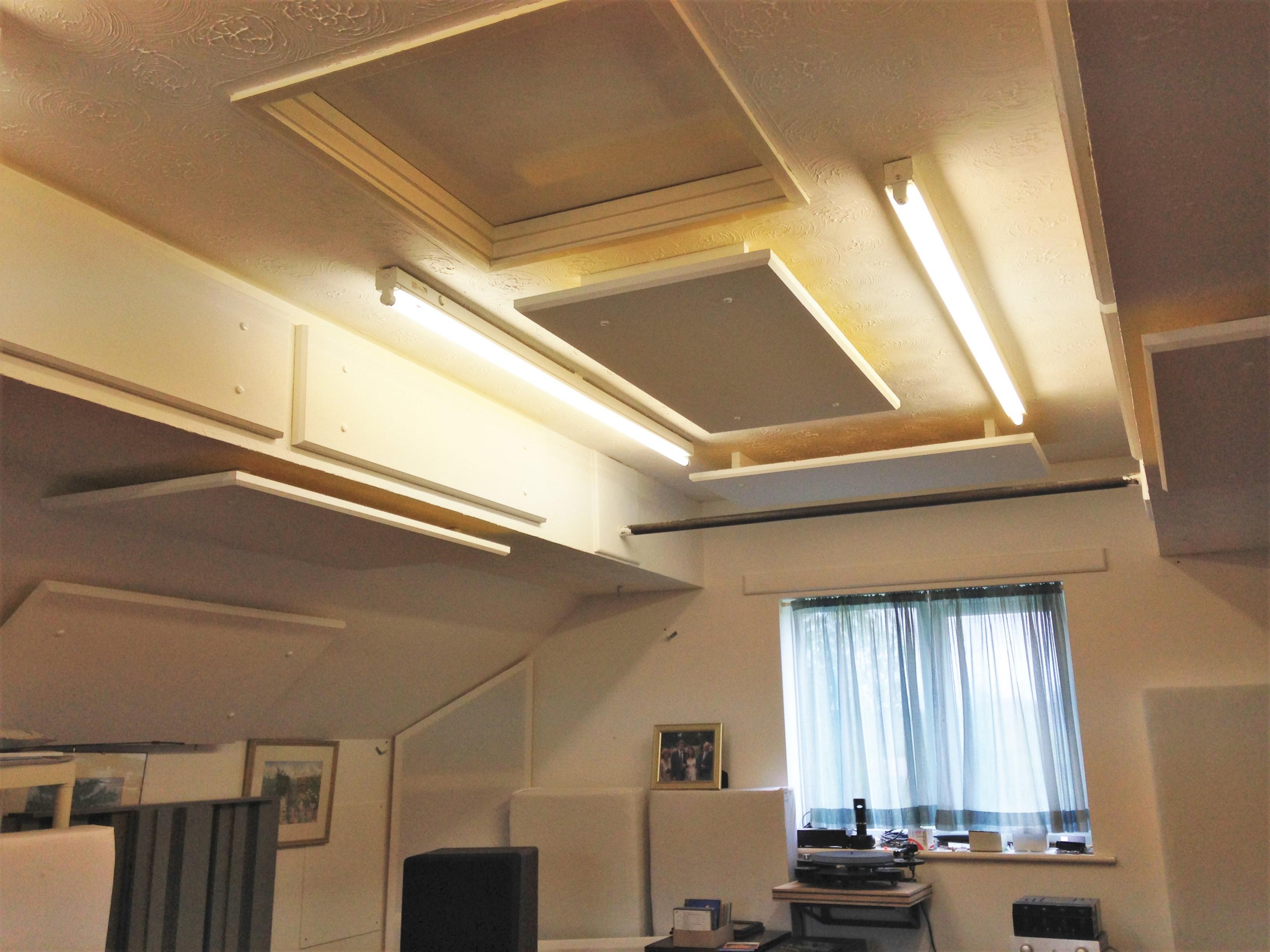

I don't know what your ceiling looks like but if it has different heights try and pick something that is a happy medium. It should still give a reasonable result for low frequencies.i havent found anyway to represent my strange ceiling in a simulator?
I will have a go with that thanks, just to amuse you, pic of ceiling attached, every pic i take reminds me i should clear up and decorate rather than mess around making things........

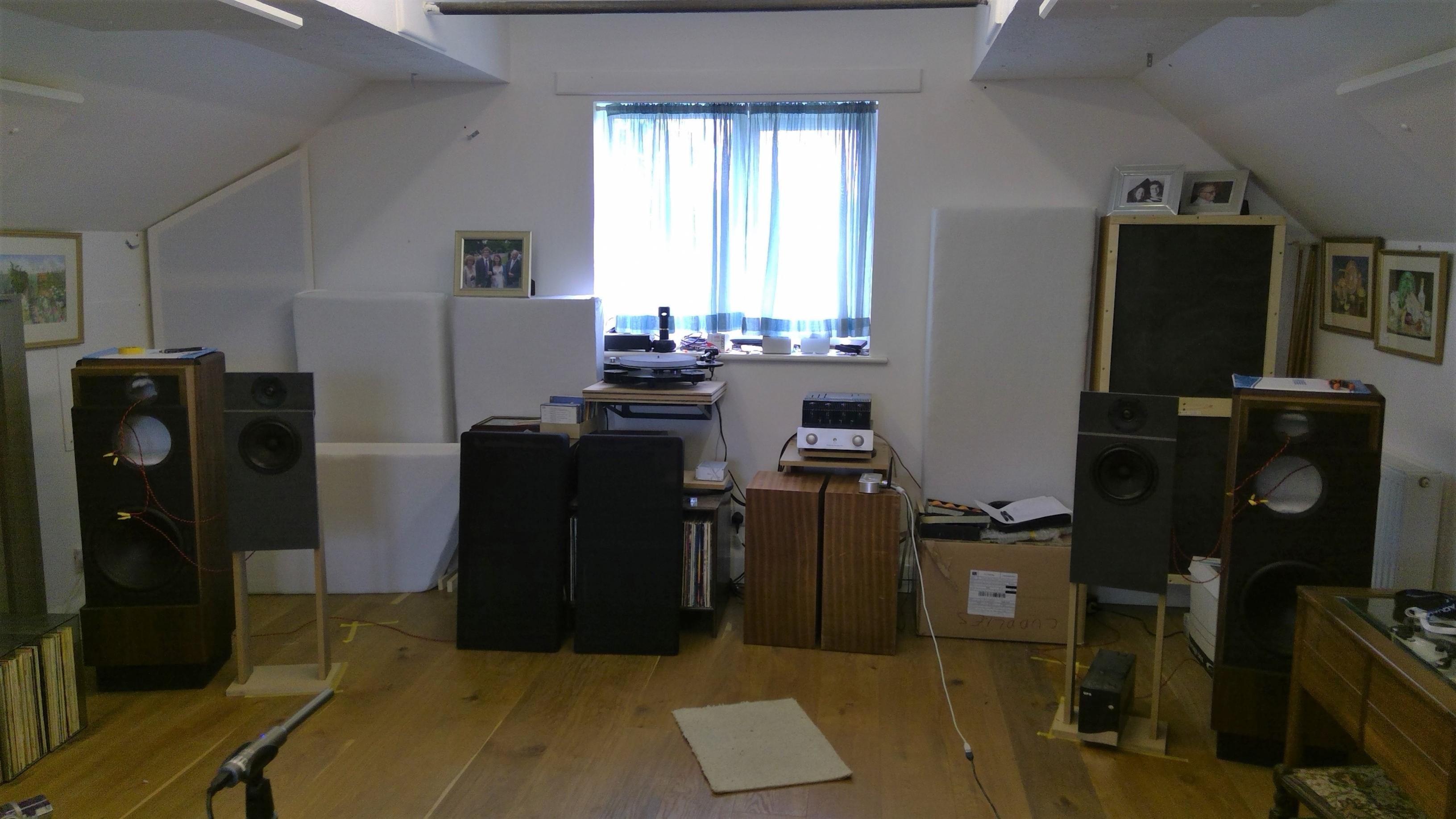

I completed my first OB experiment! - Fusion box bass linked to OB mid treble, all the wiring the same.
Indeed its different, and in some ways nicely so, more open out in the air sound, higher vocals, cymbals more open, the mid treble is more apparent and lighter, which i like, there is some tolerance of imaging moving round the room front to back but only a couple of feet side to side.
The Fusion itself sounds notably smoothly integrated, this, perhaps not surprisingly, does not, either that, or there's more accuracy there now that changes things.......anyway, an interesting first experiment, i will keep listening to it for a while and see if it leads me further down the OB path....
I am unable to discern and describe different aspects of sound as well as lots who post, so i have three different principles alongside each other, monople tweeter, dipole mid perhaps and ported box bass, i cannot attribute any particular sounds to those different areas.
pic attached, bits everywhere in the room but here are my OB panels in place.
Nice tight twisted wires 🙂 You don't want the absorbtion behind the speakers, if that's what those panels are?
Yes that's absorption behind, the corners are limp mass absorbers (one with its white cover, the other without) and they're well fixed, but shouldn't be doing anything other than bass, but the rest (broadband) i will move and try again.
I have been listening a while now and all sorts of percussion is more apparent than it was, it definitely has some appealing aspects.
