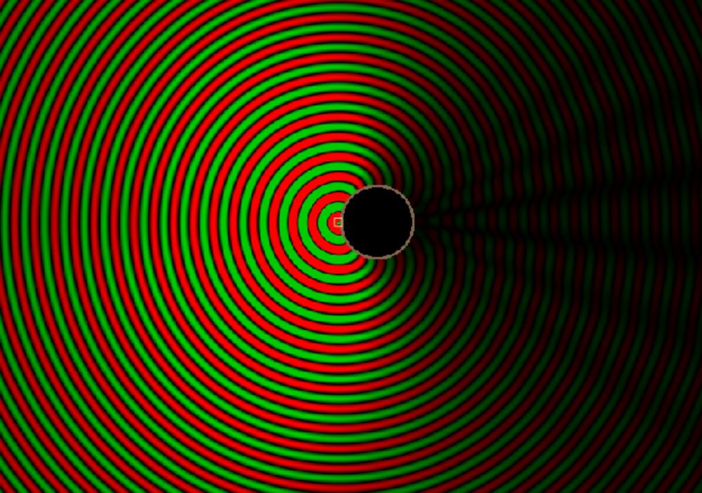

Can you explain this, how diffraction can happen over circle(round body)?There is still interference due to diffraction around the baffle, this can be smoothed by varying the path length.
This is very general case.
But how with speaker bodies?
I found this What Do Roundovers Do? where with sphere speaker body diffraction nearly missing,
The edge diffraction will be missing. This is something where Linkwitz's views on the audibility of baffle edge diffraction seem a little ambiguous to me.
Sound will still travel around the baffle it just won't appear as a separate source at the edge. This diffraction (baffle step if you like) is what causes the interference which creates the dipolar response.
The sphere supports much diffraction but does it in a preferrable way. If you place your head in the speaker position and look out, you cannot see around the curved sides to behind the cabinet. Sound will diffract there.

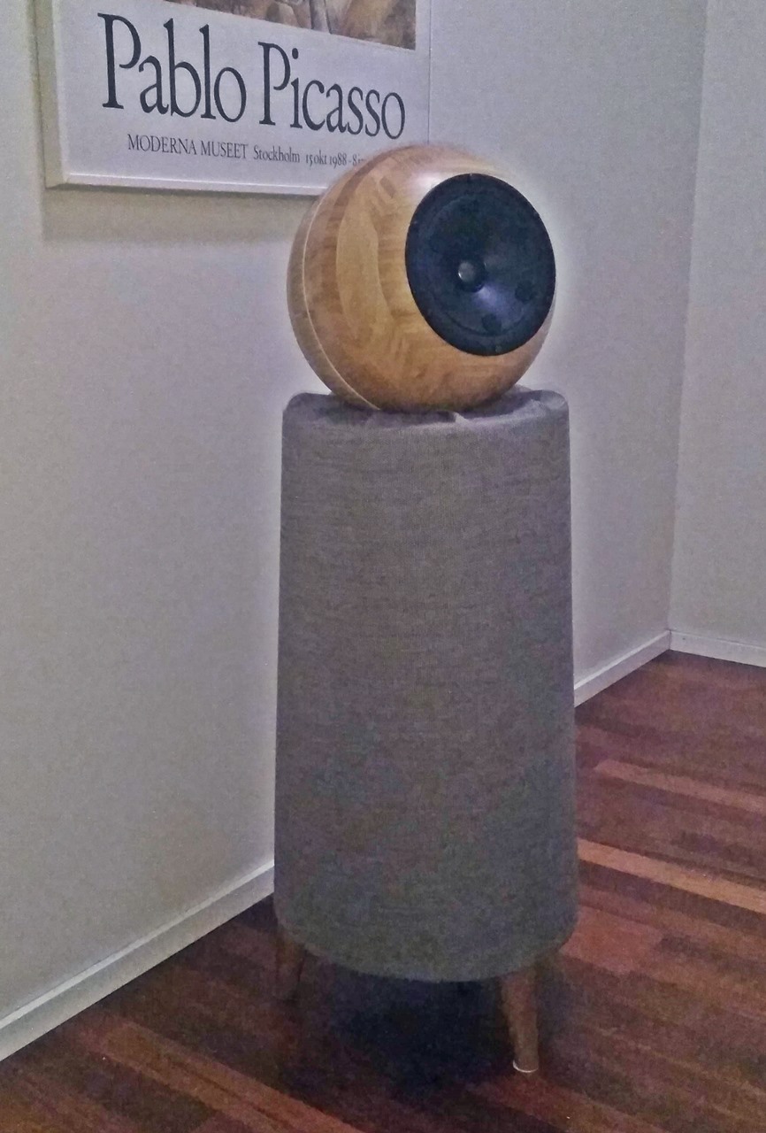

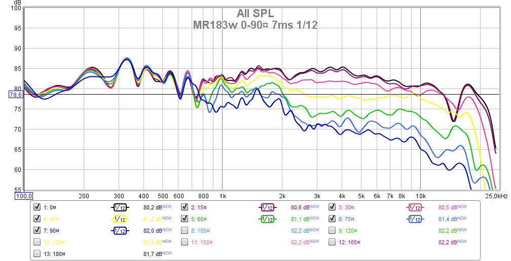

I made ball speakers with SEAS MR18 coaxial and it measures like this (indoor with some reflections) with eq and xo applied: Pretty good, but basically it's frontal radiation is same as a nude driver (ie. no baffle gain)

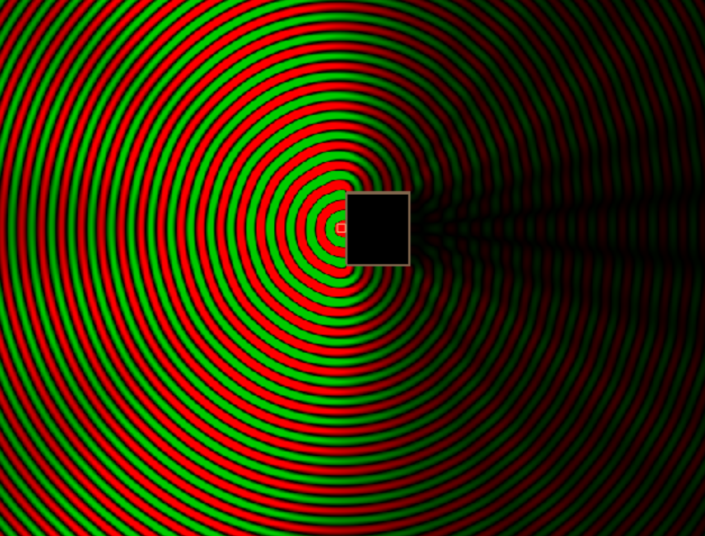

Diffraction must be present at least in Akabak simulation, but it is difficult to separate just radiation and diffracted radiation.
I little look at Ripple tank simulations and find point source there is not actually point, but rectangular and creates diffraction without any obstacle.
