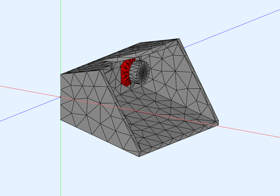

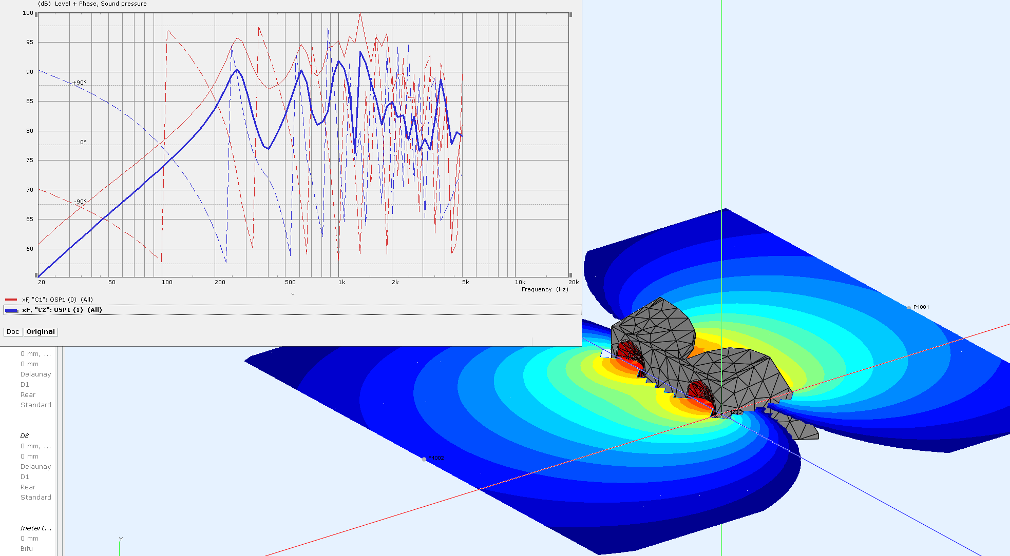

There is only one woofer. Depth of U-frame is 300 mm.
Simulation was fully made on Akabak 3, additionally is added + 6dB per octave rise on lower than 100 Hz frequencies.
On Edge simulation I see that also frequencies lower than first dipole peak had poor directivity. On Akabak simulation directivity below first dipole peak is OK.
For comparison H-frame had excellent directivity. On image is 300+300 mm H-frame, on axis response is equalized .
I had double-triple time checked all parameters, they seem for me correct, or at least they are same for U-frame and H-frame simulations. If U-frame had omni radiation because it is undamped, then H-frame must have also omni radiation frequencies, as it is also undamped on simulation?

Actually, I'd like to see AKABAK sim of a dipole in wide baffle, then in 3 steps when the baffle plate transforms to make first a shallow and then deeper U. Just keep distance from driver's midpoint to edge/above the bend constant. Then we shoud be able to see gradual change in dispersion!
Damping in the U tube is supposed to make the response cardioid, but it can't be calculated I suppose. Kimmosto and Kreskowsky have been there, done that

Two last images on this page shows same result as simulation, undamped U-frame is nearly omnidirectional at first dipole peak.Damping in the U tube is supposed to make the response cardioid, but it can't be calculated I suppose. Kimmosto and Kreskowsky have been there, done that
