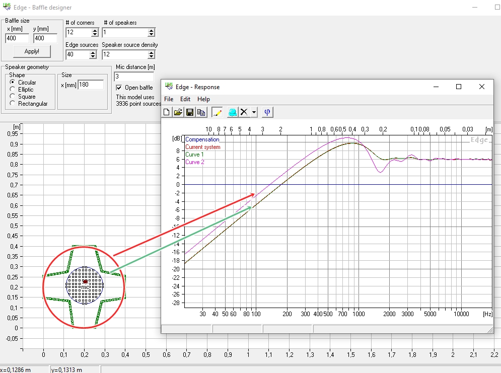

And here is Edge on-asis response of a round vs. wheel dipole. Check off-axis difference too, it was too much a mess to show here as overlays.

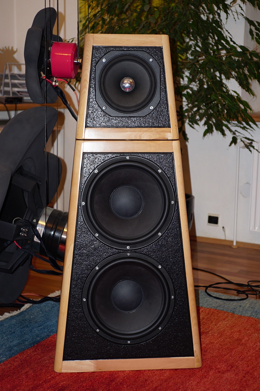

Can you tell what can be idea behind this GR Research NX Otica design Lets see your O.B. speakers....!
As I see midrange baffle is very short on left side, probably not give low enough dipole peak.
One more MTM OB from GR Research https://i1.wp.com/parttimeaudiophile.com/wp-content/uploads/2019/06/ES000318-e1559667571203.jpg
There seems like cutout is partially made because tweeter?

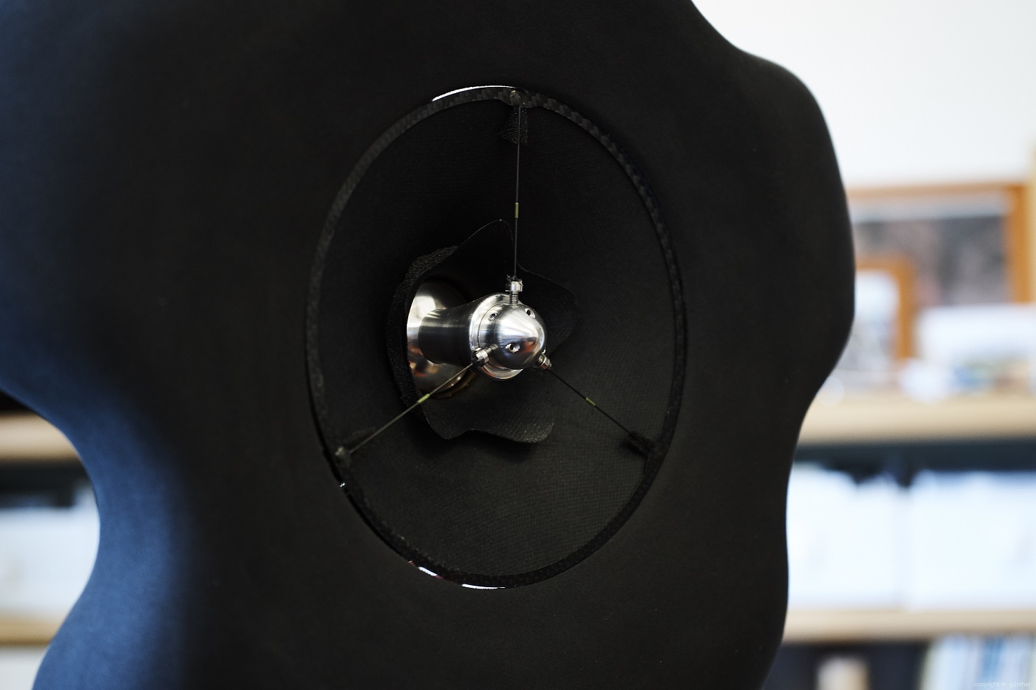

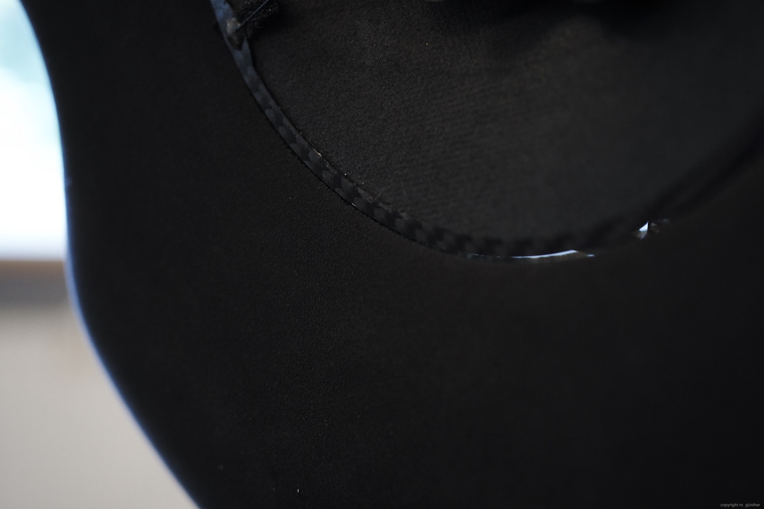

Yes, I have built the flowers, or petal baffles. The intention was not to have a true dipole, as this clearly is not possible with an 8-inch fullrange driver, but to provide an optimal loading for the drivers with a baffle as large as possible (following Rudolf´s suggestions of not having more than 2.5 times pathlength vs. cone diameter) while avoiding any negative baffle effects. Choice of mounting and baffle material of course plays it´s role as well, but the main intention was to provide a clear, diffraction-free "flowing" shape from the central part of the driver to the rolled-off "edges" of the baffles, without any discontinouities especially between cone and baffle.
The flowers have been very time and money cosuming to build, and I have never done it a second time. A good compromise is a trapezoidal baffle with very small wings, which doesn´t perform like the flowers, but is a lot easier to build.
All the best
Mattes
All the best
Mattes
