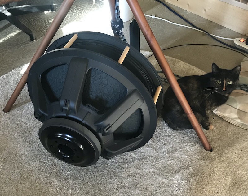

In my own measurements I found that very small separations of about 1" to 2" resulted in an SPL level that was about 3dB less than when the two drivers were separated by about 6" or more. The drivers were arranged face to face, so I am referring to the separation of the two mounting flanges. As you increase separation nulls appear in the response at increasingly lower frequency but the low frequency SPL is not changing. This tells me that you should use some minimum separation and that seemed to be about 4" to 6" in my case.
This have been my experience too. I know I should not talk without showing measurements and I honestly tried to find them but with no success.
This was years ago when I did a lot of experiments for my first steps into OB, I focused on nude speakers for the look/simplicity/and ease on testing.
And I ended up with UM-15s in open-clamshell (for lack of better words), after maybe 20 sets.
The best response was with the width of my hand between them, a little more or less didn't change anything, but closer or too open did.
Also too much width would start to blur the sound if crossed higher. This could be fixed with dedicated dsp channels but I never tried (also there might be something to do here, to steer the sound to the front).
Now I don’t know what is really going on, even after reading on SL's analysis as it’s not exactly the same setup.
This configuration was sure better than two drivers stacked in vertical (always nude), in measurements and to my ears.
So maybe it’s just the floor coupling that is doubled.
But there might be something else in the side areas, like an expanded width of the null that has a bigger dipole effect.
Plus I really like:
  • the compactness, allowing to move them around, closer to me, or change the axes of the nulls.
  • the minimal visual clutter, especially since I used a tripod for the high section, they fit in.
  • the ease of the build, well no more build
  • the look, really love it, especially with the two ultimax it looked like some sort of energy pump/engine.
It was suprising to not see them moving/vibrating even with big excursions, they were very heavy compared to the cones mass.
I didn't suspend them but had some sorbothane bricks below at first, after a while the driver edges cut them to pieces so I just removed them.
Unless I went at very very high spl they were fine without any kind of suspension, but I had thick carpet below.
I also played with some curved wood covers and it looked even better, to my eyes.
Didn't have any effect on sound if not crossed too high. But yeah they would dance at insane spl.
Found a pic:

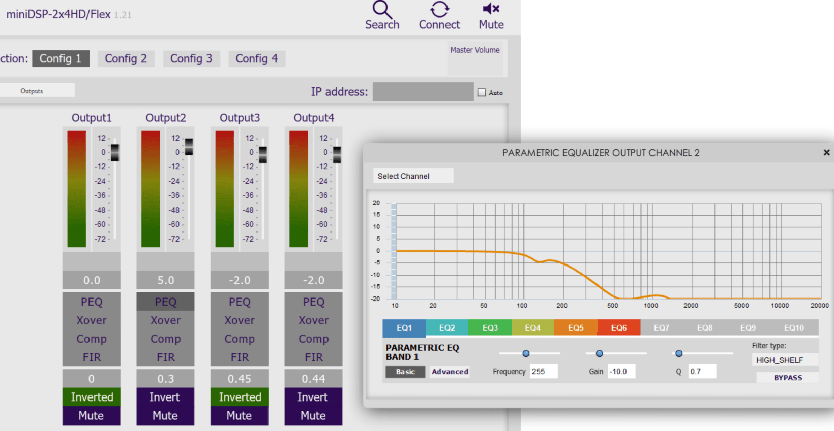

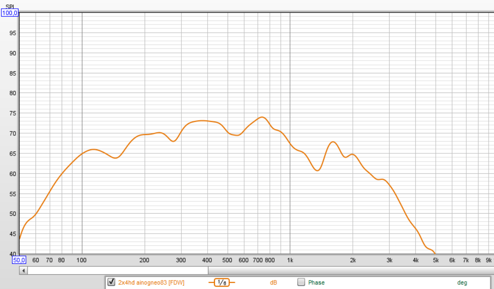

I use a 12" nude driver as lower mid, LR2 at 150 and 900Hz (varies with version) Here you can see the eq needed for straight response 100-2kHz, and on-axis response wth xo at 1m indoors. This response shows dipole effect. Below 150Hz I use monopole woofer, SEAS L26LROY per side, so each speaker is 4-way.
