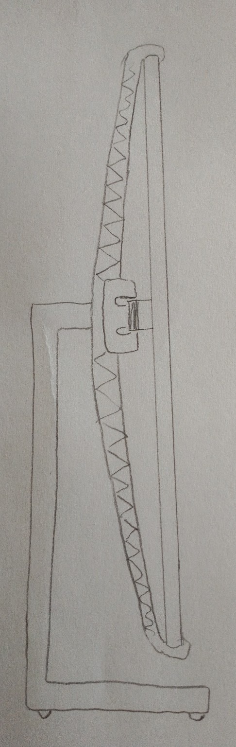

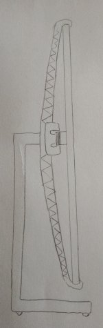

Not exactly. I was thinking of doing it without gearing. So the available torque directly twists the fin. Even the bearing for the central axle would ideally be magnetic to avoid frictional glitches when changing direction. Maybe that could also be avoided with a kind-of spider with rotational freedom. It's all open.
Maybe I'm off the mark here, because it seems like the torque would have to be a lot higher than for a typical woofer. But this should be a good thing. Multiply the surface area by 10x, and estimate the swept volume, and adjust the motor size to suit. A cone shape with a compound curve is a much stronger shape than a flat wing, but maybe it doesn't need to be flat? Some kind of sandwich with a light-weight foam between some strong fibres?

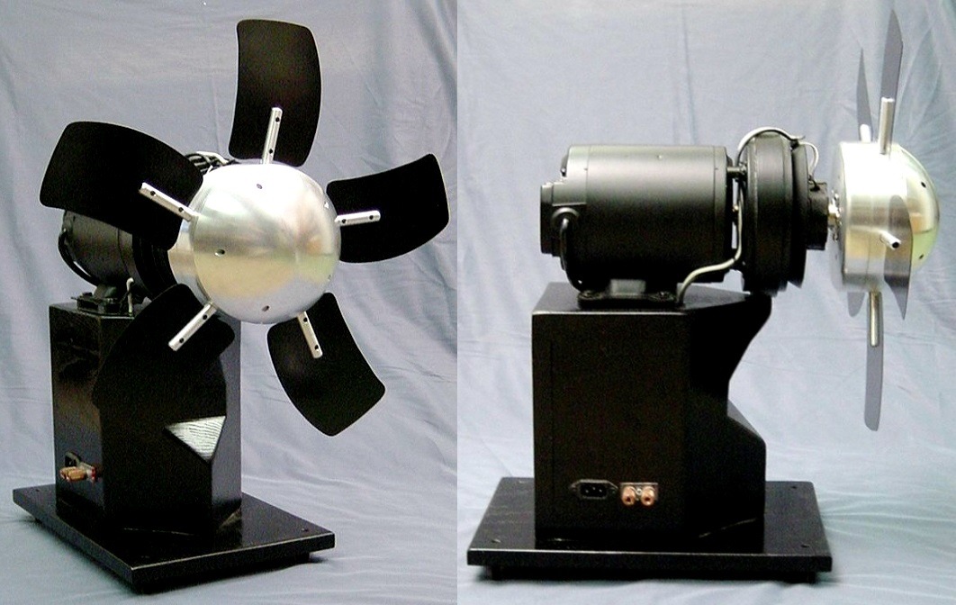

The Eminent Technology TRW-17 is in the market since long ago. Not sure if this is exactly what you propose. I do not remember now but I think the blades not only rotare they change angle too.Not exactly. I was thinking of doing it without gearing. So the available torque directly twists the fin. Even the bearing for the central axle would ideally be magnetic to avoid frictional glitches when changing direction. Maybe that could also be avoided with a kind-of spider with rotational freedom. It's all open.
The rotating fan picture reminds me of a "helicopter" technique I'd heard of. Apparently, if coupled with room-sized enclosures / infinite baffles, it was capable of ridiculously powerful 1Hz - 40Hz bass. But what I had in mind was more like a fin flapping on a stationary hinge, like an aileron fin.
If the displacement is too big, I think overcoming wind noise at the 'dipole' edge could be a factor.
Another, more conventional route without re-inventing the wheel ( / motor) so much, could be to retrofit a woofer. E.g.: taking the magnet and voice coil from a conventional woofer and replacing everything else with something like a BIG styrofoam + fibre sandwich dish. It would be a bit like an actuator, except that the magnet scaffolding would be extended all the way out to the edge of the sandwich.

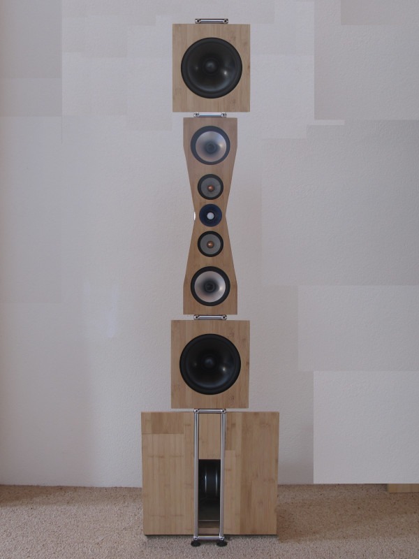

Yes Vic has tried loads of drivers etc, but the one thing that he has remained extremely happy with throughout is the 18” woofers in clamshell arrangement. I know someone who has heard that system and he said it is the best bass he has ever heard, FWIW.Based on the sheer number of systems shown, this person seems to make a new speaker every couple of weeks. Lots of enthusiasm. Many of his designs include some serious flaws. You can tell just by looking at them, what drivers are used, how large the drivers are, etc. You can't escape physics.
Also, very very light on measurements (essentially none) and I did not see much details in terms of crossover design, etc. Anyone can slap together some drivers in whatever configuration and use some DSP to "make it work" by using their ear (the worst way to design any type of loudspeaker except a simple fullranger). It's a recipe for what you see here, never satisfied and continually trying something new.
Although a couple of the systems with nude drivers on a "stick" above a compound dipole woofer setup have some merit I see little mention of how the crossovers were designed and implemented. Oh, I see now, this quote kind of sums it up:
Guy seemingly has no clue how to do anything properly. It's just random stuff that he tries based on whatever...
This should serve more as an example of how NOT to design and build speakers!

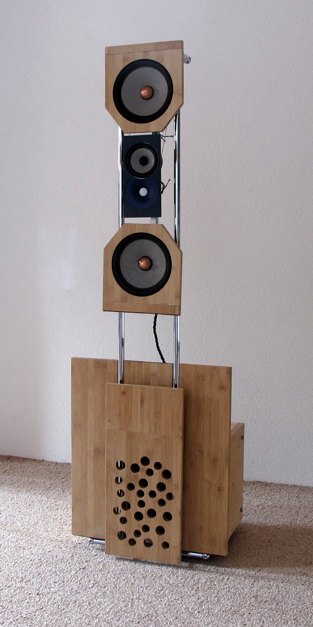

It might look indeed beautiful /tech-neardy with the decent charm of a naked bike or a steampunk object. Optically speakin, also I like it. But sorry. I am rather the FFF guy - form follows function. From the acoustic point of view, such a configuration (partially) cancels the 2nd harmonic distortion. However, this goal can be better attained from an acoustically/technically/economically point of view. Late Siegfried Linkwitz showed how, such as e.g. in the LS LX521. Therefore in my oppinion, such a clamshell config is (nearly nothing but) a 50% waste of ressources. But never mind. If it looks good .... The show must go on, they say ... Really? Remerber also late Marcel Dassault: "Un bel avion est un avion qui vole bien". So sorry, clamshell design. Ce n'est pas vraiement beau.... 18” woofers in clamshell arrangement ...
Wow !!!I know someone who has heard that system and he said it is the best bass he has ever heard.

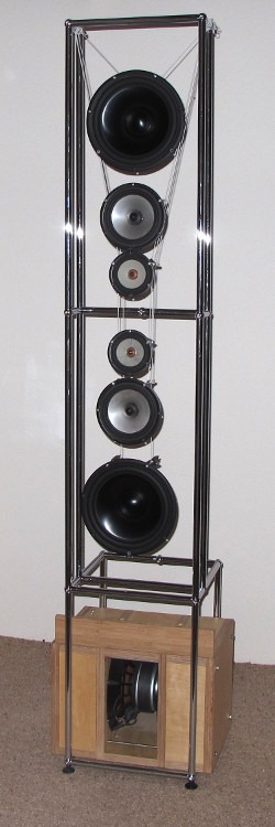

I don’t think anyone would argue that it is the most efficient way of using 2 woofers. There are other factors to consider though:
1. If you are limited for space then it’s a way of increasing your effective output / decreasing excursion per driver without taking up much more width or height.
2. There may well be a reduction in distortion as a result of the drivers being suspended and not fixed to a baffle.
Everything is a compromise in this hobby; you pick the ones that you think will work best for you.

Cool 🤩I managed no more than 105 dB @ 20 Hz with less than 10% THD on my giant H-baffle towers, that had sixteen 21" woofers.... so ... unless you are willing to go completely mad, just forget it.
No. It's not the way this works in OB. You may roam around at linkwitzlab.com for an extended understanding.1. ... a way of increasing your effective output / decreasing excursion per driver ...
To be fair in your favor: Hummm ... maybe, if you mean these (non-harmonic) distortions due to erratic baffle modes if the baffle is ill-conceived and prone to heavy resonances. You will stimulate them less if you hang yor driver into or onto a baffle instead of fixing them to it. But even then, take care: The baffle will show less total mass also. Less by the driver's mass. And surprisingly enough you will completely avoid these distortion products if there is no baffle at all.2. There may well be a reduction in distortion as a result of the drivers being suspended and not fixed to a baffle.
As for the robust principle of reducing 2nd harmonics in bass reproduction I was referring to, this principle has nothing to do with suspending or fixing a driver to a baffel or into nothing. It's the cancelling mechanism that the drivers dynamic nonlinearities are partially cancelled if they work in antiphase mode.
